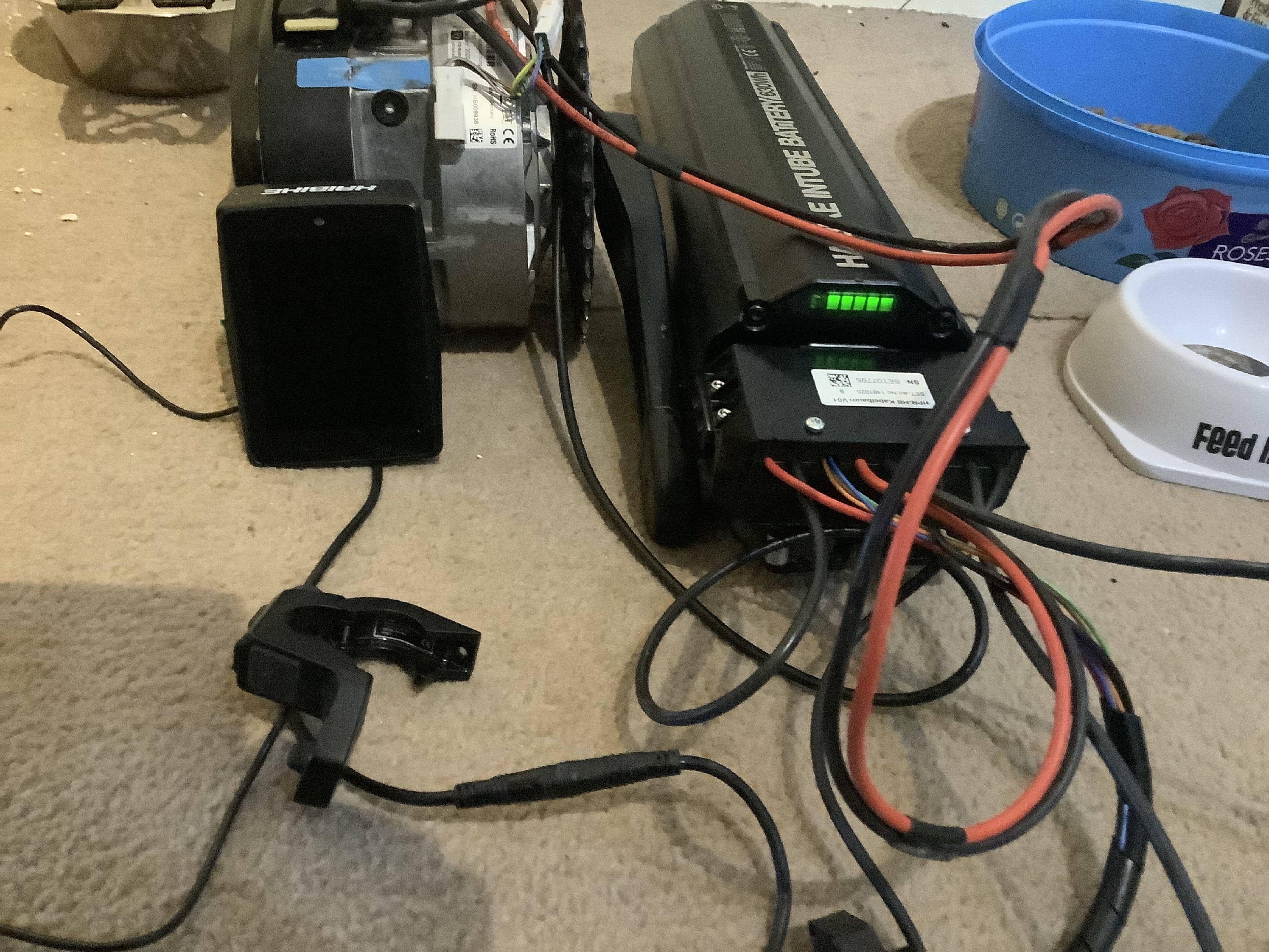

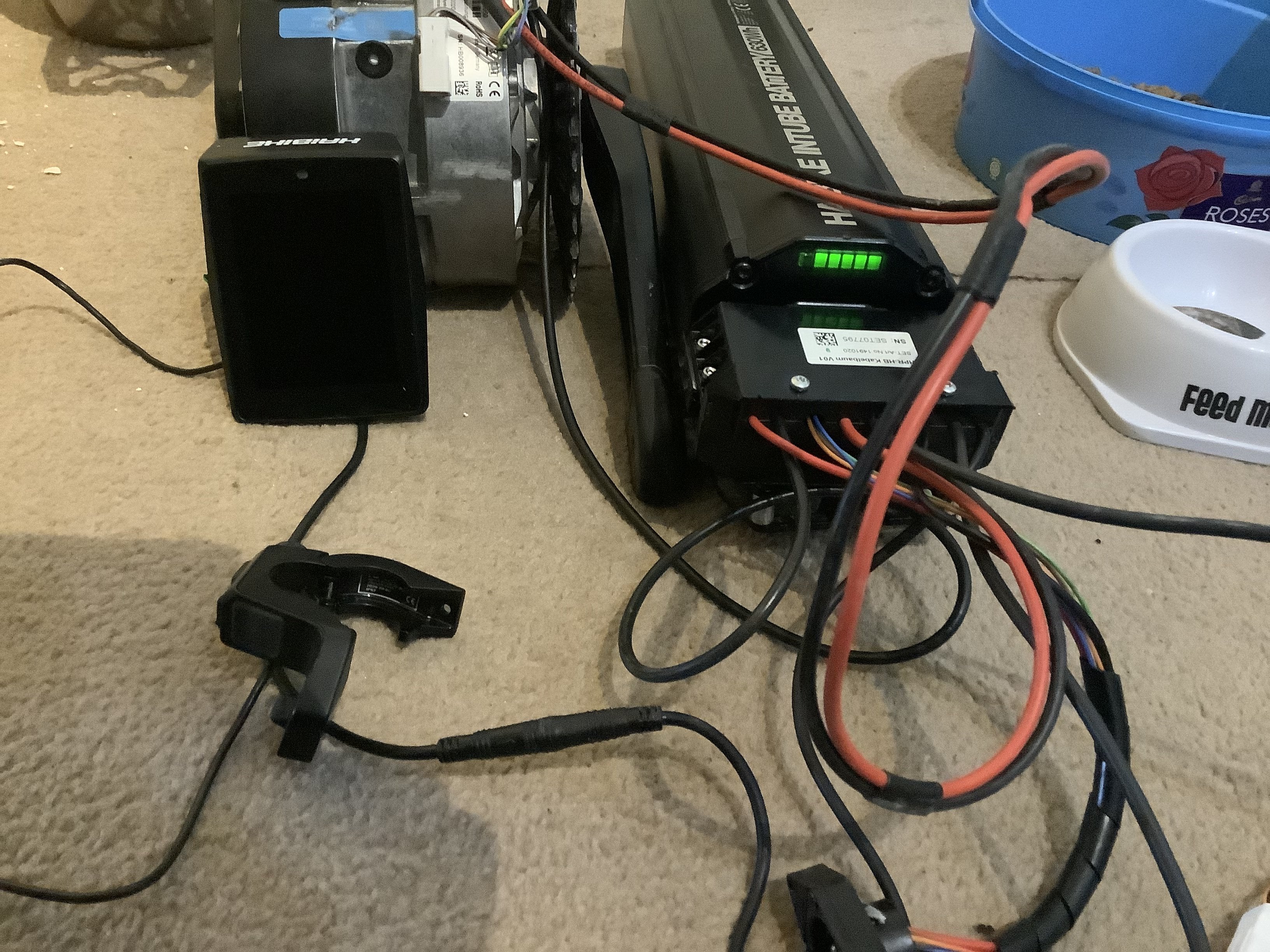

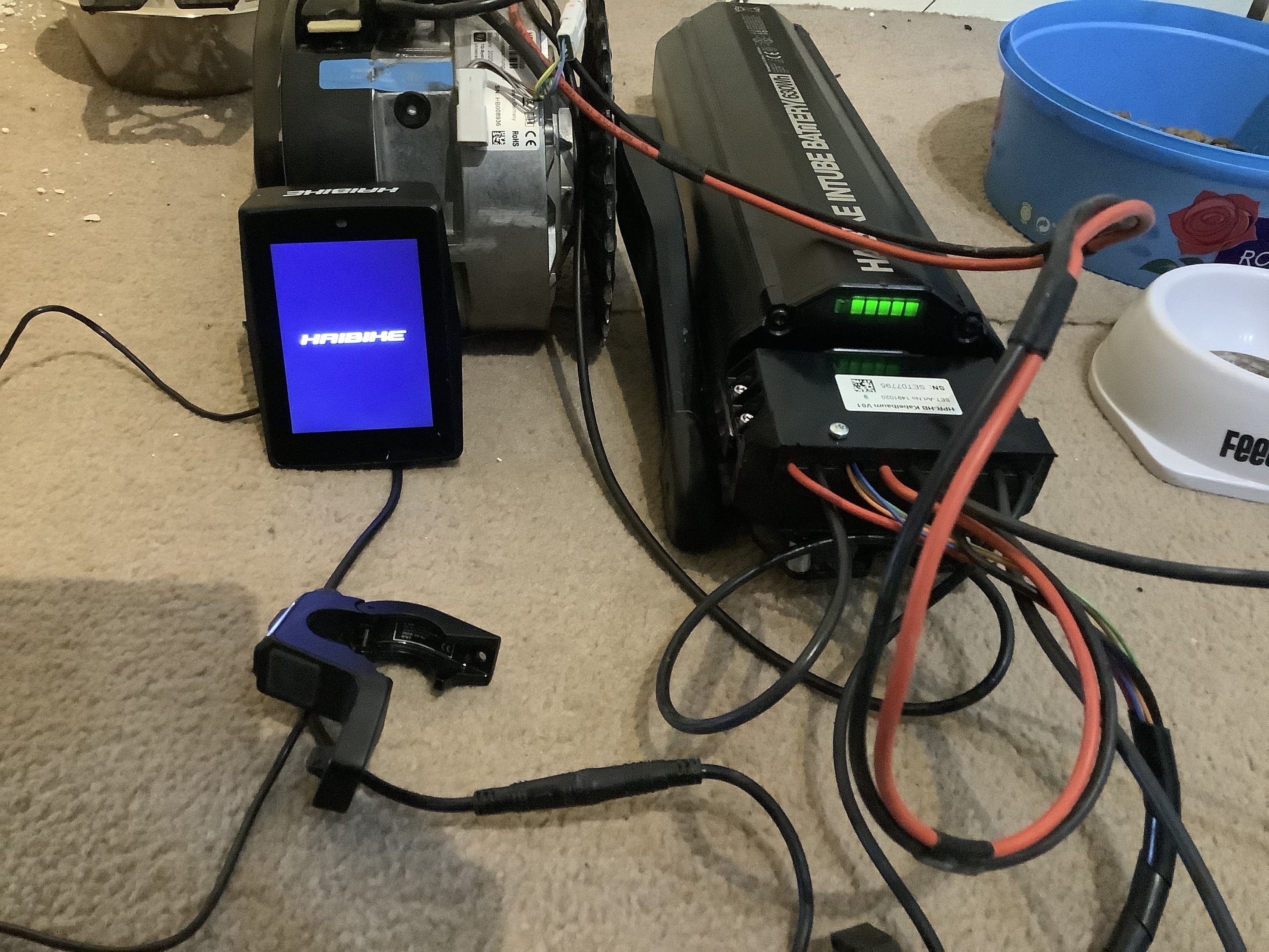

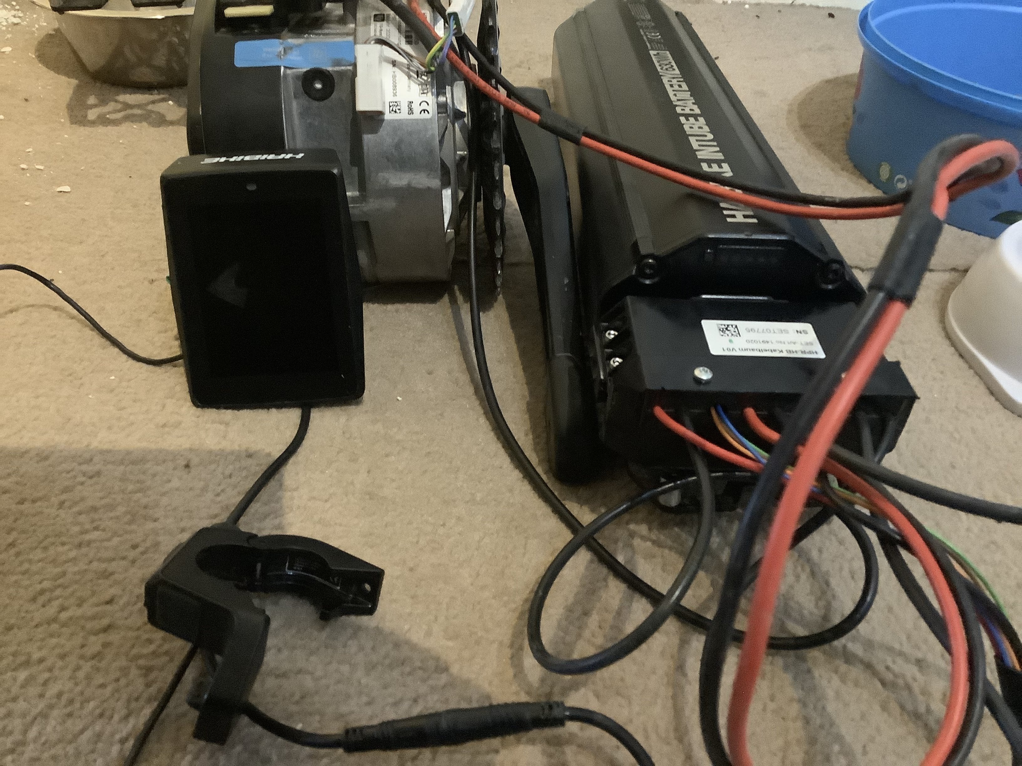

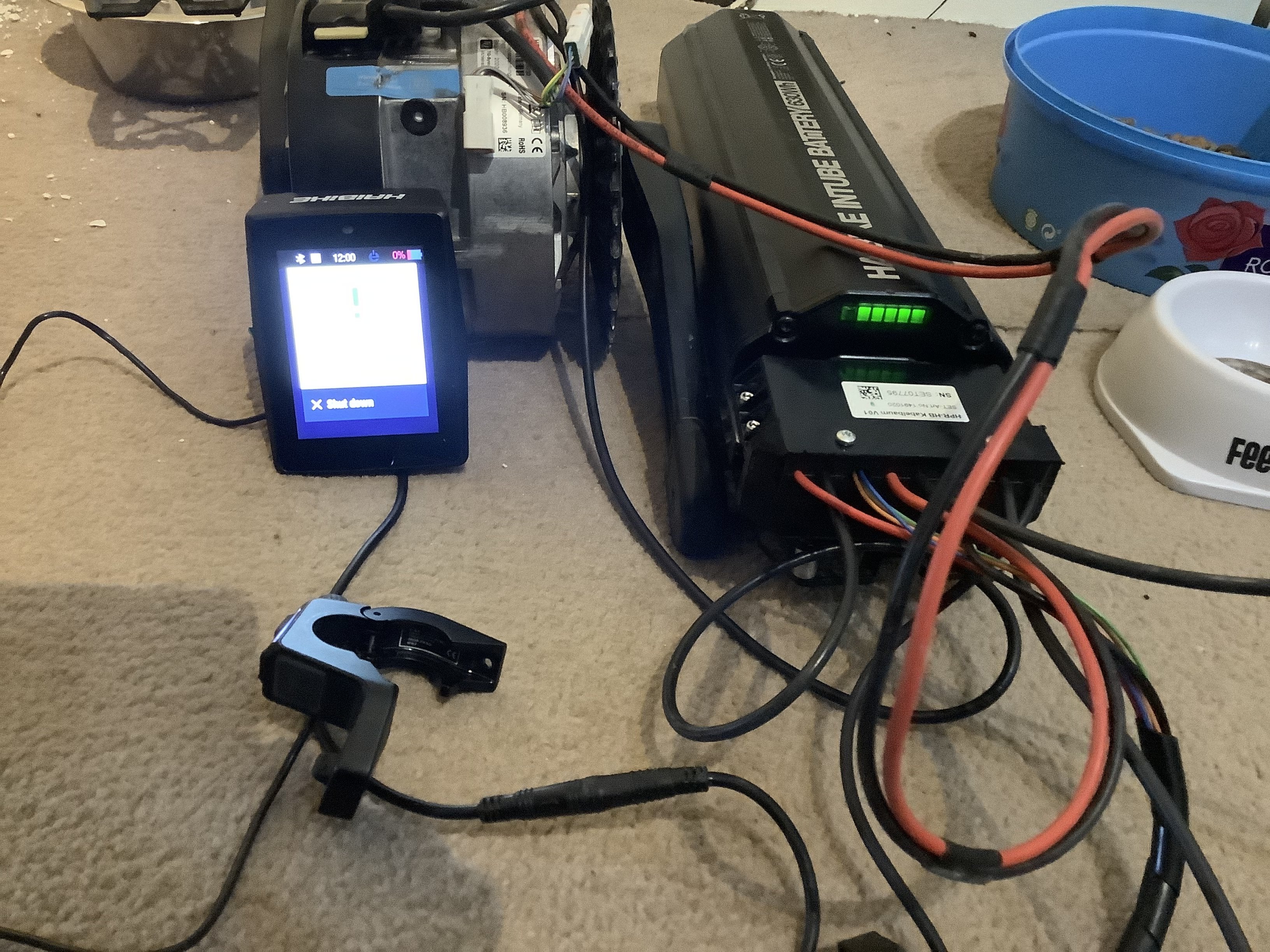

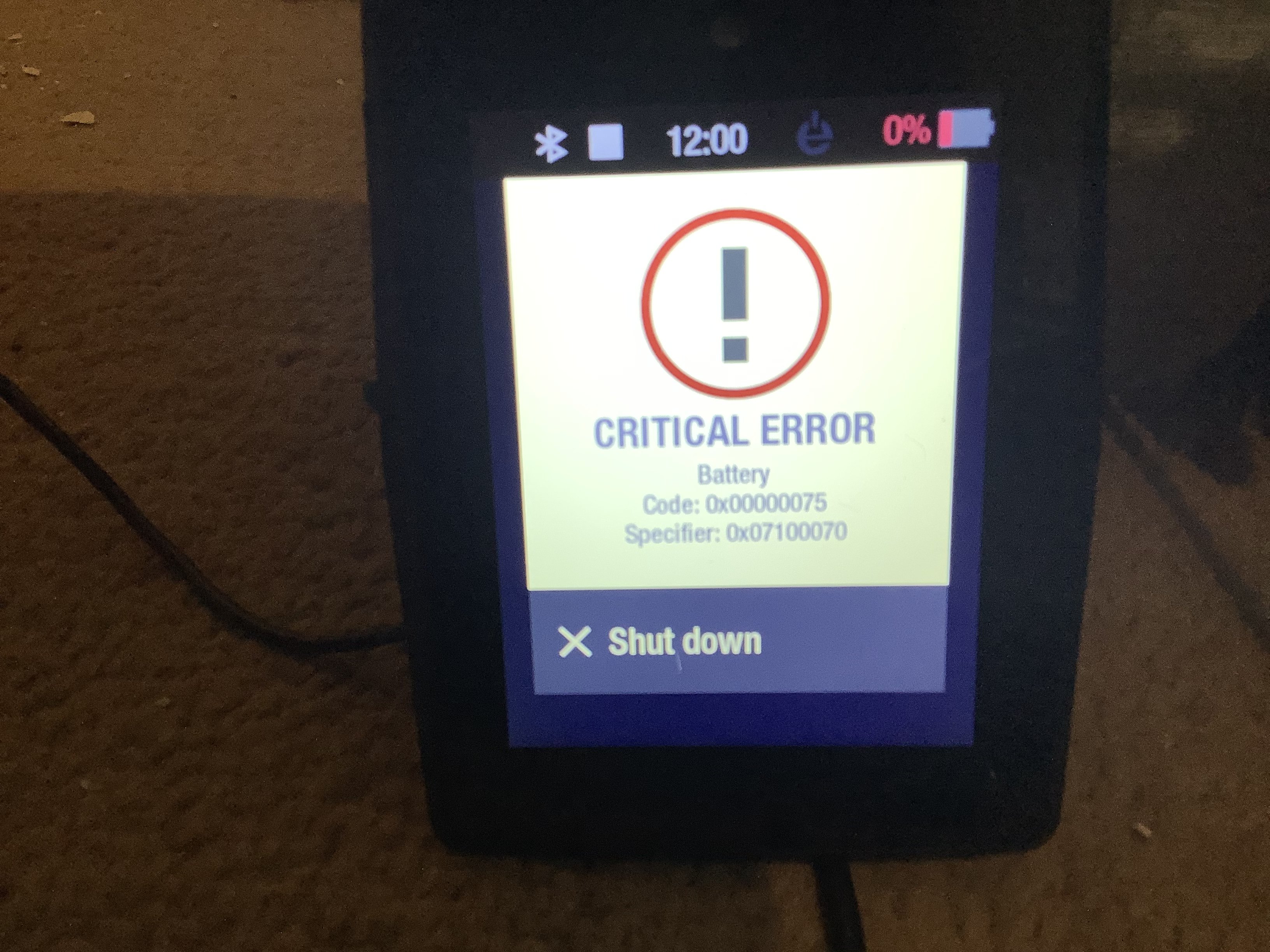

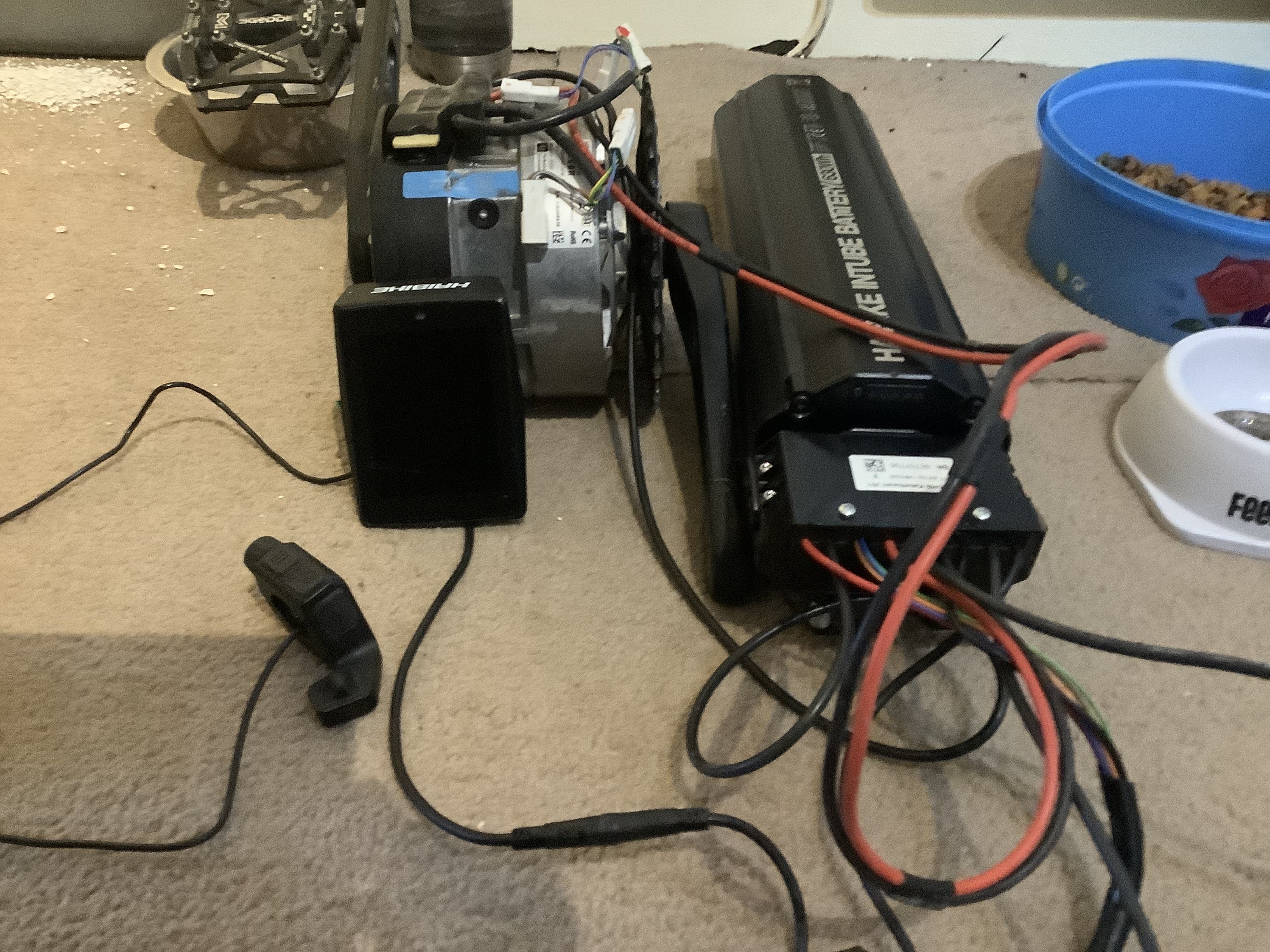

Stripped the bike ,all wires are ok ,switches on ,go’s error switches off
3A4B6B0E-8190-4416-BE1F-668F8AA881B3.jpeg 0894CAE8-CEA4-4C67-8C32-6C98253A2044.jpeg E6FDAA39-764F-45A6-8493-D007591C84BB.jpeg 0904FBCF-3148-4250-B52C-46FDBC5B7F64.jpeg 2A25DA3F-1E69-4D57-A015-2BAD26AD3021.jpeg 385E211F-58A0-4A5A-80E6-3EF30F78BDE5.jpeg 4C3CE90F-3B6D-4A94-A621-267A29DEA707.jpeg

So if i got a similar battery 48 volt 360 wh as my flyon did a bit of wiring magic do you guys think there might be any problems ,or would it go bang lolololo
Cobra75007
Oct 5, 2023
14
Denver, CO, USA
I'd be interested to see. I think you must have the volts the same across the two batteries, and our are 50.8v, which i imagine is not easy to find, although i have not looked for a second or smaller Wh battery. But im interested in what you are trying to do. i'm considering trying to build something too.
