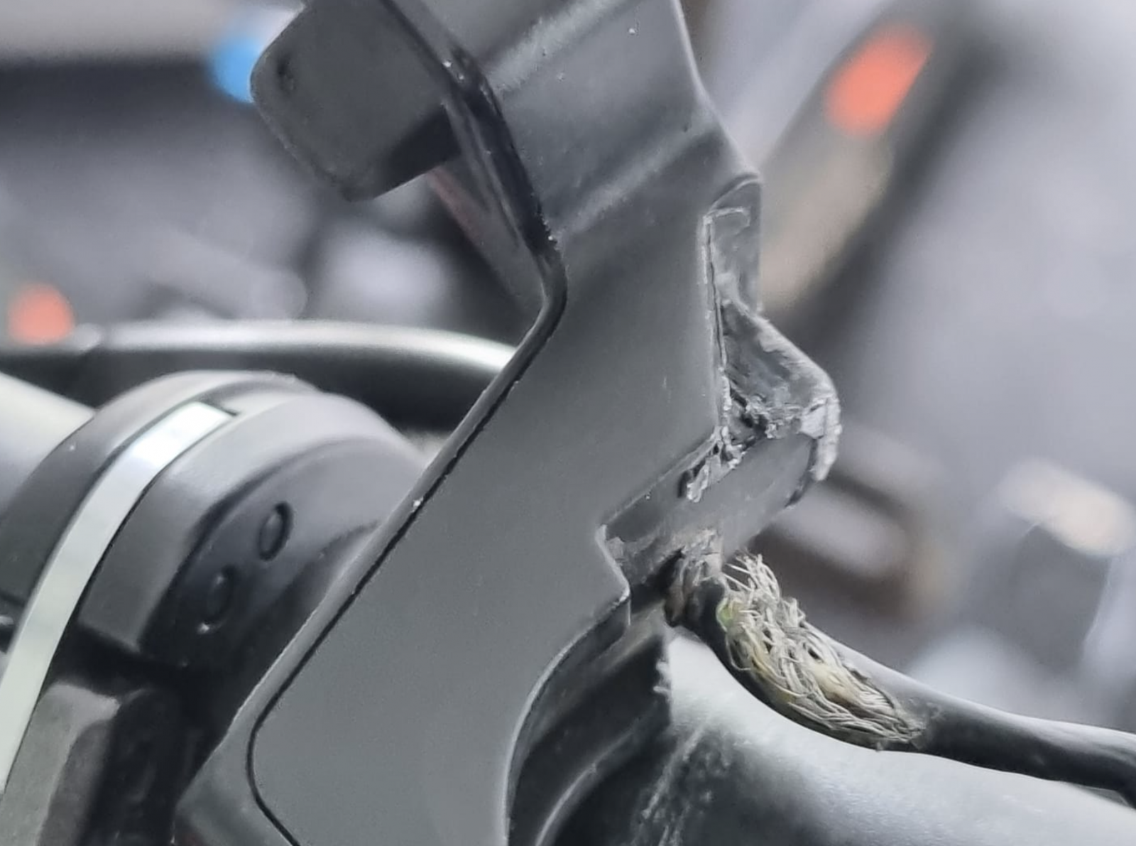

Can someone please tell me where you got a replacement from? I cannot find spares anywhere and Haibike won't get back to me.
I cannot gear down from Extreme > High > Mid > Low > Eco..
After checking the display wires they were fine. Then i took off the controller and have seen the cable is frayed. (see photos)
Would really appreciate if someone has a spare they want to sell or has a contact that has stock of the controller in the UK or to ship to the UK
Thanks
Thanks
I take it you’ve tried all the uk dealerships?
They are the one weak point on the bike. I’ve been through 4 on two bikes.
I always keep a spare in stock. If I can get one from my usual source I’ll happily let you have one.
PM me.

You can get them open. There is a small pcb inside so there is a chance, if you’re good with a soldering iron, you might be able to repair it. ? They split along this joint.
PM me.
Yeah tried so many dealers already.
E-BIKESHOP.CO.UK has them but you have to prove you bought the bike from them to be able to buy the part, which I didnt! So silly. Will drop you a PM. Thanks 😊
Jun 20, 2022
Uk
Update. I contacted Ebike24 and they created a custom invoice for me and a payment link and had all the parts i needed in stock. Delivery to the UK took 1 week. Their customer service is amazing and my parts arrived today. Really happy with their service. You have to spend a minimum of 200euros for them to ship to the UK but it was well worth it. I just ordered a few extra bits i couldnt find in the UK too.
