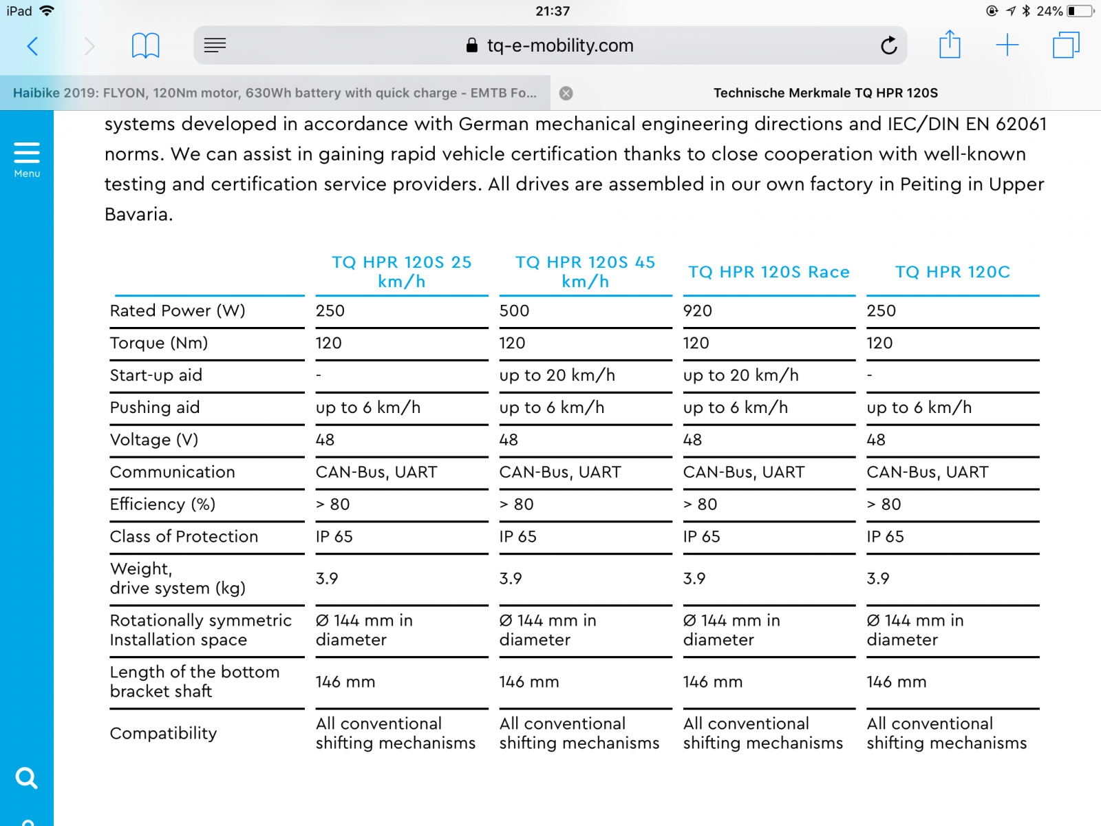

The motor is actually capable of more than 120Nm but in their (TQ's) extensive tests anything more than this is too much.
I'm not sure this is a motor I want. The increased power doesn't seem necessary, and I'm hoping to see more lightweight bikes for 2019, not heavier. Did Haibike make a bad decision when they started on this motor in 2015, thinking more power is better? That was sort of the idea back then, wasn't it?
Nm is a strange measurement. Both 70Nm and 120Nm motors are 250W nom :)
