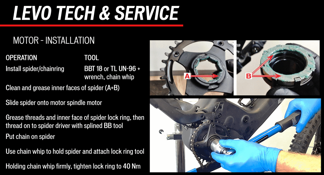

Here is an extract from 2019 Levo workshop manual. It sounds like the design hasn't changed so this would also apply to earlier year models.
