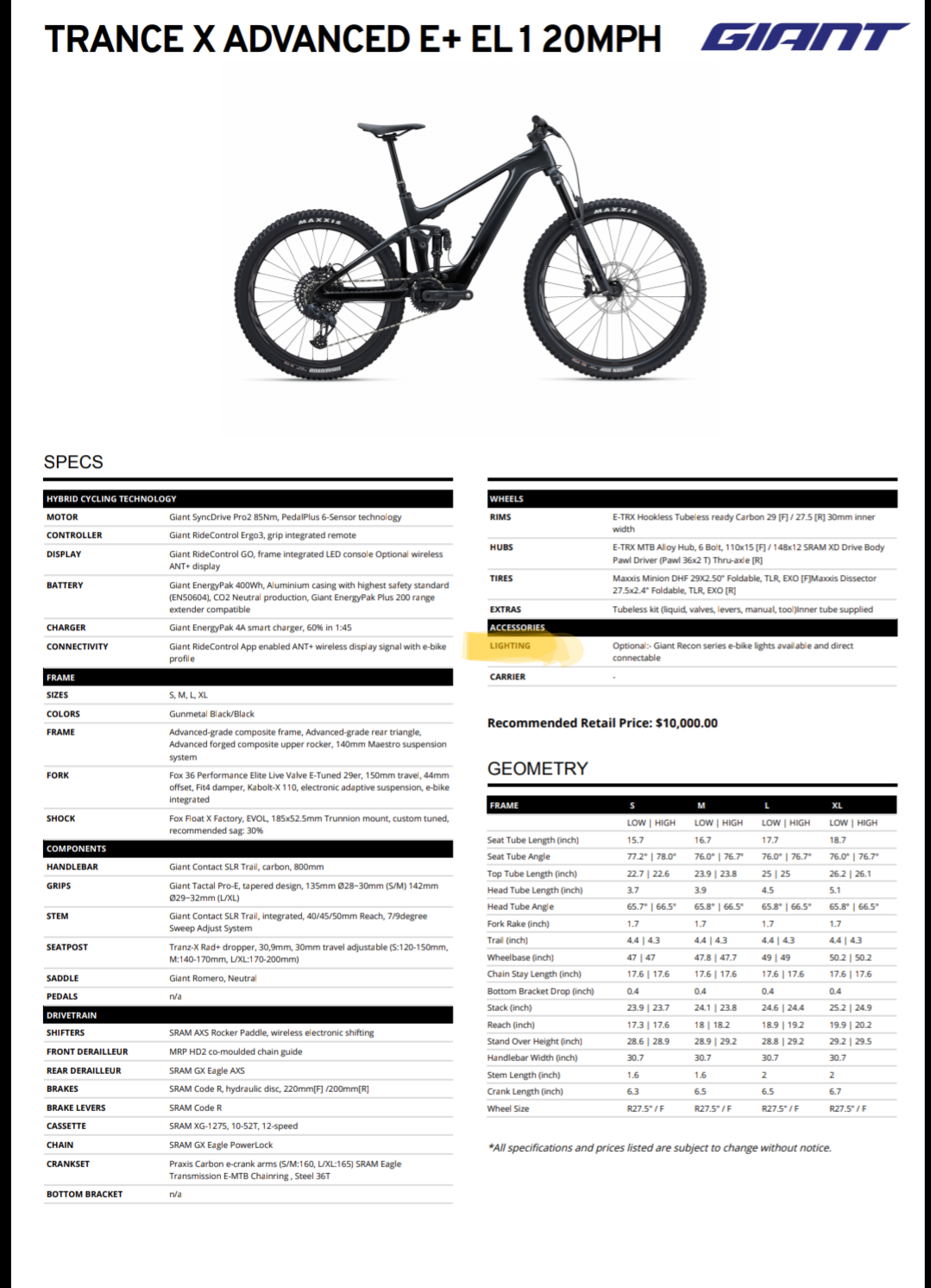

I am attempting to hard wire a front head light source to my my 2023 Giant Trance X E+ 1 battery. There are usually 36v (red) and 12v (white) connection ports located under the SyncDrive2 control unit of the top tube for plug and play. Only the 12v connection port is recommended for the light source. Unfortunately I have discovered that this connection port is being used to power the Fox Live Valve suspension system that is specific only the E+ 1 model.
Has anyone discovered a work around to be able to safely connect a front light source to the battery of a Trance X E+ 1 ? Is there splitter available that would allow me to connect both, or some other work around?
I can't believe Giant would be so lazy with the engineering of their top spec E-Bike for one not to exist.

That's strange as this Giant site lists lights as a possible option;
Speed10689
Mar 19, 2024
Brisbane, Australia
Yes and highly frustrating. My Giant dealership mechanic was absolutely gobbed smacked. He is currently in contact with Giant Australia however at the present they have no solutions. Lights are plug and play for the lower spec E+ 2 and 3 models however the E+ 1 uses the available port for the Fox Live Valve. Very lazy of Giant, especially for their top spec version. I would have thought someone who buys their top spec version would be more likely to want to ride at night, not less.

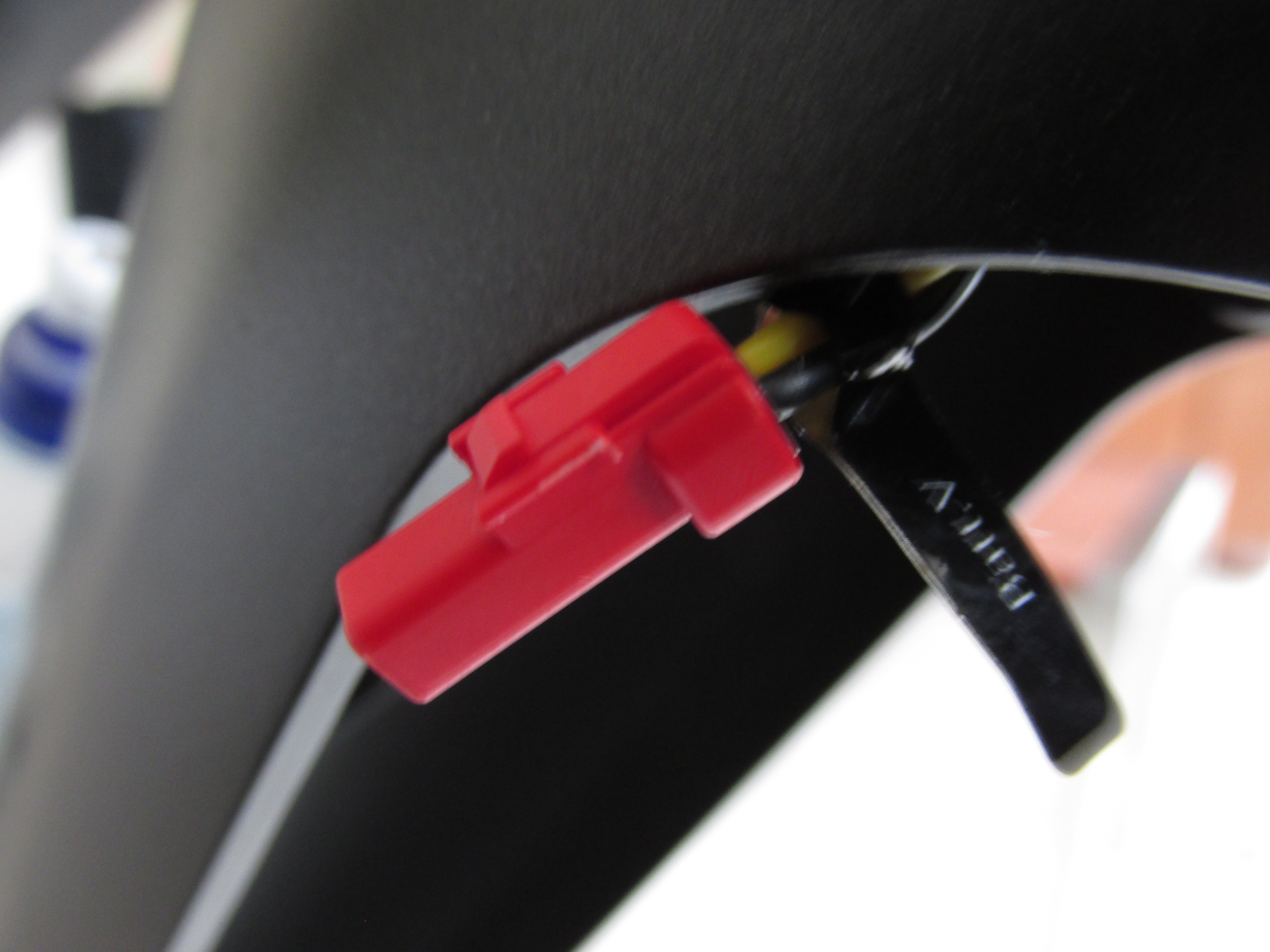

Some frames have a second 36v JST (red) female socket alongside the 6v JST female light connector. Socket is marked "batt V". The circuit is hot and not switched. You can use this with multi voltage 12-48v aftermarket lights, but need inline switch or plug and play as you go.

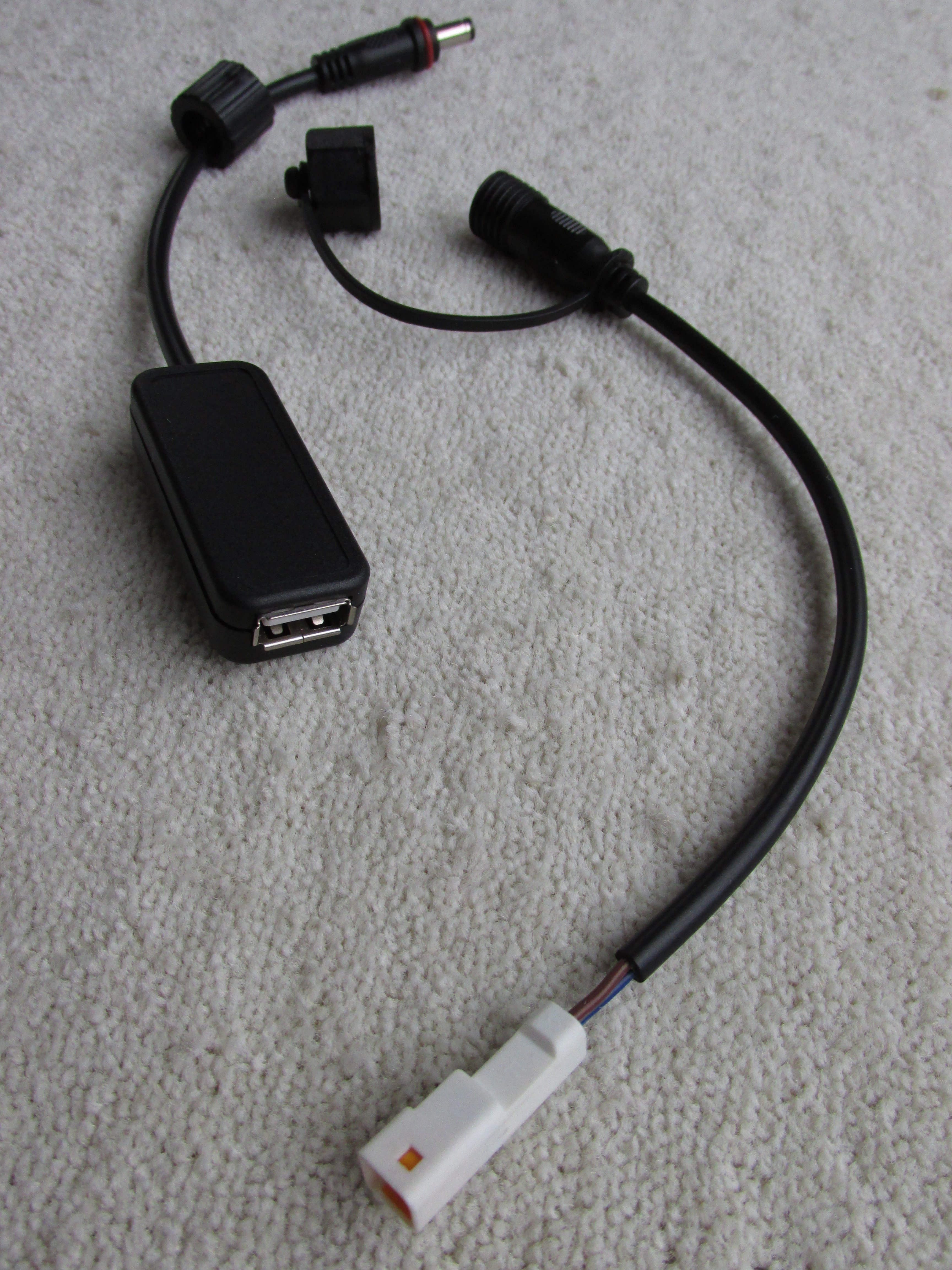

I made up an adapter cable from the JST socket to a 2.1*5.5 DC socket on the bars for lights or a USB step down charger for phone.
The 6v light circuit is only 1.5A supply for 9w lights, the 36v circuit will take 5A easily. You can also use the 6v light circuit for 5v USB output as well.
