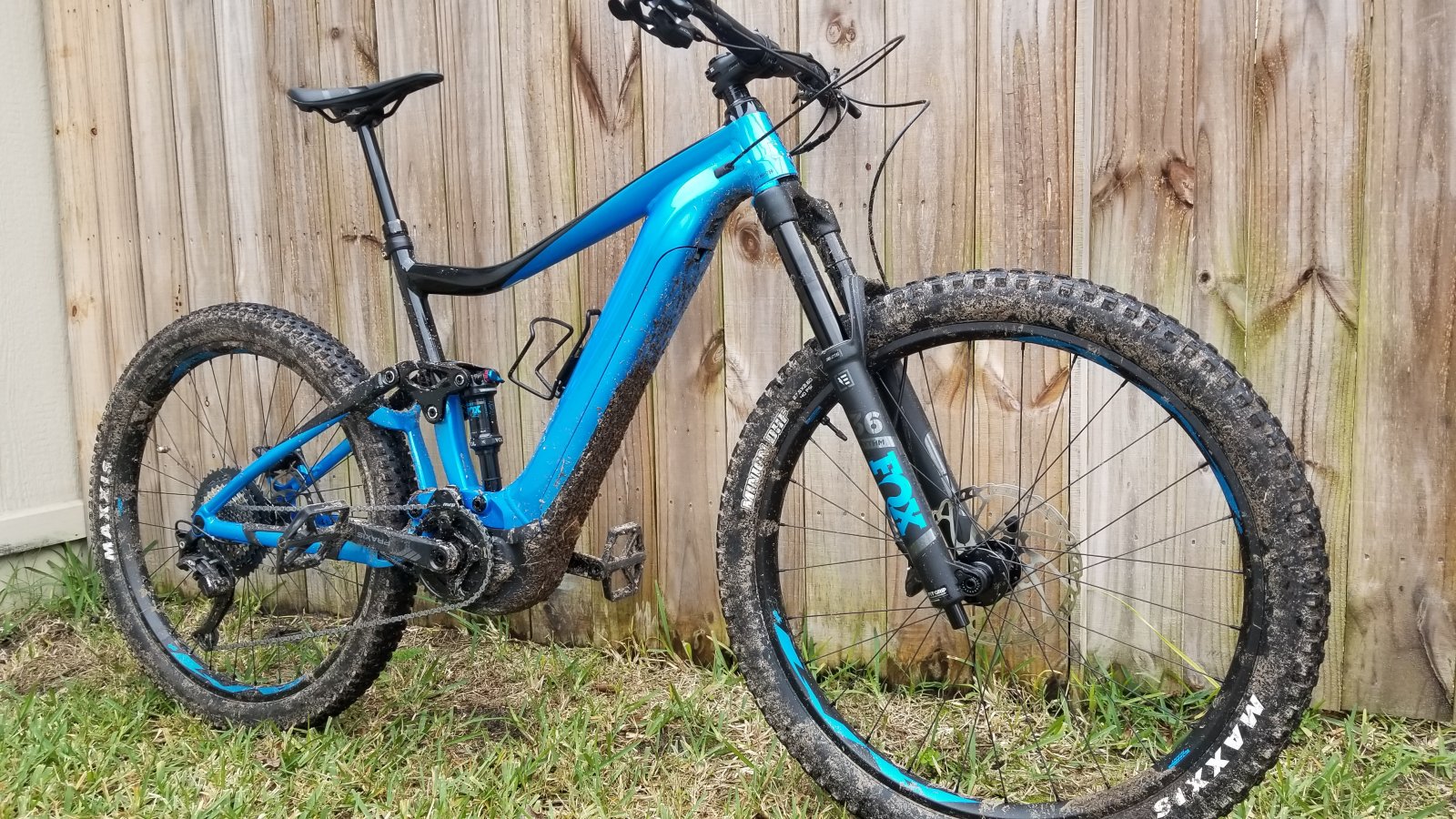

My E +2 has had the same issue. The battery shim was installed and haven't had the issue since. I also had the issue with the freehub, which was replaced, and haven't had another issue yet. IMO, all of these new E-bikes have problems. Read through the other brand forums and you see the same thing. Battery issues, power issues, motor noise, hub issues..... I agree, for the money that we spend we expect these bikes to be perfect however it is new technology and, like it or not, we are beta testers. On top of that, most bike shops are not prepared to work on the electronic side of these bikes. They have no clue what the hell to do in most cases and in my experience, they don't really seem too excited to even have to mess with these bikes. TBH, I have considered selling mine a few times already but at the end of the day, this thing is too much of a blast to get rid of. I'm fairly certain the models that we have now will be antiquated in a year or two as the newer tech that is lighter and more compact comes to market. Ultimately, for me, I wanted a reputable bike brand with a shop close to me, and that rides and handles well and is good value for the money. I think the Giant checks those boxes.

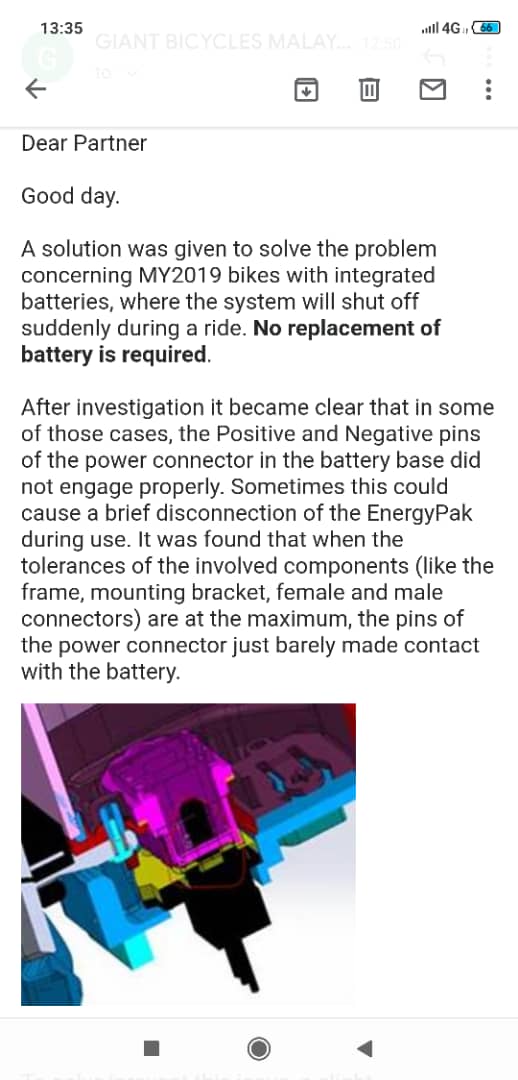

just to update all, i have received a spacer from Giant and reply from them.. see attached for more details.. havent test fit yet..

just to update all, i have received a spacer from Giant and reply from them.. see attached for more details.. havent test fit yet.. View attachment 13867
Thanks for that pdf, am sorting the spacer under warranty and shop is saying they have to drop motor to fit and the labour cost isn't covered under warranty as stated in the Owners manual......kind of annoyed that any costs come from a warranty claim that is manufacturer fault and that spacer must be fitted by authorized dealer.....
