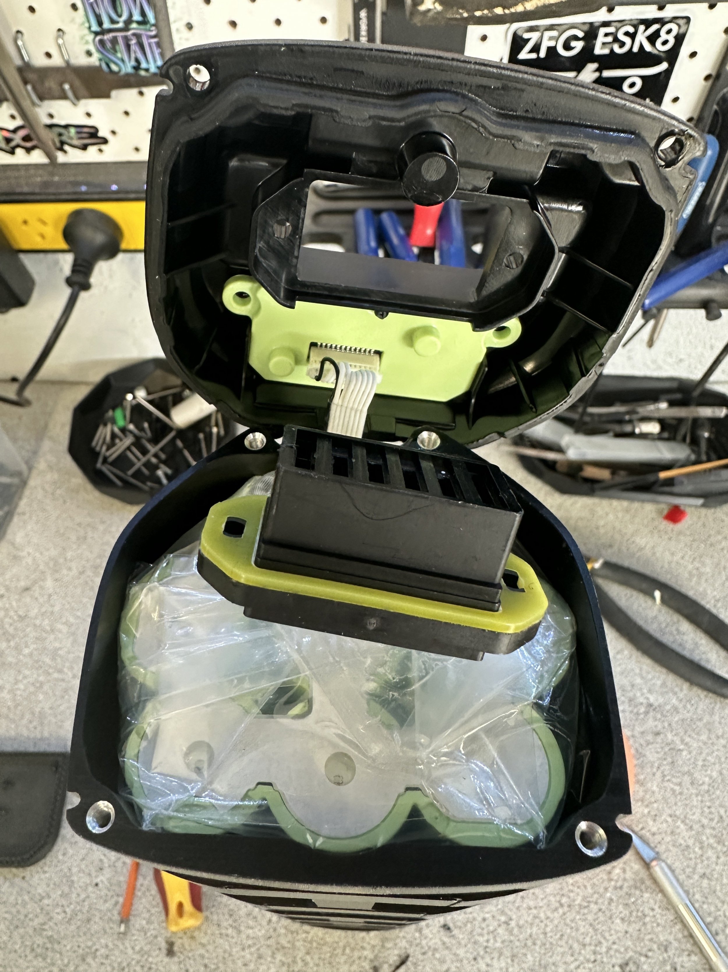

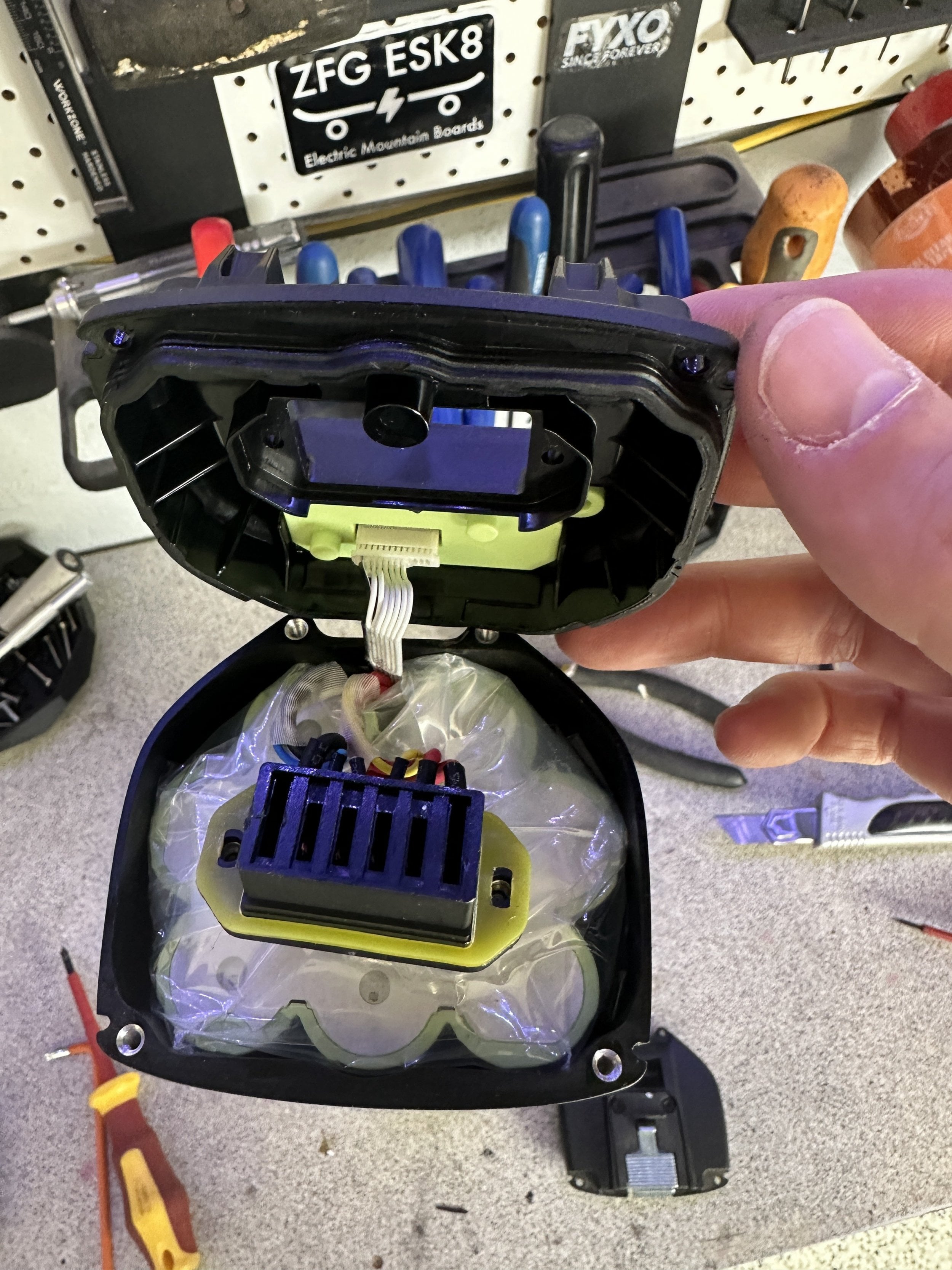

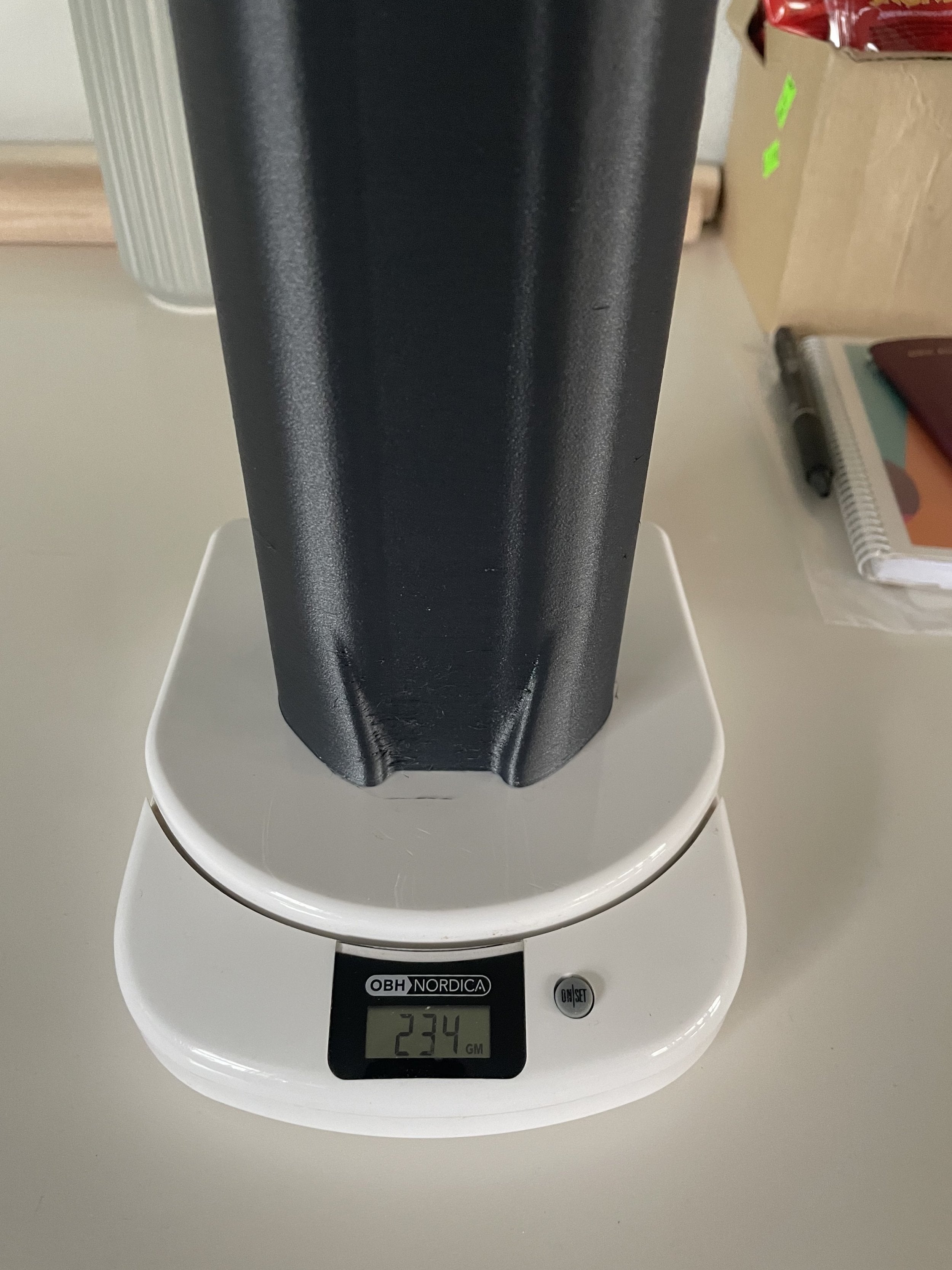

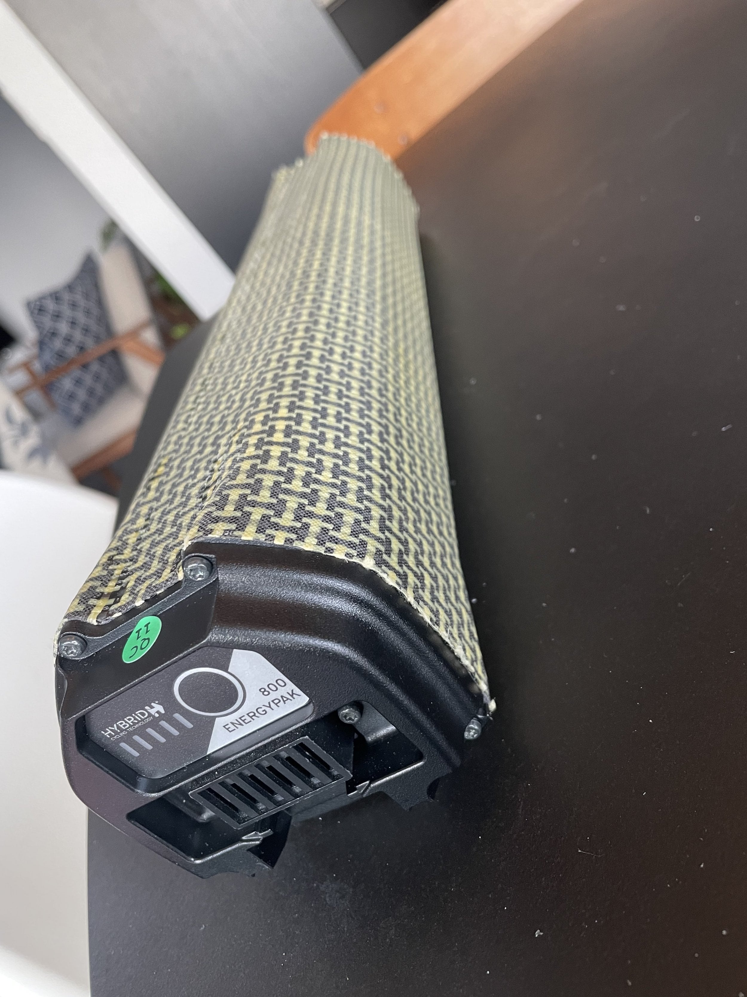

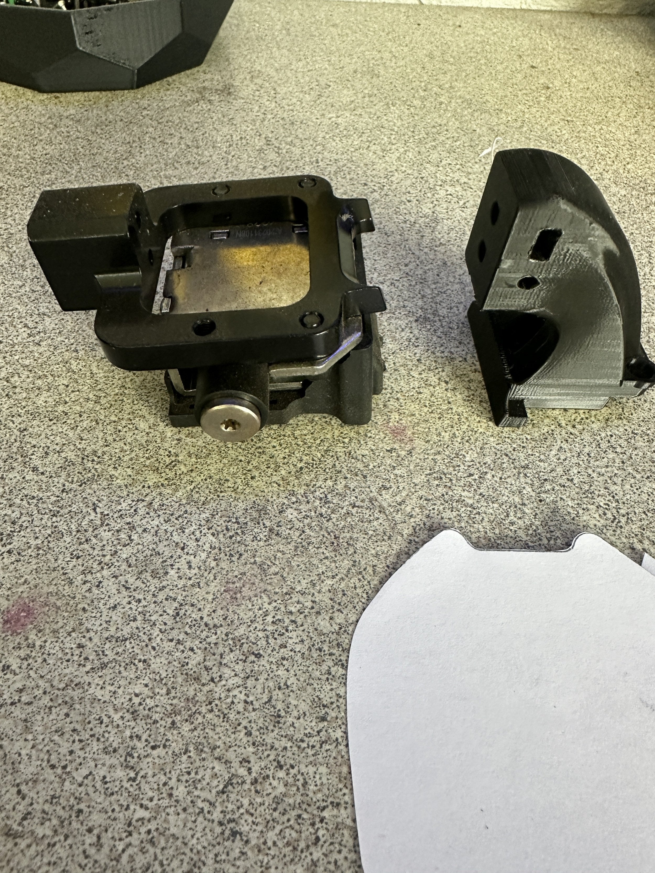

Project died because, 625wh I got was not working, not charging and not turning bike ON, even though it had 40% charge.
Soulution was to make the 800pack lighter with new battery case, 500g lighter. 3D print CF and 1x layer of aramid/CF
From factory the 800 pack is really tight in the housing, so plastic bag had been rupturen in factory during assembling, and one wire was close to short circuit to housing as part of wire insulation was scraped off(brand new battery) .
I dissasemblrd battery in the oposide direction it had been assembled, so I was not in doubt of origin of damage. 95C2F243-1D82-4DB1-91D8-8C5DD8EE3498.jpeg
View attachment 106930 View attachment 106931
I dissasemblrd battery in the oposide direction it had been assembled, so I was not in doubt of origin of damage. View attachment 106932
Nice job - are you selling the STL files by any chance?
Hi Nobrks,
I'm interested in making a same modification to reduce the weight of my Reign. Currently, have two battery packs, one 625Wh and second 800Wh. I would like to know if it’s possible to get STL or MF model that you used for your upgrade?

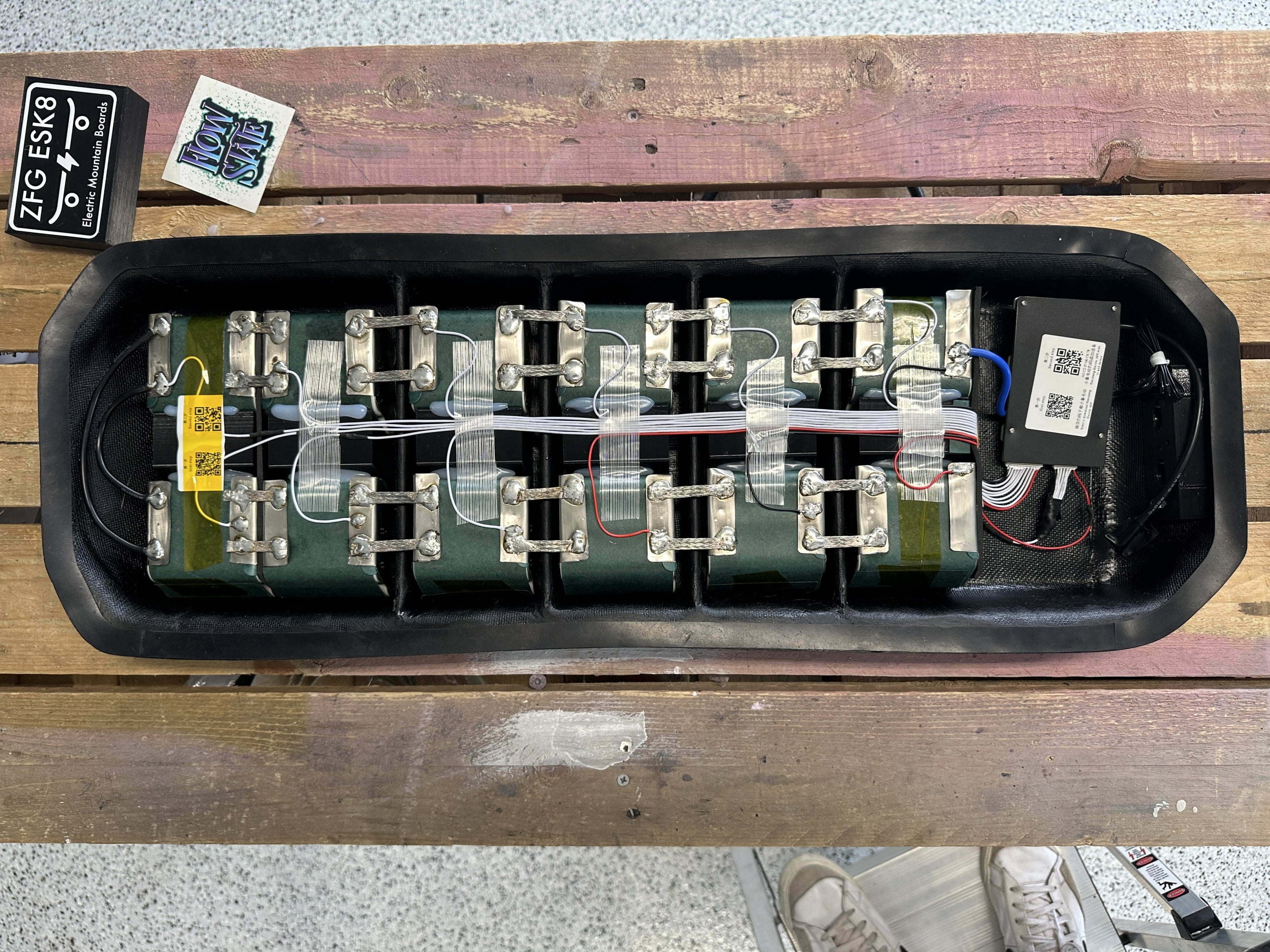

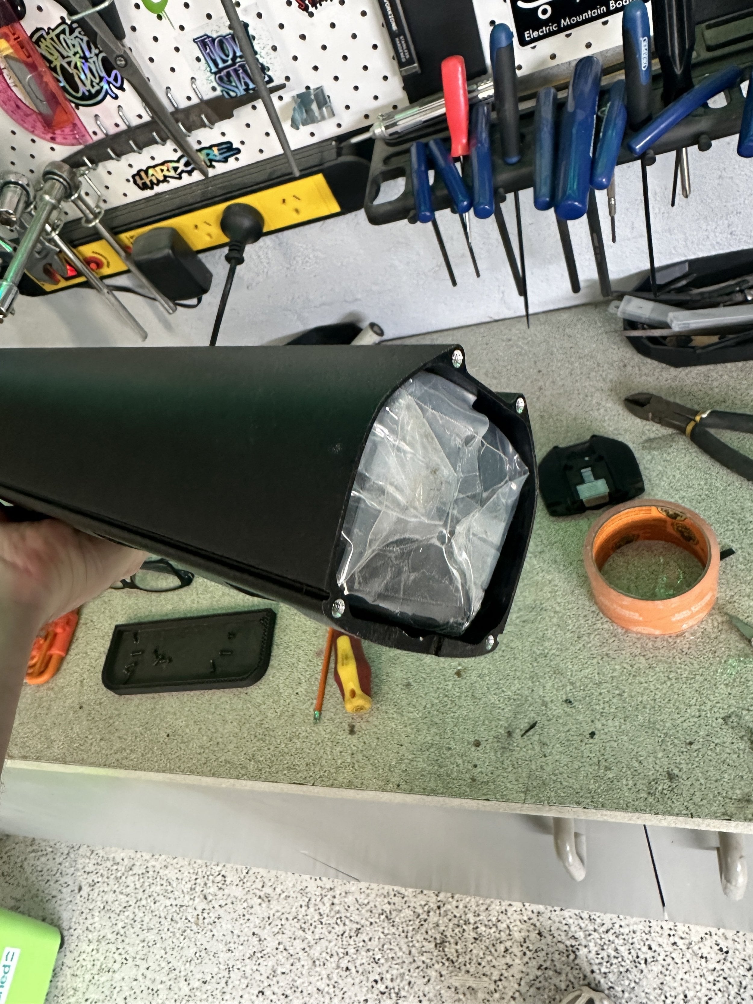

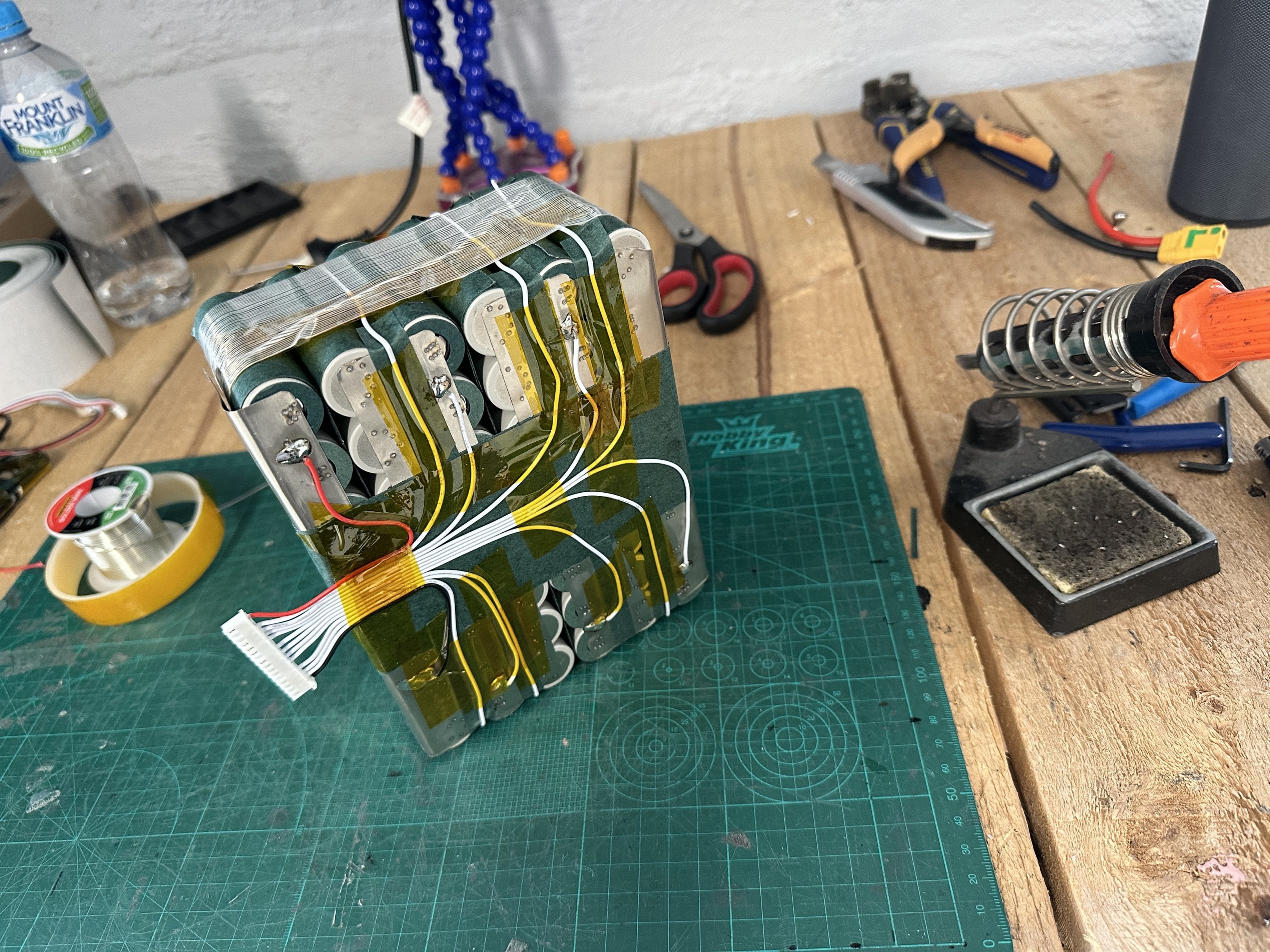

Short story long - I build electric skateboard batteries and I wanted to have a crack at modifying this pack as there seems to be some excessive weight in the enclosure and lock mechanism. One of the biggest hurdles I found was that the battery pack is not easily removed from the metal enclosure - it appears to be stuck and wrapped in a plastic bag.
Giants enclosure can be disassembled quite easily although sliding the pack out will be a challenge - I had no luck and I didn't want to apply excessive force. I'm wondering if there is anyone here that has some information on this process than can share their experience.
View attachment 149965 View attachment 149966 View attachment 149967 View attachment 149968 View attachment 149969 View attachment 149970
The 800wh is quiet stiff to push out, so packed that my 800 battery had ruptured plastic and almost shortcircuit two wires to casing from factory (rupture in oposite direction of the way I pushed it out)
Get something like a pice of wood in similar shape as the inside og casing, use sope spray and put put eeigt on the caseing, against the wood.
You have my design of battery mount, so you can probably source the casing file soon frome same persone ;)
