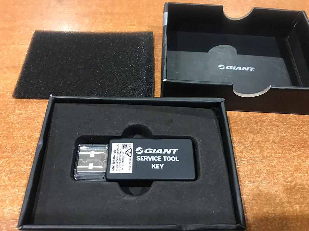

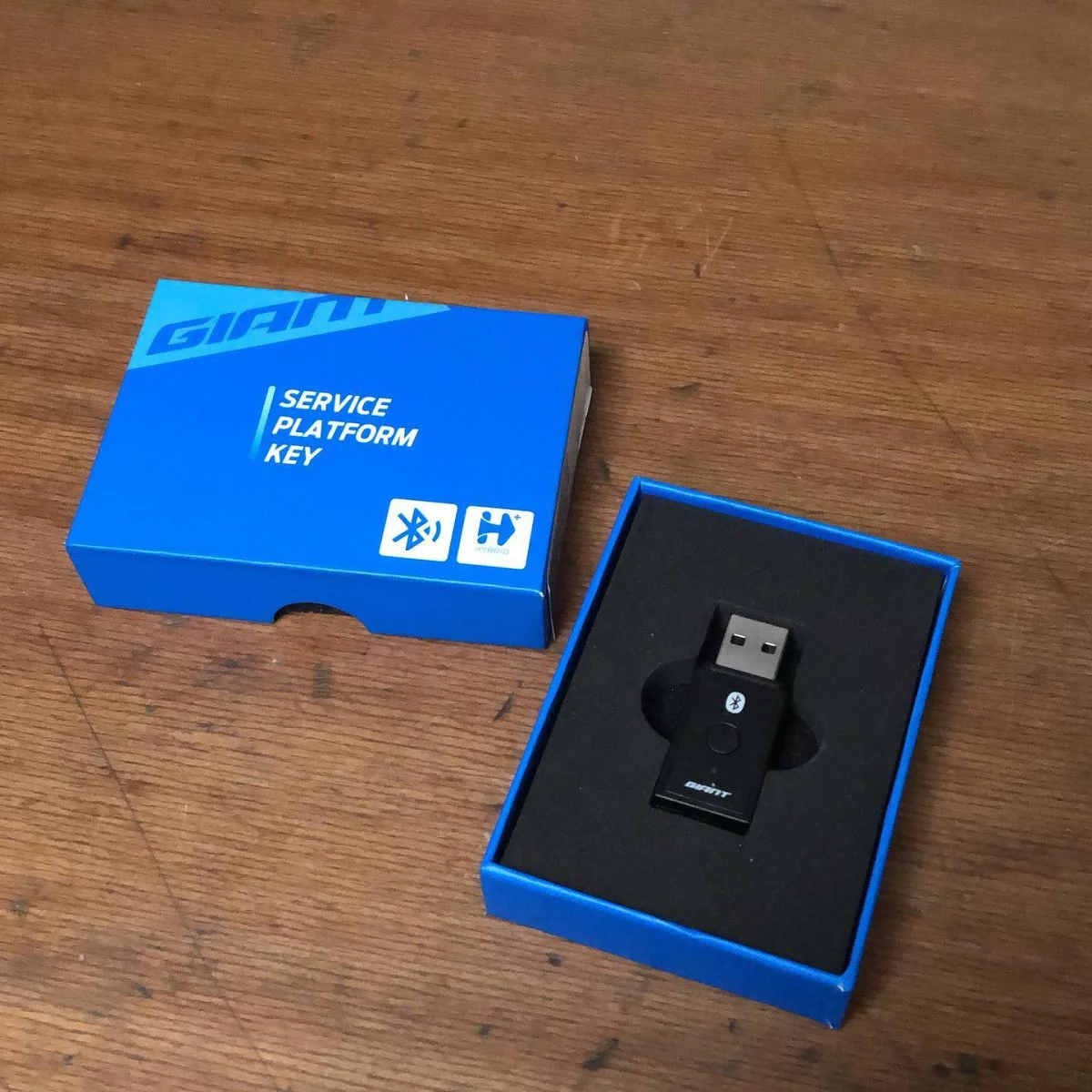

The speed chip is for regular users.
Dealers who own the tool key can use eplus software to change speed parameter and probably modify engine map (still under development). As the guy said that it just needs the service tool key to work I am pretty sure it is more than a BLE chip
Dgedge
May 20, 2020
95
50
France
Same name and same packaging, it is not a coincidence.
But there are many BLE dongles on Amazon so why does the software need this one ? maybe a specific firmware as we can read "Programmable firmware tool for secondary development and compiling " on the description ?
