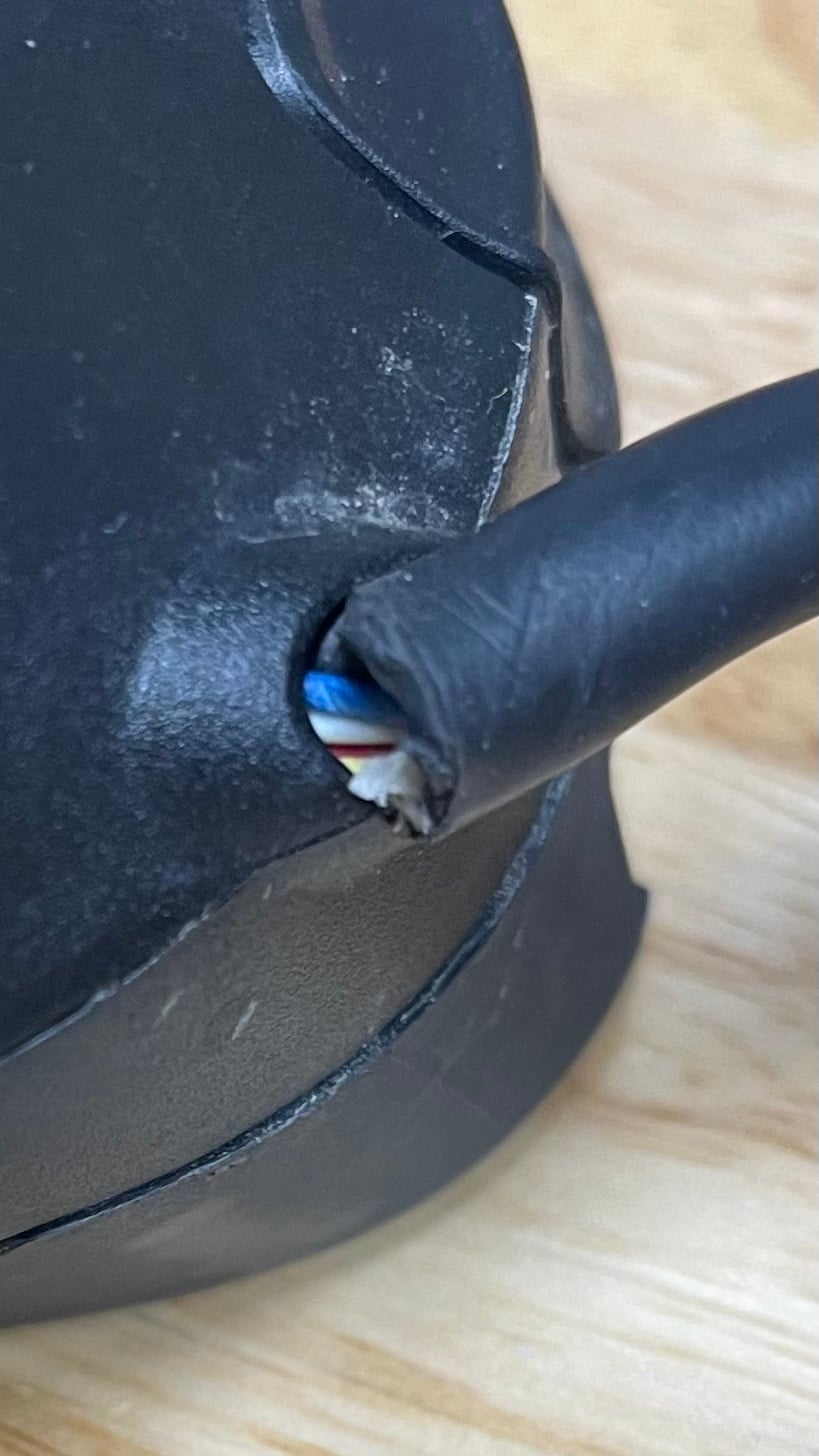

My RE has had the cord pulled out of the battery side grommet since the second day. Giant says they will replace it. I will wait until the last six months of the warrantee so that I can hopefully get a new version with the longer cord.

It’s kind of a bummer that you can’t buy one of the accessories that you need, and that probably helped you decide on that bike. I needs to excshnge mine under warrantee because the cord has pulled from the grommet. Apparently they know about this defect. I figured I’d wait till the only ones available are the longer cord versions. It still works fine, but the strain relief is no longer functional. And the problem is caused by using a cheap vinyl wire cover that is stiff in the cold. $1 savings for them over silicone covered wire.

This is an issue with the Energy Plus pack. The cord is missing a strain relief and the outer jacket of the cord is cut too short. I need to warrantee this when replacements become available. Not sure how this gets past reliability testing because it happened during the first week.

Somewhat amazing that the charger and adapter cords have a strain relief. The actual ride gear does not. Hard flexing cord comes through a hole without even a split collar grommet. And the assembly person cut the outer cover short.
