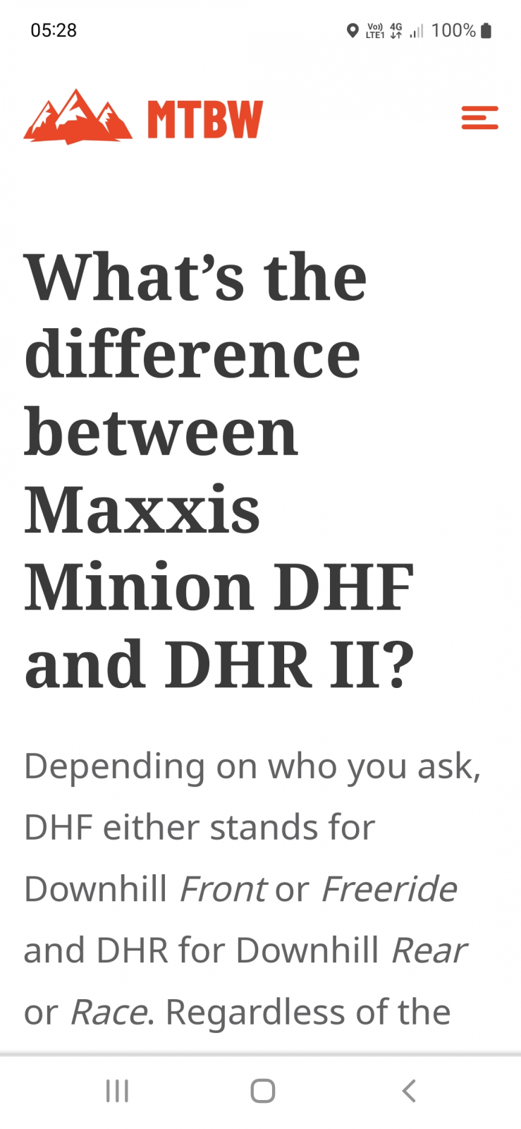

Point 5: The most popular tire at Whistler Bike Park is the Maxxis DHF as people switch their front tires to their rear to save money when they wear out. The most popular setup in Squamish is an Assigai front and DHR II rear. The question was answered a long time ago and is very dependent on where you ride and what type of riding you do. What tires do you use? Where do you ride?
