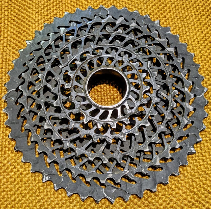

Below are the top 5 single-block cut gears of my old XG-899
