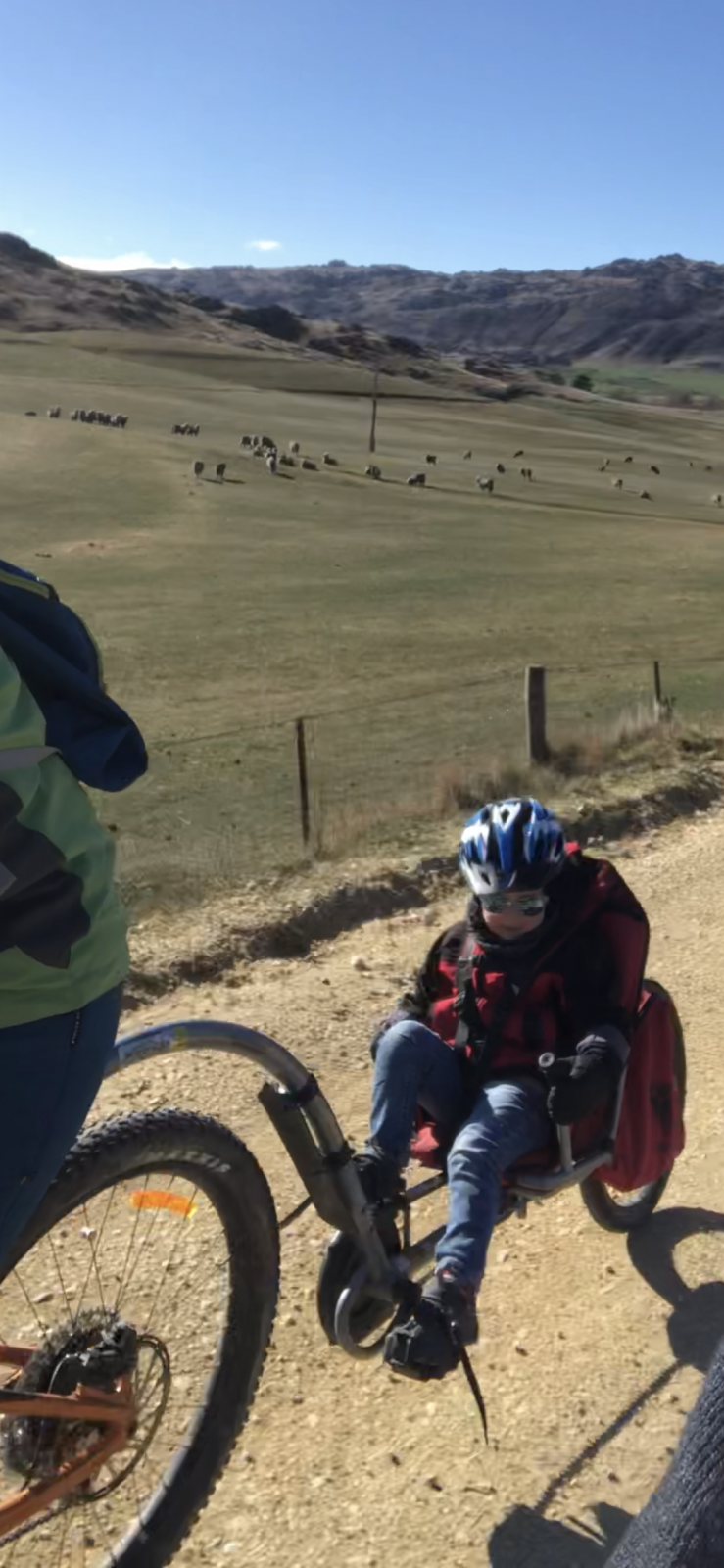

We couldn’t find a seat locally that fitted the wide battery tube and would have to import a Mac ride, so opted for a weehoo trailer instead. Our 3 yr old loves it.

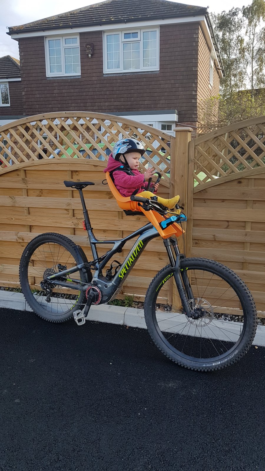

Thanks for all the suggestions, I purchased a weeride which as someone suggested has horrible clamp, so it went in my wife's bike. I went with a Thule product And mounts to the steered tube through a mount that replaces the spacer stack. Turns with handlebars. Feels really good, I'd recommend. Let's the little one back a tad too much though and no platform to lay hea
