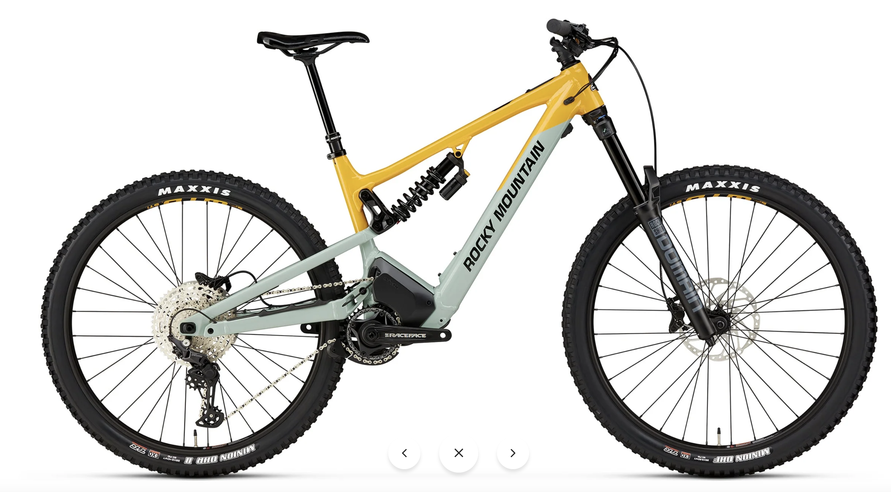

Not sure about the idler design which only allows about a third of the chainring teeth to be wrapped. I predict that it will be hard on chainrings. But just order a pile of cheap ones on AliEx I guess or buy stainless steel. But on second thought Rocky is getting away with it on their e bikes that have plenty of nm so I might be ok!
But Rocky Mountain use a good old chainguide, not sure if is possible to use on this frame.

As far as RM goes their design has different stresses on the idler/drive cog which in their design actually puts less strain on the chainring as most of the power is on the upper cog. But they still use a tensioner behind the chainring to gain more wrap and I'm sure they do it for a good reason.

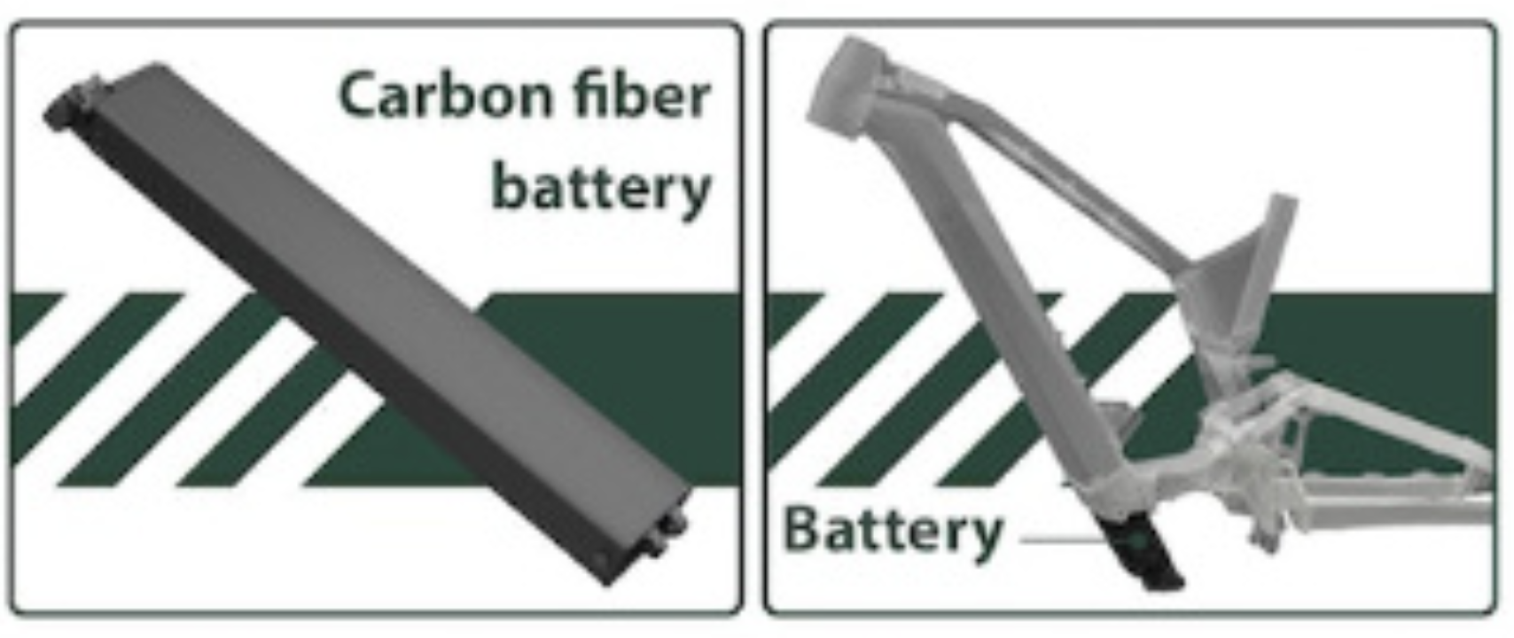

@Mabman and this one? Hybridizer Announces Its First Bike eMTB Frame, SANN - Pinkbike
I' ve also seen a copycat of a Santacruz but i have no idea if is from a good manufacturer.
Interesting. A few different features, notably the rear dropout structure. I can't really confirm from the photos if it is UDH but as it is such a modular piece it would be easy to make it so over having to refit and entire chainstay. Still not convinced that anti pedal kickback is all that important on an eBike and how well the chainring will perform with not alot of chainwrap.
Looking at their bare bones website I get the feeling that they would be a bit more flexible to work with than Frey in regards to deleting components that I can source.
The "Carbon Fiber" battery that is shown is a new one on me. It also illustrates the biggest difference to the Dopamine in that it is a bottom loader. They make a good point that having that gaping hole in the downtube is structurally suspect. Problem for me is that I prefer 21700 cell batteries and if they are using 18650's in that type of case it may not work well with the larger cells.
We will see what they have to say. The principles are well educated young people touting "ten years of mtb experience" so hopefully they will get their ball rolling. If they can supply me what I require they will get my $$.

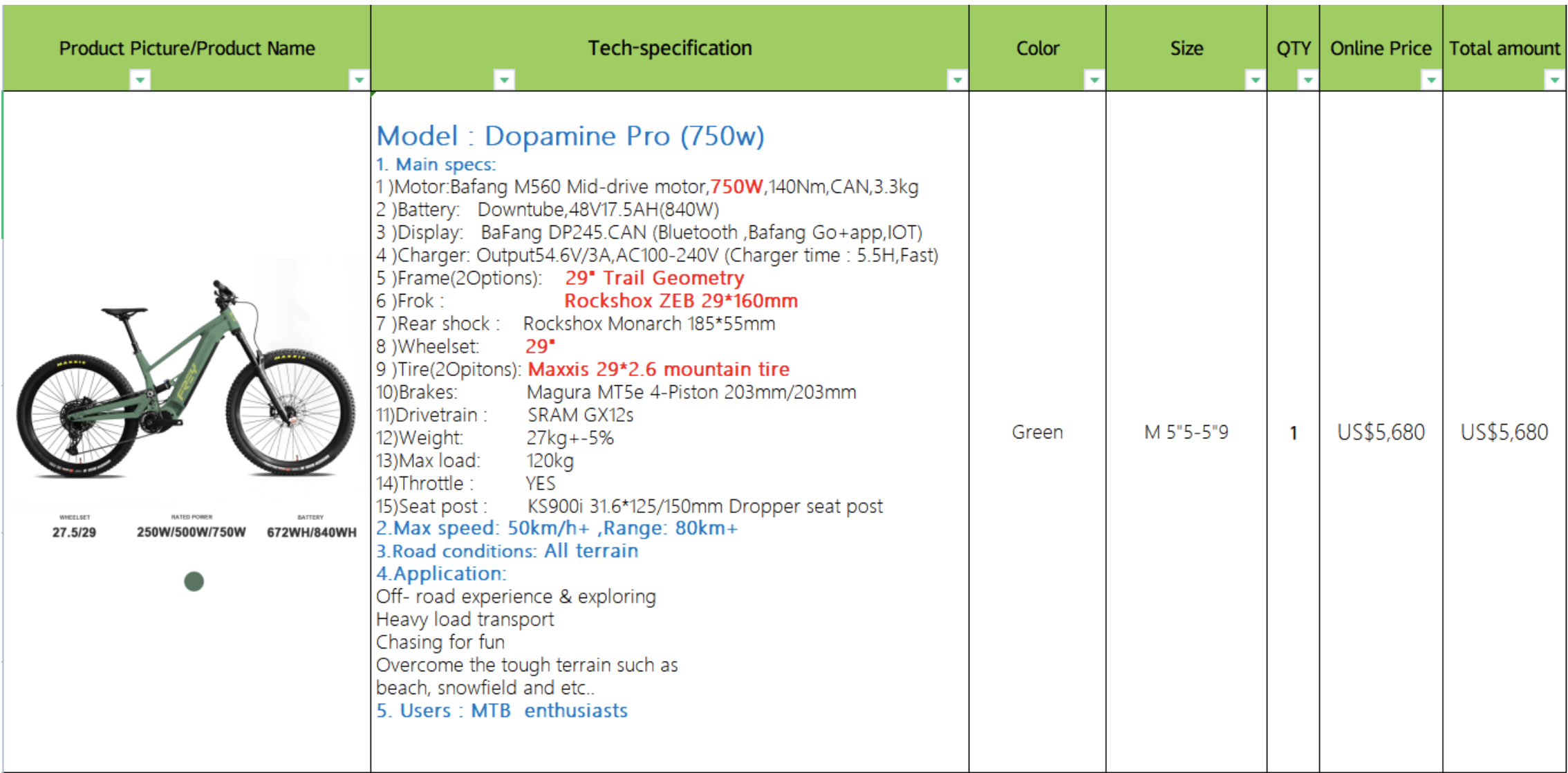

This is what I received from the sales dept. but the pricing is now up on their website: Highly recommended! Frey's Best Full Suspension eBike 2023 - Powerful Motor & EMTB Capable
Pretty spendy for an alu bike these days perhaps? Lead time is 2-3 months with 50% down. Won't be in the cards for me because I have different component requirements specifically and they won't play ball dealing any other way than a full build. Oh well on to the Hybridizer?
