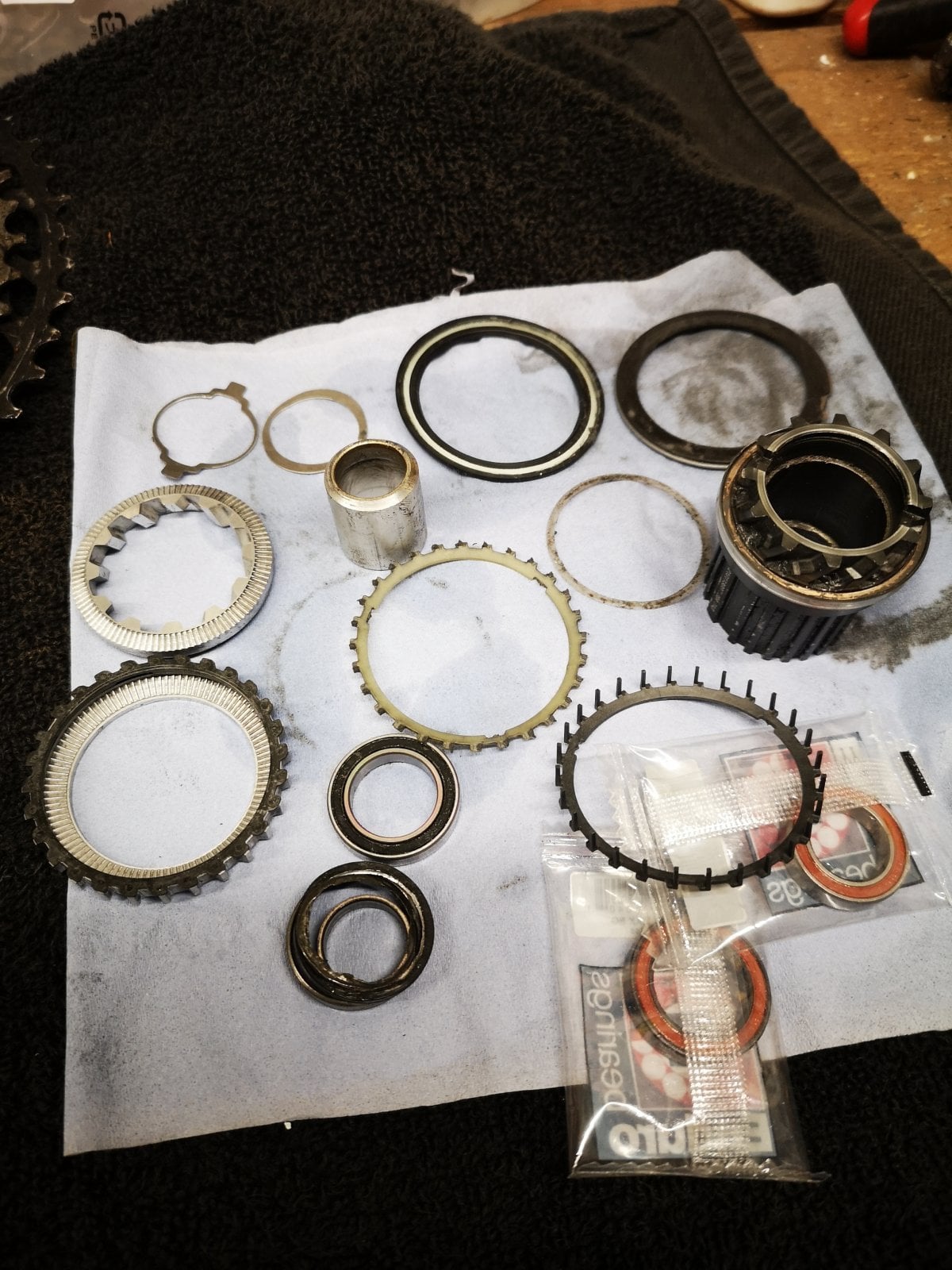

Here is the shimano one I have rebuilt today. No idea if it's same as yours but if it is then yes they can be rebuilt.
Nothing quite so involving fortunately
Three ratchet pawls, a circumference spring and two bearing, so relatively easy to strip
The hard bit would be getting the parts, though probably worth exploring
I removed last last striped, cleaned & lubed, may keep me running for a while until I get replacement

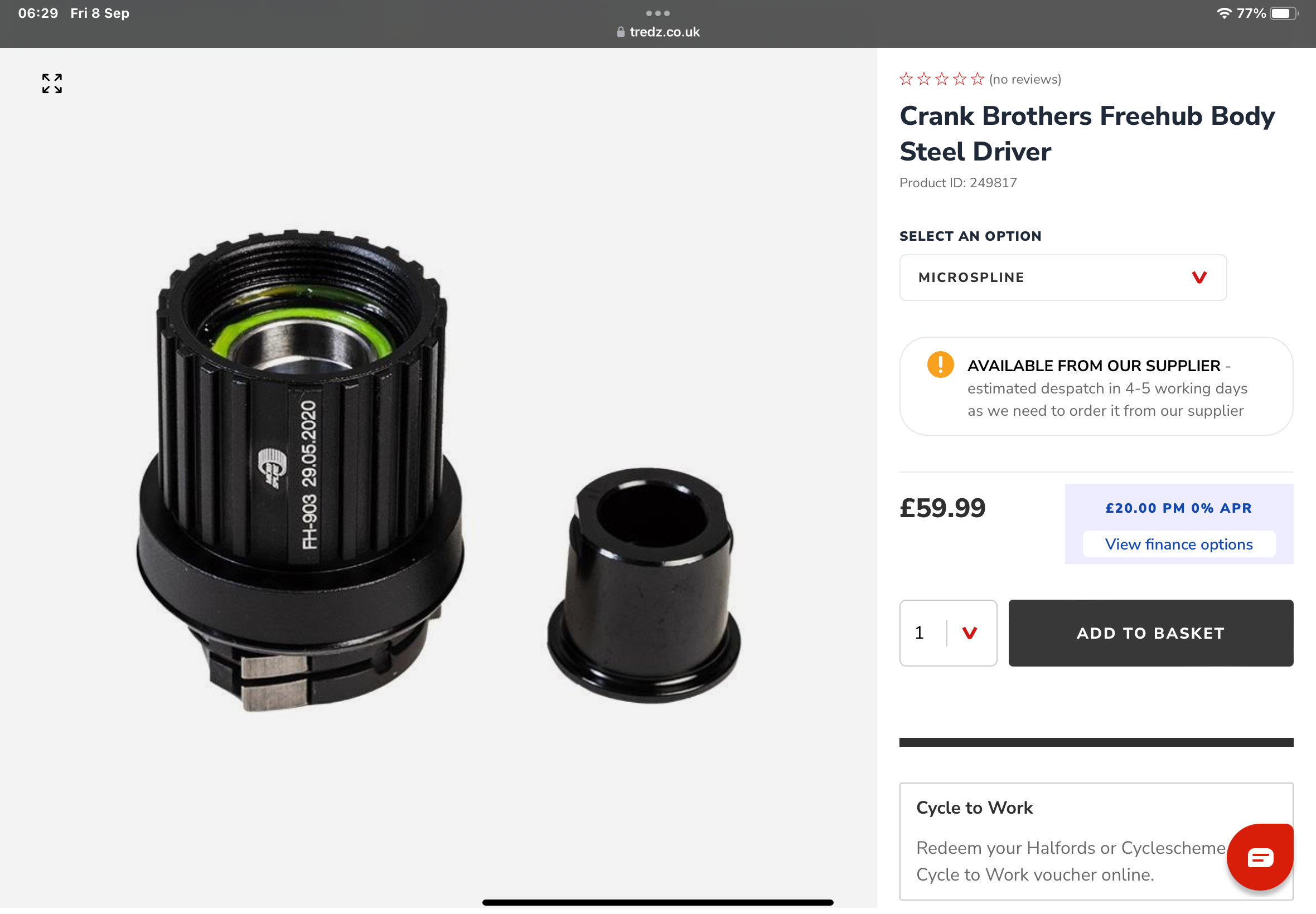

Response from Crank Brother via Tredz, received and seems like I had the Alloy version FH-904
Where as, freehub FH-903 is steel Version and better suited to E bikes

I went to tredz uk and purchased
Noting there was an aluminium and steal version, from discussion with Tredz they had the steal drivers and I’ve had one year use so far
