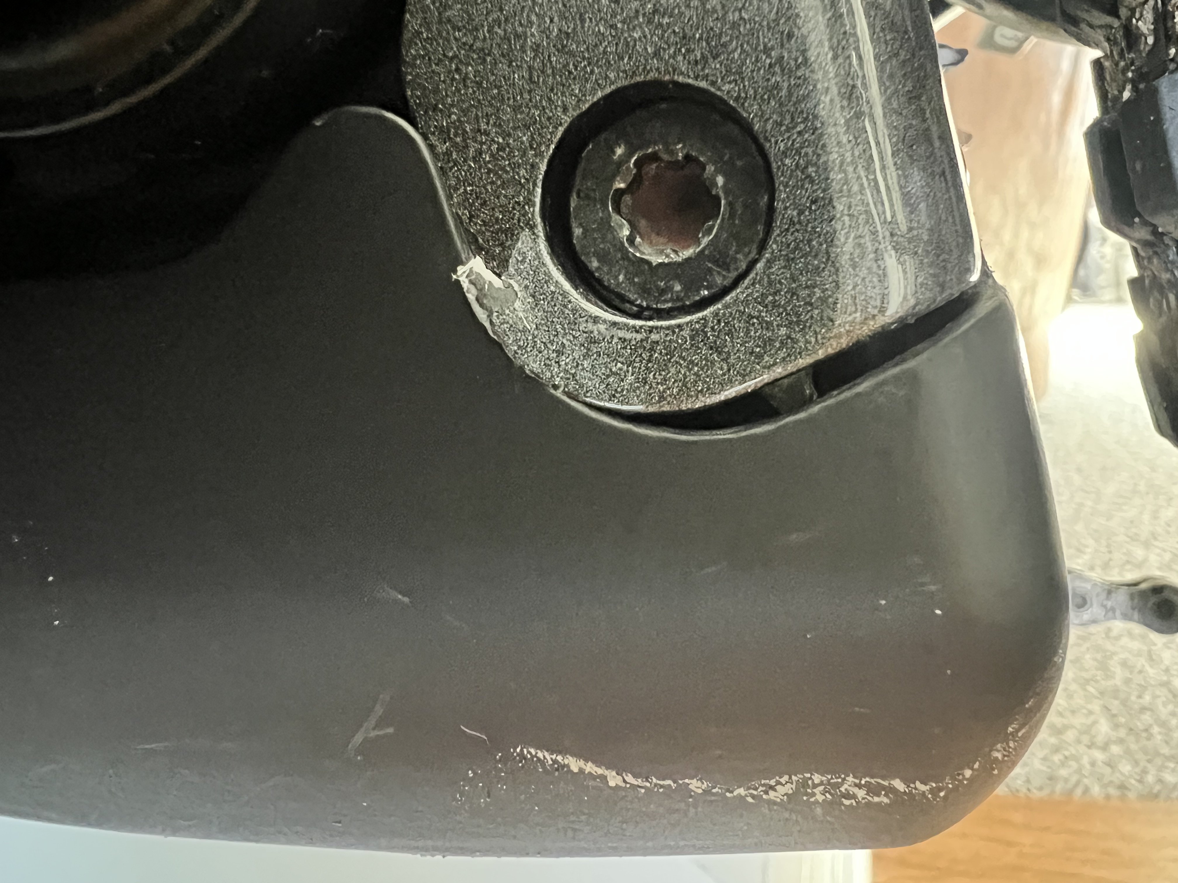

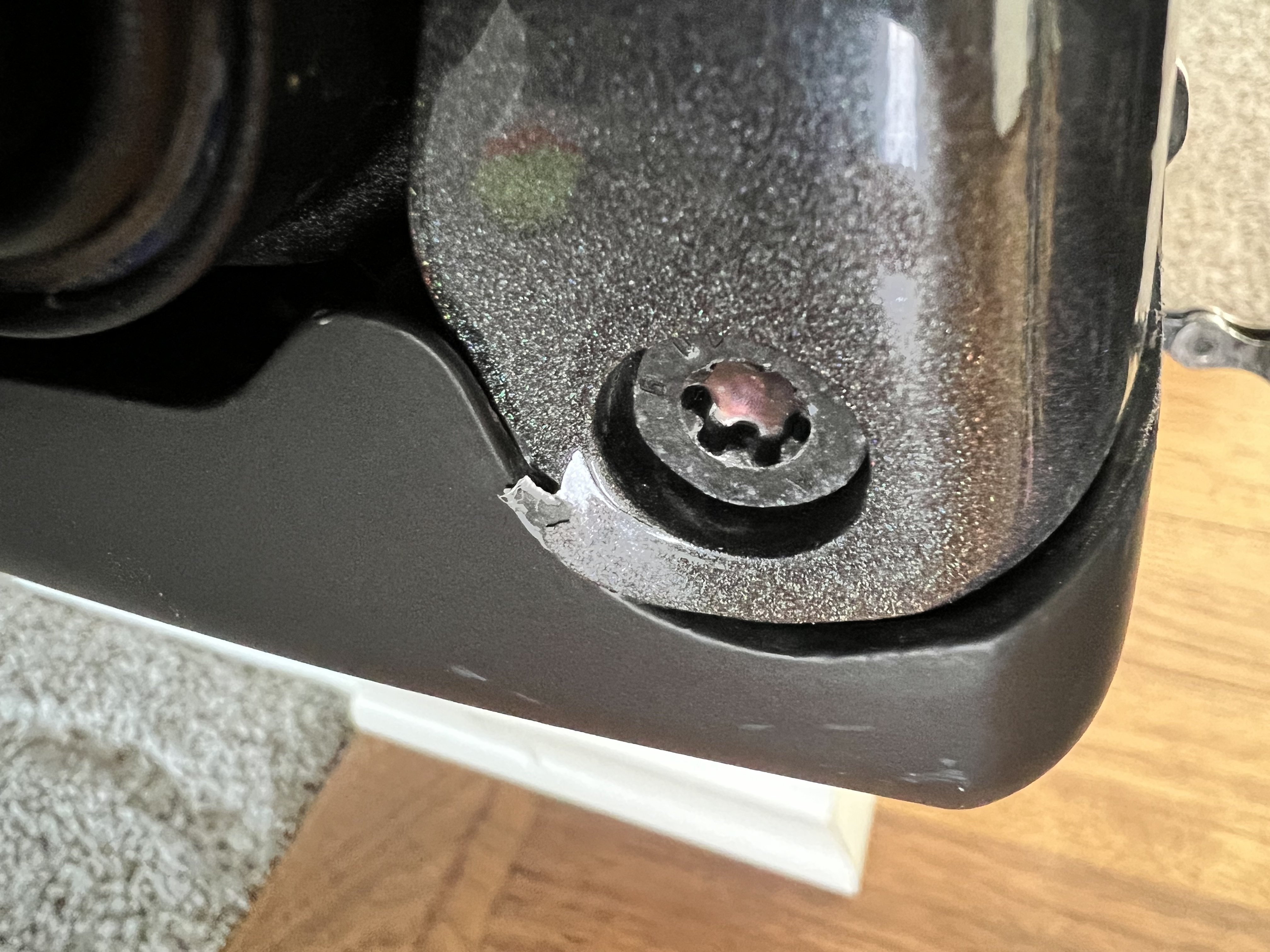

Has anyone else had this happen to them? 2022 Rail 9.8. Not sure this compromises the frame - seems like it may be either just the clear coat or the outer most layer of carbon.

Well the flakey bit is clearcoat..........the bigger separated part looks like filler.

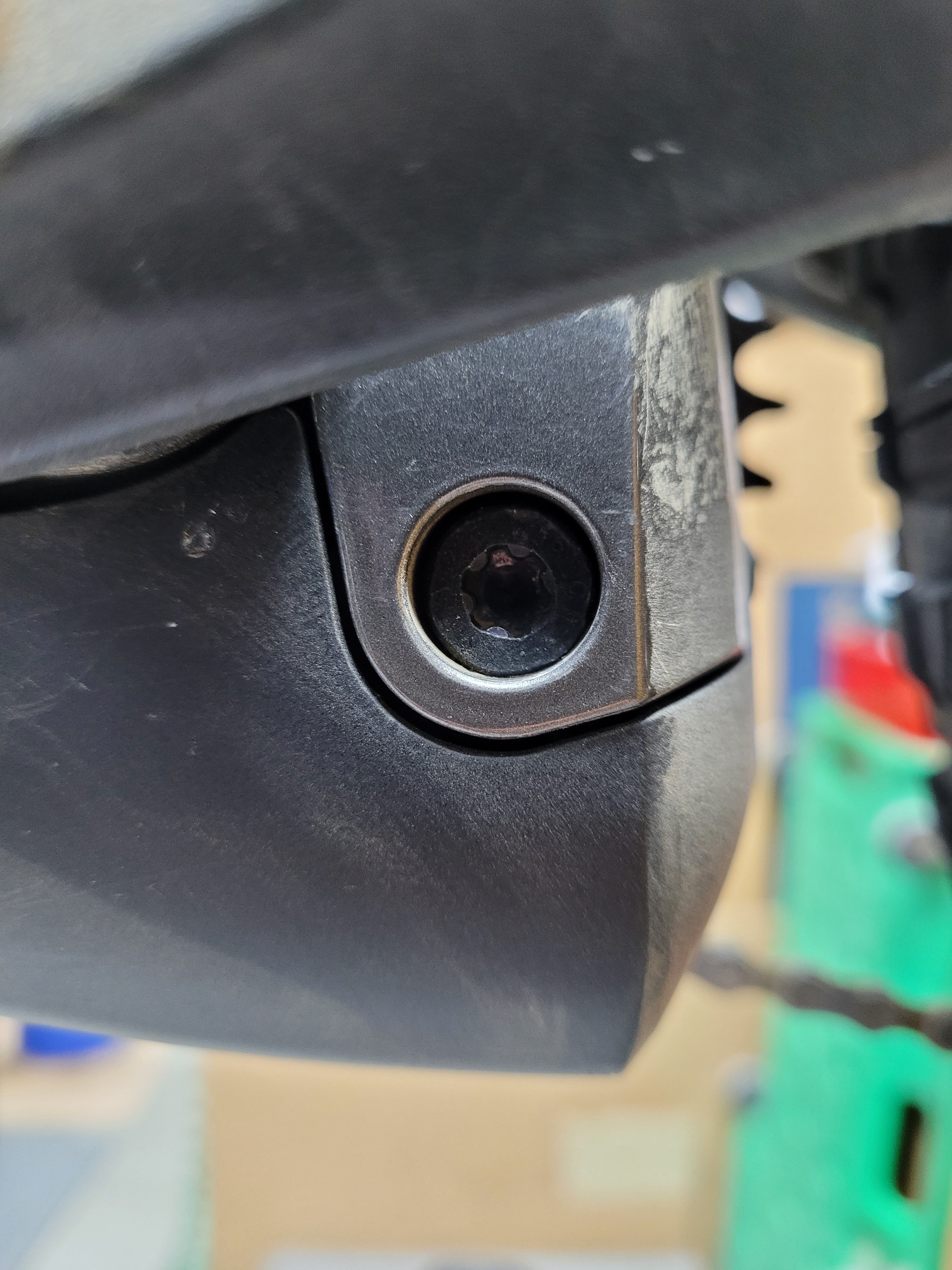

Is your "motor armor" bent from impacts which caused it to contact the frame? Mine isn't touching there but it's smashed underneath from rocks. So I'm starting to build a stronger version than the stock wimpy aluminum one.
Damn - it must be. Looking at yours, my gaps are way off. Arg! Maybe a big impact caused this…who knows.
