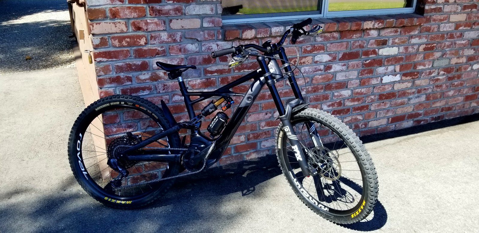

I blew the fuck outta the stock marzocchi POS(bent the fricken shaft, and broke the clip) shock today, and couldn't find a DHx2 anywhere that could get it to me by tomorrow. I don't know what made me think of it, but I looked up the size of the X2 on my Firebird(Pivot) 29", and sumbitch the thing fit.
I've now cannibalized both ends of the Pivot for my Kenevo.
I'm gonna ride on the X2 tomorrow on some pretty rocky, bomb-holed, steep runs. I really prefer having traction on these runs cuz of all the rocks(a lot have broken away), so we'll see how well the X2 sticks the tire to the ground.
I'll report back View attachment 26338
Nice kenevo :) . Did you have any rubbing on the X2 against the frame on full compression ? How did you mount it ( Guess is same hardware for the X2 and the marzocchi you have originally ) ?
yokev
Jan 26, 2020
39
33
US
Nope.
I'm guessing Specialized simply put the 2.5mm spacer/washer in there so both ends would be exactly 180mm. Not sure what the extra 2.5mm at the shock extrapolates to at the wheel, but I wouldn't think more than an extra 5mm.
In any event, the suspension compresses fully without anything even getting close to touching.
The X2 actually surprised me with how well it worked on the Kenevo. The X2 wakes the bike up, as it pretty much does away with that 'jumping a semi' feeling the bike has with the OE Marz coil
Fox was totally out of DHX2's when my Marz broke,(later learned it was because thats when they were moving on to the new 2021 that took forever to show up), but I was lucky that my Pivot's shock was the same size(230x65mm), so I could try its X2 on the Kenevo before I pulled the trigger on one.
