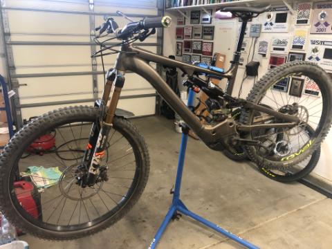

I've always preferred coils on my bikes, but I'm really considering putting an X2 on my '20 Kenevo, as the linkage rate they have on these things is NOT conducive to popping off stuff. Trying to pop off rocks, roots etc. feels like trying to jump a semi
I put an X2 on my '18 Kenevo for a minute(sarcasm for a week), and right away I didn't like its initial stroke stiffness. Obviously coils are softer in the initial part of their stroke, but air shocks tend to lack mid-stroke support. If the linkage leverage curve for the bike you have looks like a frown(the 'apex' of the frown means the linkage has weak mid-stroke support, ), you typically would wanna stay away from an air shock
yokev
Jan 26, 2020
39
33
US
I blew the fuck outta the stock marzocchi POS(bent the fricken shaft, and broke the clip) shock today, and couldn't find a DHx2 anywhere that could get it to me by tomorrow. I don't know what made me think of it, but I looked up the size of the X2 on my Firebird(Pivot) 29", and sumbitch the thing fit.
I've now cannibalized both ends of the Pivot for my Kenevo.
I'm gonna ride on the X2 tomorrow on some pretty rocky, bomb-holed, steep runs. I really prefer having traction on these runs cuz of all the rocks(a lot have broken away), so we'll see how well the X2 sticks the tire to the ground.
I'll report back
