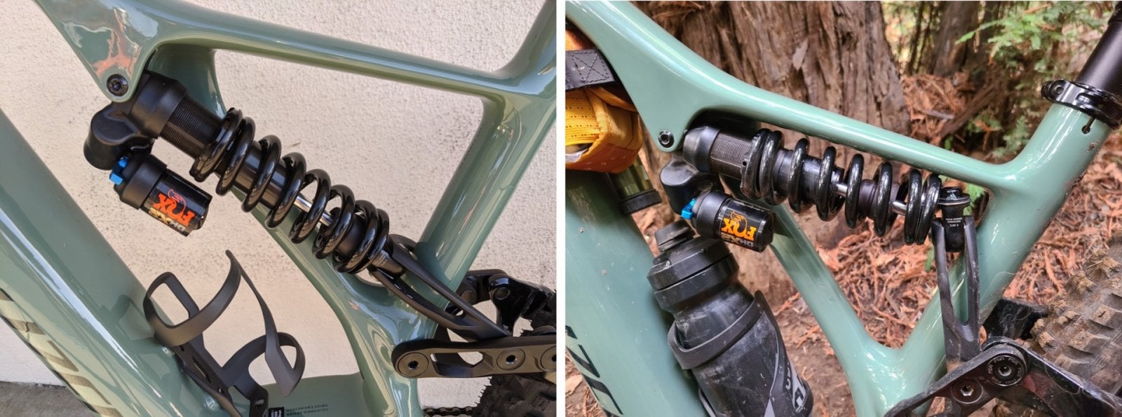

Anyone else with a DHX2 on their SL having issues? I have a 55x210 with a 700lb spring on a XL frame, I weigh roughly 220lbs/100kgs. Shortly after installing the shock I noticed play in the shaft of the shock, sent it in to Fox and they rebuilt it under warranty. Not a month after getting it back, I had the same thing happen. I contacted Fox and their response is that they are no longer recommending coil shocks for Levo's and SL's as well as various models from other manufacturers. They say that the yoke is putting too much lateral pressure on the 9mm shock shaft and as a result blowing out some bushings inside the shock. I sure wish Fox would make a little bigger deal out of this, that way the shop I bought my shock from may have been able to steer me in a different direction. So now I have to send my shock back to get rebuilt again, try and sell it and then find an X2 or DPX2 I guess? I really liked the way that shock felt too, I'm pretty bummed :mad:

Fwiw ext storia has a larger diameter shaft. No issues with mine on the SL. I believe that the dvo jade x has a larger shaft as well (google that to make sure ?).
Side loading on the shocks was an issue on the previous model stump jumper. Sucks that it still seems to be with the SL

Ok, was just asking as when I ran the Ohlins with its own bush, I needed washers to fill the square section. I ended up running a modified bush in its place.
I also noticed that the shock bolt needed to be super tight as from stock it loosened itself slightly causing some movement. I now wrench that thing super tight.

Originally no one was going to do anything about it. But I received a call from Fox and apparently Specialized is stepping up and helping cover replacement costs. Sooooo, sometime in the Spring when Fox receives inventory again they are sending me an X2 at no cost to replace the DHX2.
