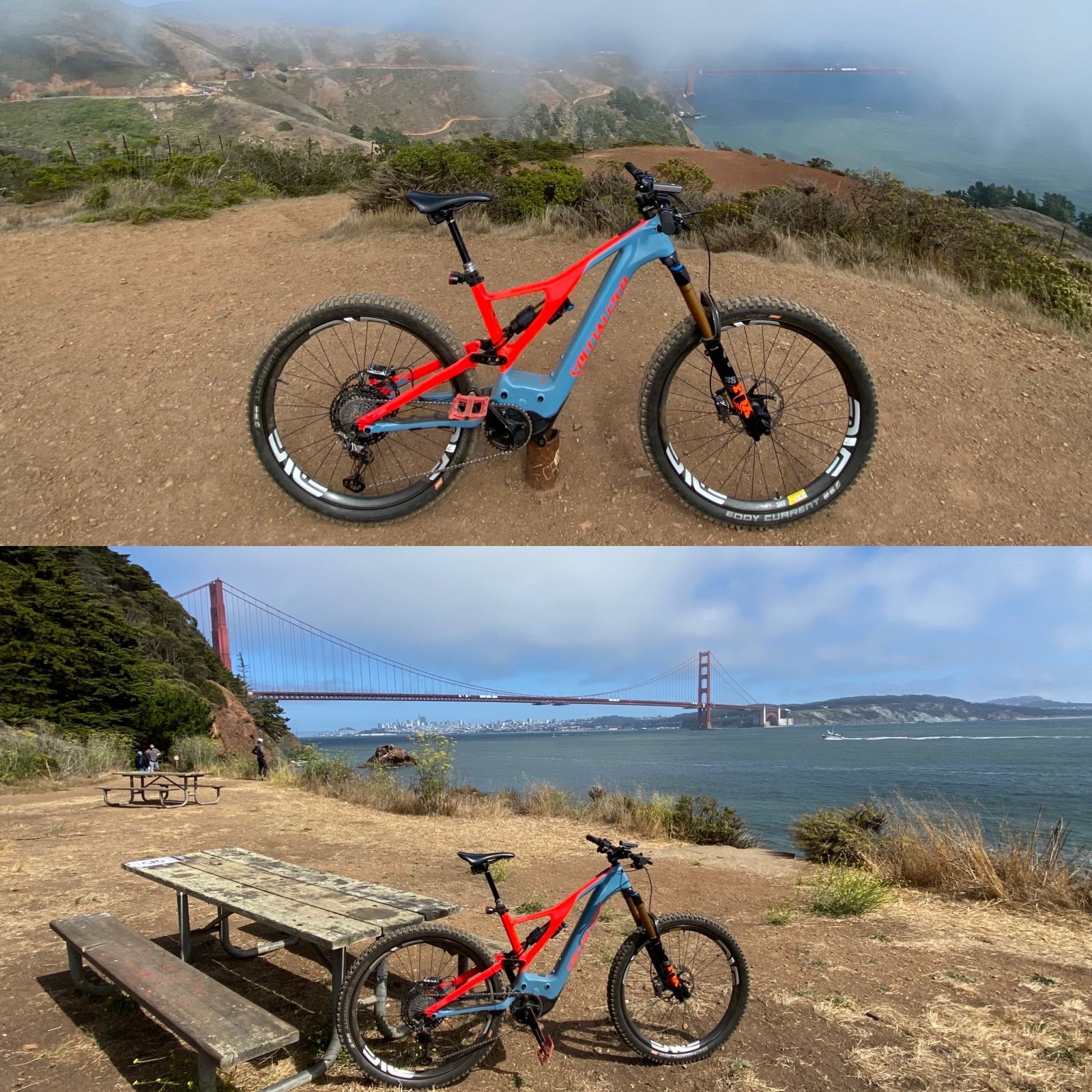

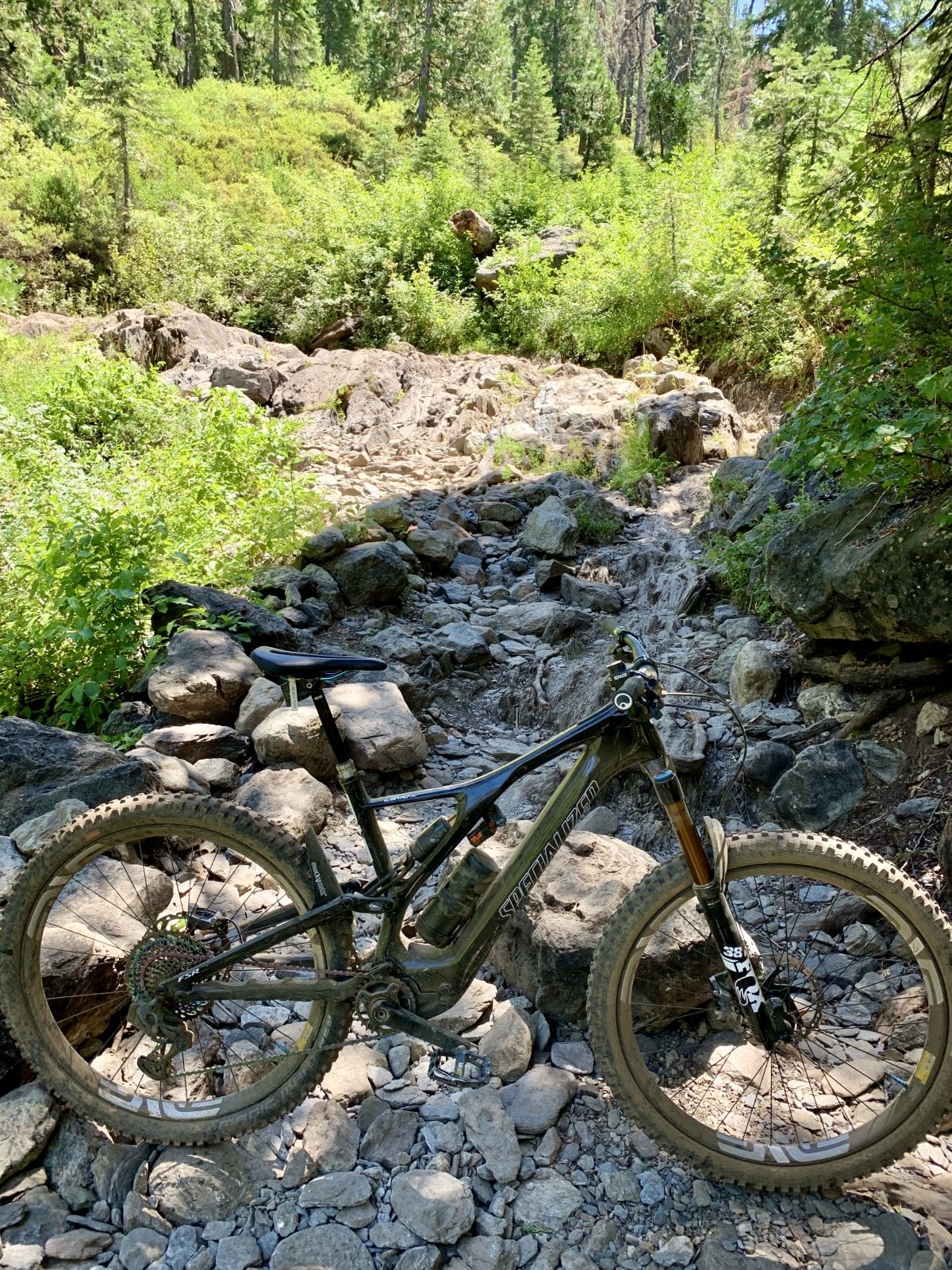

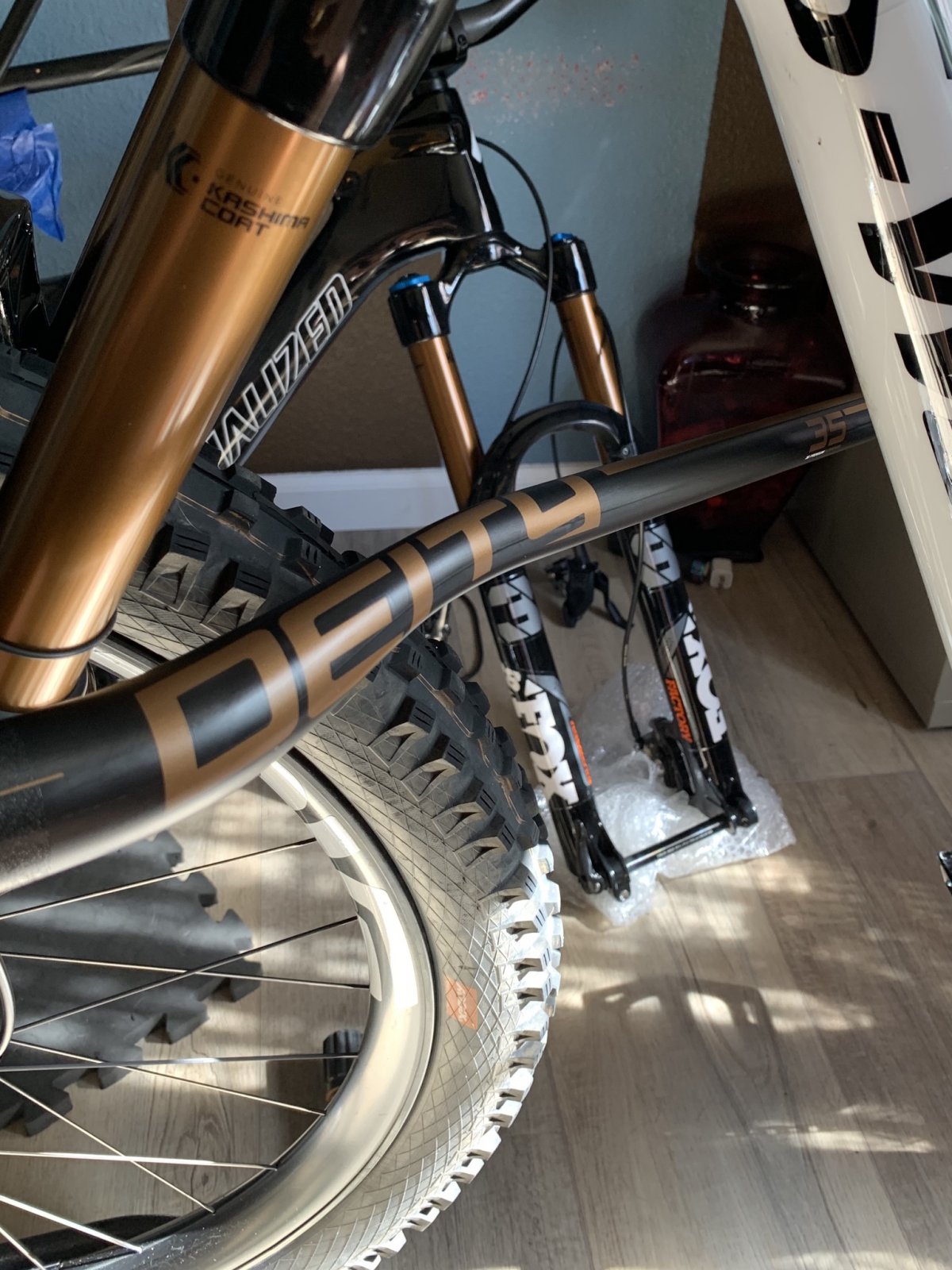

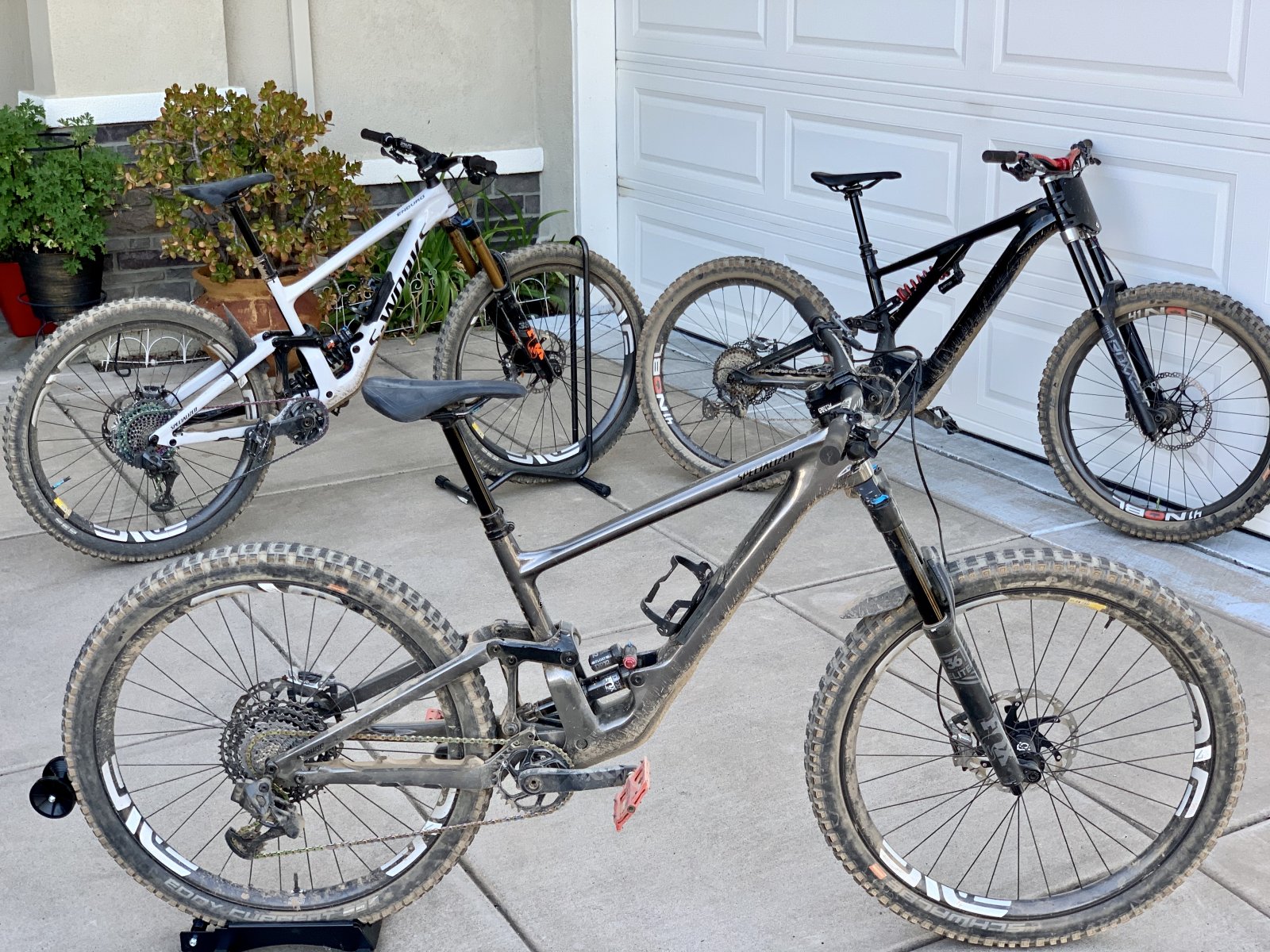

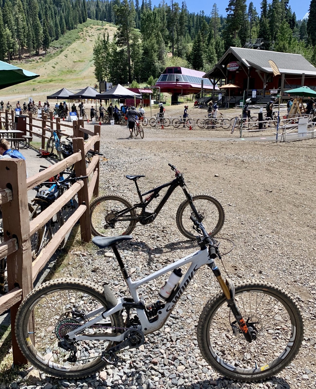

160mm, 44mm offset Fox 38 on SL
170mm, 44mm offset Fox 38 on Levo and S-works Enduro
Got them for California Chunky trails. Also i'm quite chunky myself
Makes the bike a little heavier but i don't mind
So far so good. Rides like butter
The 36 performed just as well, but since i had to buy a new fork i went 38. Also for more travel
The crown is burlier and is more flush with the headtube
It's taking me more time to fine tune. Still playing around with volume spacers too
I've been taking the Enduro to Bike Parks to mess around with adjustments. SL will be next to try at park

View attachment 37779 View attachment 37780
Are all these your bikes?!? You can single handily keep a specialized retailer in business with purchases like that. lol
I have a 38 on my enduro and love it. Yes it is heavier, but it also feels better than any air fork I have used before.
Looks like you got the fox mud guard for the 38?
I should of ordered when i had the chance. All sold out. That enduro is a fun bike. Send it! I just recently tried coil as fox sent me a dhx2 for free while they service the my float x2 under warranty. I couldn’t believe it when they told me to keep it when my x2 arrives. Their customer service is great.

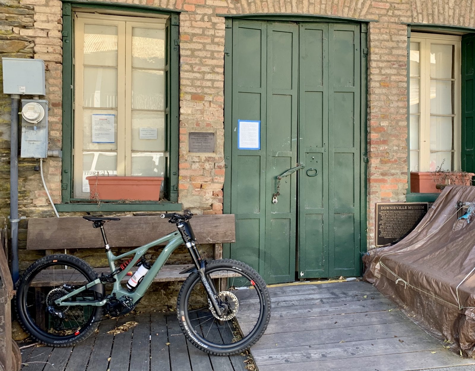

my Olive Kenevo is missing from the pic
The blue levo and black kenevo used to be mine
I helped my brother build his gunmetal enduro. You may notice he swaps the enves between the enduro and his now levo

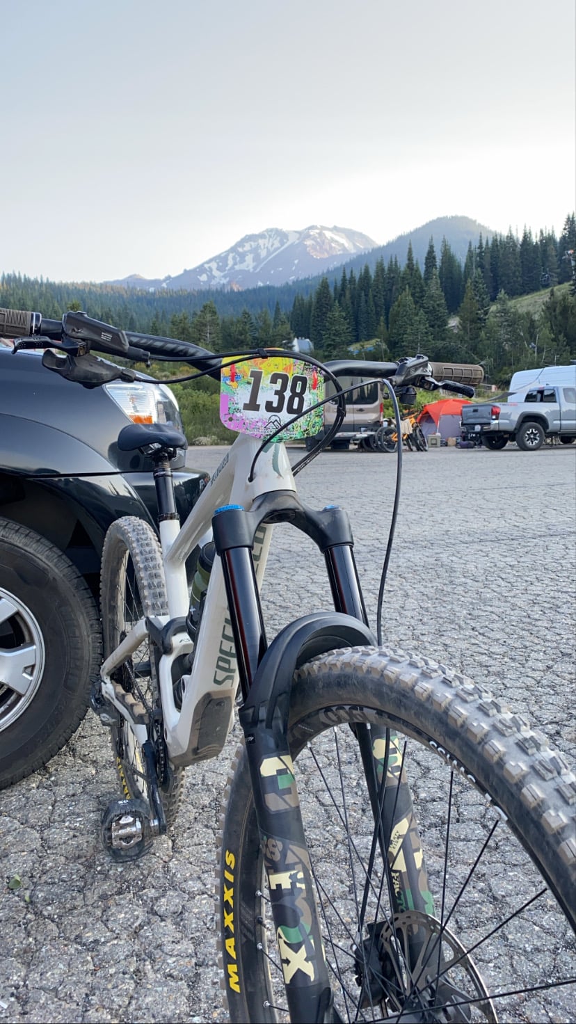

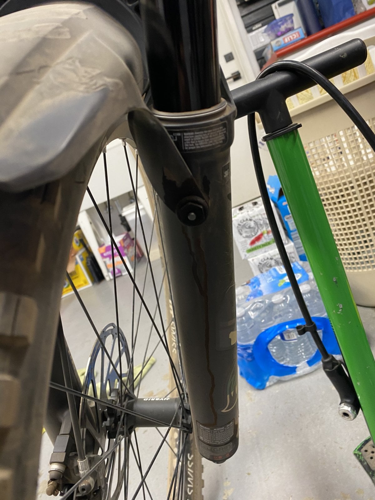

Yes, but check this out. When I rode up at high elevation both times the bleeder valves leaked oil residue from in between where the fork mounts and the bolt. For some reason with the fox fender I could not get it to seal properly with the stock o-ring. May try cutting away the lower leg connection and hope the tiny bolts that mount to the arch are sturdy enough to hold the fender. And if that doesn’t work I can always punch a hole and secure it with a zip tie I suppose.
rydeezie
Jul 26, 2020
609
862
san francisco, california
oh wow that’s not good
Especially when fluid can drip onto the brakes
Hopefully there’s a fix
Thanks for sharing that info
