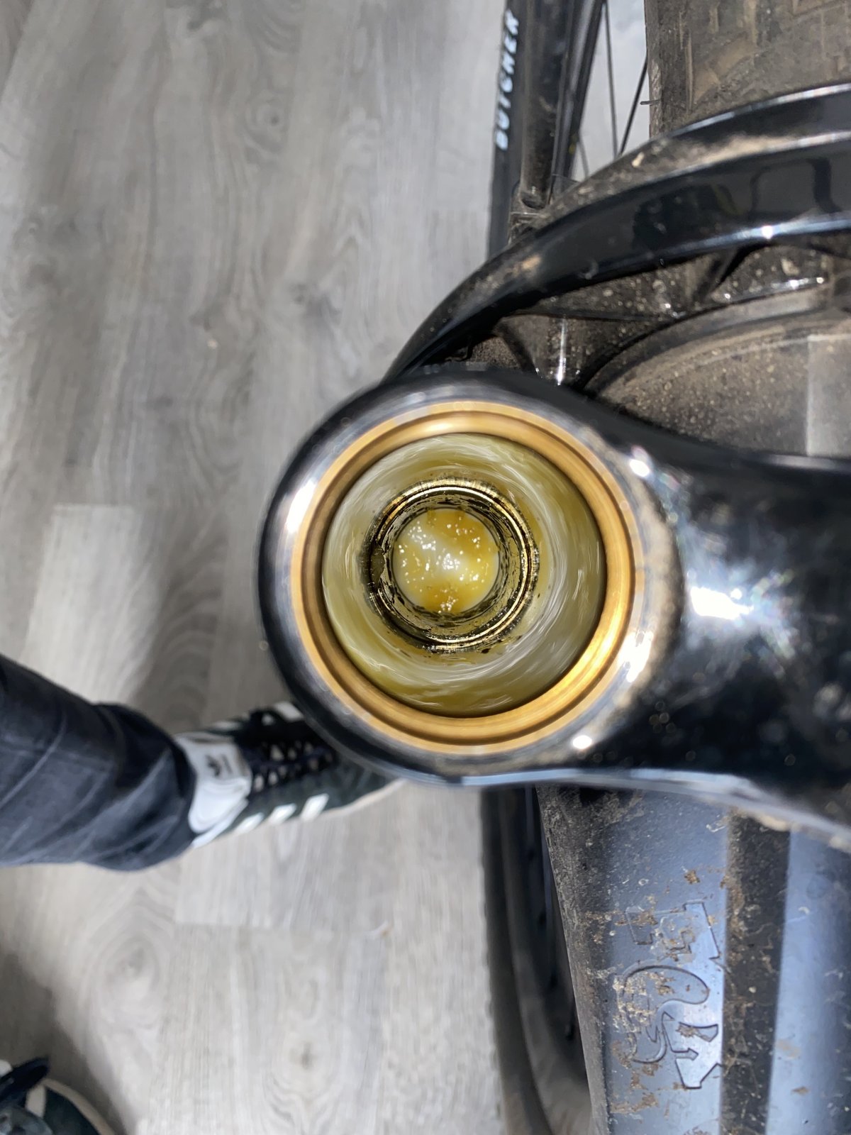

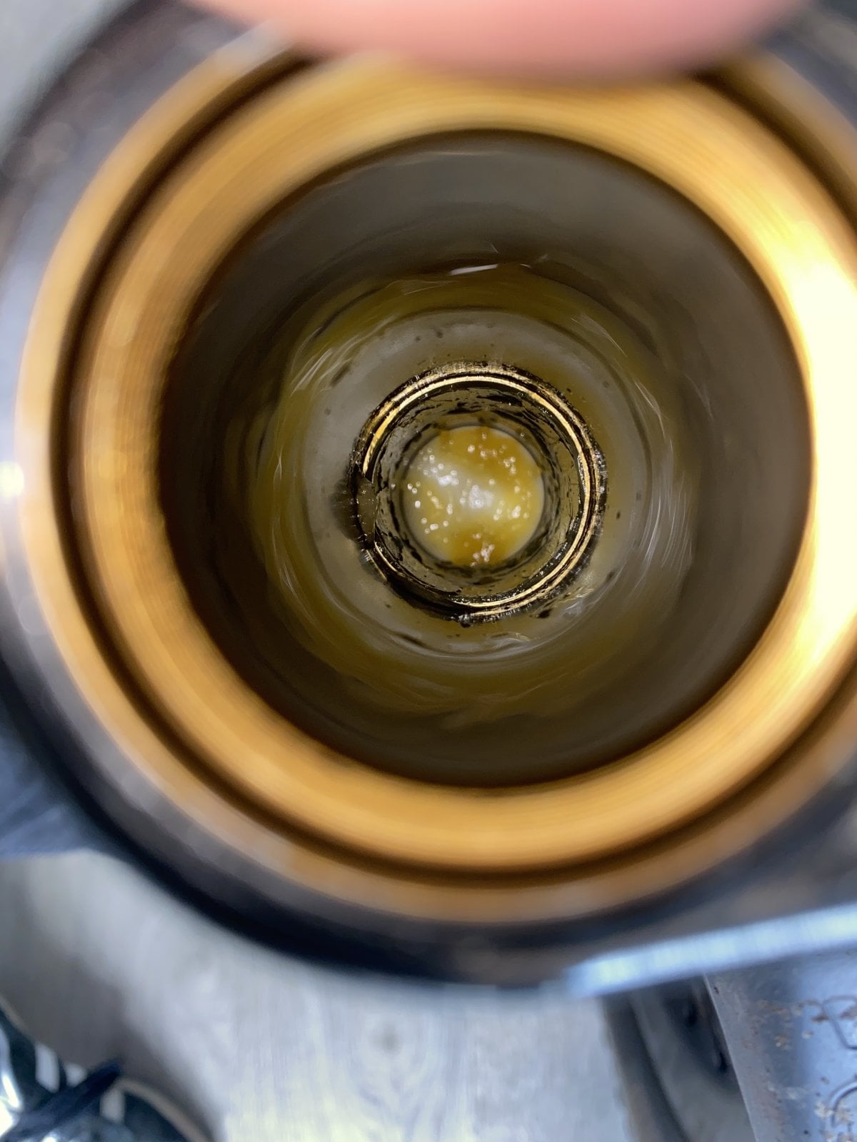

Fair amount of grease at the bottom of mine. Not sure how much is correct without reading tech manual.

It’s supposed to be a “thin film” per Fox. As others have noted, the real trouble is when it eats up the negative air spring volume.

You may find this video helpful -
Excess grease in the negative chamber takes up volume effectively
reducing the volume of the negative chamber, this causes the harsh feeling of the 38's
