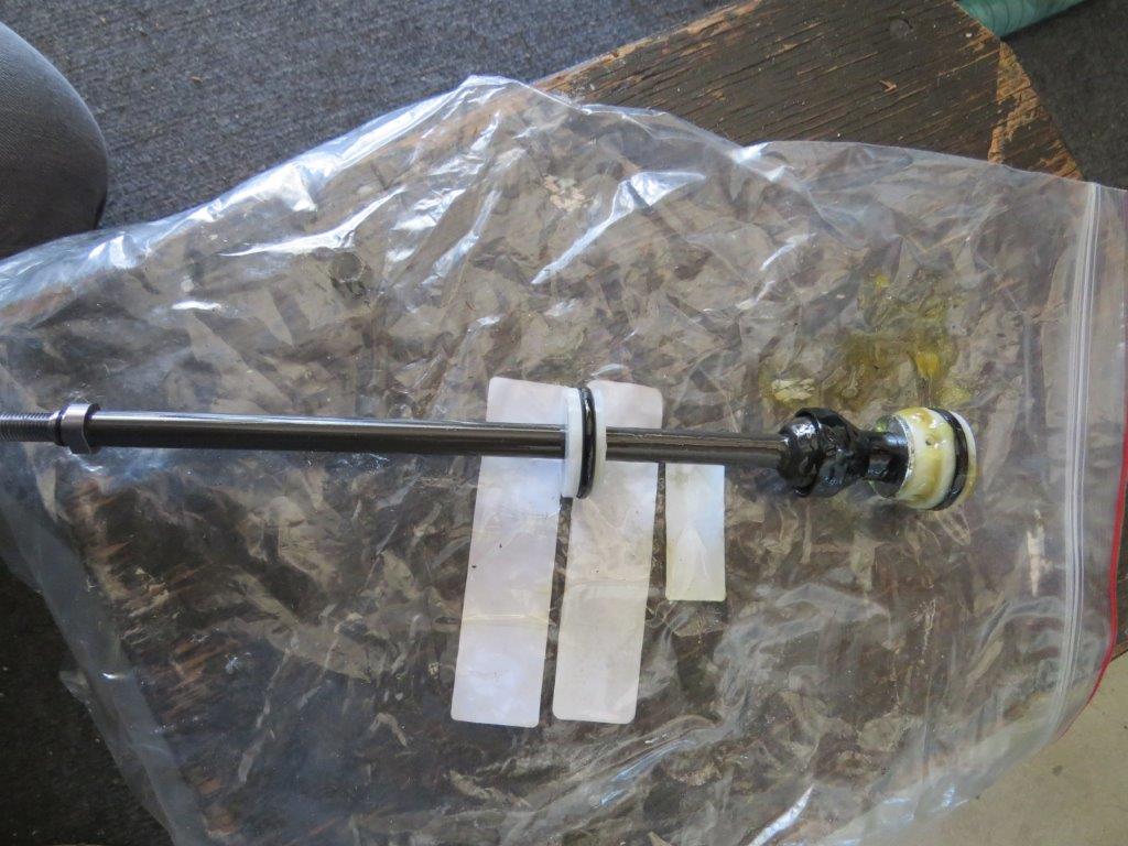

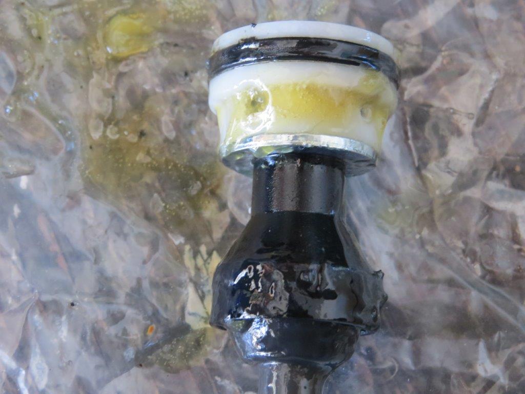

I made two mistakes when replacing my air shaft on my 2018 Focus Jam2 C with Fox Rhythm 34. I wanted to increase the travel to 150 mm and use a 29" wheel. As flexible as this fork is I decided to go back to 140 mm to try to minimize flex. I'm also unsure as to if this version is OK with 150 mm. I used it that way for months without any apparent issues.
The other mistake is to try to duplicate the huge amount of grease that the factory used on the end of the air shaft. That resulted in plugging all holes as shown in the picture. Months of riding like this did not unplug the holes so I've now cleaned it out and re-installed the stock 140 mm and I'm using one volume spacer. I weigh about 65 kg but still wish I had a higher end, stiffer front fork. No way to test any of this right now since all the trails are closed here in SoCal but someday soon I hope. Stay safe out there! View attachment 28580 View attachment 28581

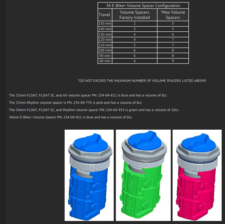

Hi
I am a little confused (quite easy I know), can someone please confirm the correct volume spacers and part number for the 2020 Jam2 6.8 Nine. The ID on my fork is DSDY.
Is the part number;
234-04-953 (green, 10cc) Fox Rythym 34 or
234-04-811 (blue, 8cc) Fox 34 e-bike+
I believe the forks on the bike are just the Fox 34 Rhythm not the 34 e-bike+ arent they? (If thats the case why would they put the e-bike specific forks?)
Thanks

Hi
Is the part number;
Thanks
It should be the green one. My 2018 came with one spacer and it was 140 mm travel. I did try the 150 mm air damper but from what I read the 27.5+/29" version of the Rhythm fork is supposed to be limited to 140 mm. I see that Focus did in fact put the 150 in this new bike so maybe it's OK. I just found that with sag set close to the spec, and with my weight I never came close to using all the travel. With about 50 psi and no volume spacer I do use most of it on harder rides so I'm close. I also found that the air damper is usually plugged with bunch of grease blocking most if not all of the holes. I'm not sure how that affects the performance but I did correct that.
Look up the 4 digit number on your fork on the Fox website. Mine is: DBLS
2018, 34, A, FLOAT, 29in, Rhythm, 140, Grip, Sweep-Adj, Matte Blk, No Logo, 15QRx110, 1.5 T, 51mm Rake, N/M OE

Hi
I found the 34 rhythm on my levo (150mm) is way way better since I added 2 more spacers and ran less pressure, better small bump response and only bottoms out on the hardest landing or decent size jumps.. im 100kg in kit.
for example, there is a section of trail I ride here that is all bedrock drop offs, around 2 - 2-1/2 feet onto loose stone over bedrock, its a fast section and I was bottoming the fork out every time I went down it. after adding the spacers it feels more plush, it feels like im using the same amount of travel but in fact I still usually have 20-30mm left and a much more stable ride.
from memory I have 95 psi in the fork
Hi Dobby, thanks for the info that's great. I am approx. 103kg in full riding kit so very similar.
Thanks again
PJ27
Jan 8, 2020
115
43
Thanks again for the info. Looking up the below information on my specific fork is where I get the slightly confused. The volume spacer details on the Fox website under my code gives information on all 32-34mm forks. The spacer details for the 34mm's provides both for the 34 and the 34 e-bike+ and the spacers are different. In the description to my fork code it says E-Bike (not ebike+). I suppose I could have a look inside as according to the website the 34 Rhythm do not have any factory fitted spacers and the e-Bike+ come with 2.
Do you need the the Fox Fork Top cap to open the fork?
I did look up my code: DSDY and it says;
2020, 34, A, FLOAT, 29in, Rhythm E-Bike, 150, Grip, Sweep-Adj, Matte Blk, No Logo, 15QRx110, 1.5 T, 51mm Rake, OE
I see you do have the 2020 version and it does say e-bike. But it's still a 34mm so I don't see why the 34mm green volume spacers would not work but I could be mistaken. I wonder if they beefed up the lower legs or the ID the 34mm tubes for e-bike use? If the later is true I could see where maybe the volume spacer might not fit.
I ran the front fork with shockwiz today and ended up with 4 clicks from fully closed for the rebound and 40 psi for my total rider weight of 160 lbs with gear. I started with 6 clicks and 50 psi. I'll probably go with 45 psi as a compromise since that is a lot of sag. Oh and no volume spacers is correct for me as I figured. Once I get my new DVO topaz shock I'll tune that and then tune the front forks again. I may even try 150 mm travel someday again.
This link might be helpful: FOX 34 e-bike optimised fork - what's different? Read our first impressions.
So if I read the article correctly, the ebike version is using the 32mm air damper because the id of the tubes is larger. So maybe a 32mm volume spacer is what you need as well. Oh you just need a 26mm socket to remove the air side cap. Just remember to let all of the air out first.
Thanks again for all your help and information - you are a LEGEND.
I opened up the front forks on the weekend and there was one spacer factory fitted and it was Green (10cc)!!!!!
Its a bit weird as in the table ( FORK- 2020 32mm/34mm | Bike Help Center | FOX ) for my shock code DSDY doesn't line up. The table advises for the 34mm Rhythm 150mm travel there are 0 factory fitted spacers and for the 34 e-bike+ (which mine is marked) there should be 2 Blue spacers (8cc). What would the difference be? Should I order Blue and swap out the green or just stick with green?
I wish things were simple!
I think if the green ones fit and you need more just order the green ones. According to Fox that ebike 34mm ID should be smaller and takes the air shaft for the 32mm fork because of that. So I would have thought the green volume spacers would not fit either but apparently they do so just go with those. If you are bottoming out with the right sag set, add another volume spacer. You could try to contact Fox to get better information about your fork. I did learn that my fork should be OK with the 150mm air shaft so I might just put it back on.
Thanks again for your help and reply. Maybe both the blue and green will work!! Will probable get the green.
I sent Fox an email 12 days again and a follow-up 5 days ago with no reply!
