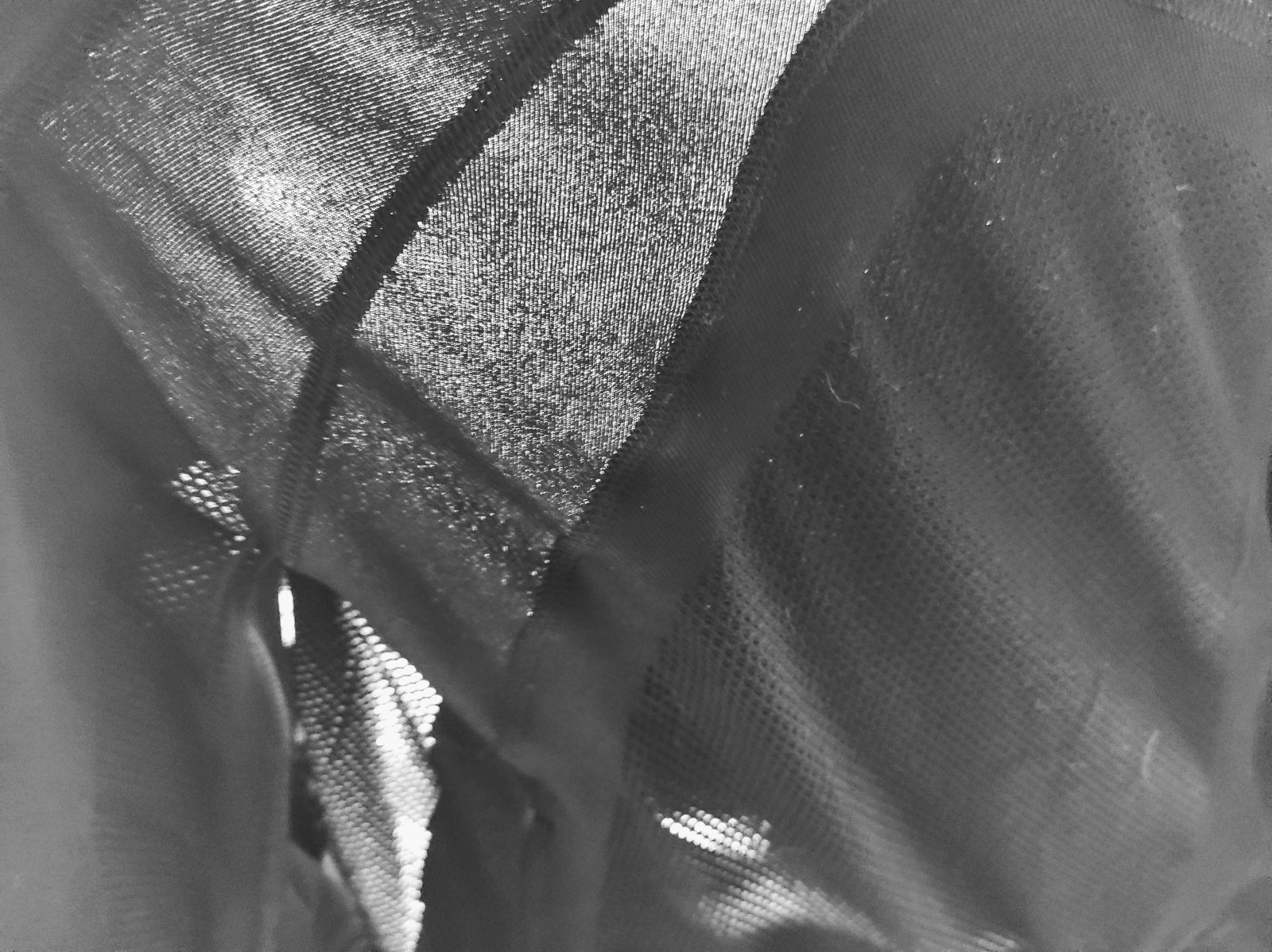

So, the shirt. The fabric is called "BeCool". It very light weight and VERY stretchy. Some areas are perforated further into a mesh.
Fit wise, I'm generally a medium in most armours and slip into large for a few brands. For the Pro shirt I was at the top of small and bottom of medium so went small. If anything it's slightly too large, though only because I'm used to the tighter fitting from the other armours. The arm length is very generous (with thumb holes), I normally find arms slightly short. Personally, I'd have preferred the arms to be a slightly tighter fit, though everything seems to stay in place when you're riding, I'm not sure they'd stay in place when you crash. Again, it's not as tight fitting as others.
The Zip seems reasonable quality. Not as top end as the Racer Motion 2, but better than most of the others.
On overall design and fit, the Racer Motion 2 is easily the winner out of everything I've tried. The Forcefield is weirdly comfortable, but it doesn't feel like a second skin like the Racer Motion 2 top. I'll certainly be crash testing it over the next few weeks, so I'll know more then on how feels when abused.
Comfort. The armour slowly heat moulds to your body. The limb armour is different to the body armour and seems to take longer to mould. This improves with each wearing. The Elbow guards initially felt very rattly on my skinny elbows, but then started for form up. I hoped this process would continue, but they never settled into a shape which sat perfectly round my elbow and forearm. The back and chest feel like they "float" slightly above your skin. I can't completely explain this, it just doesn't feel quite as stuck to you as the other armours do even though it completely moulds to the shape of your body.
The main armour is reasonably well vented. I have heard that if you freeze it, you can drill more air holes for additional ventilation, as long as you maintain 25mm of armour between any perforations to maintain structural integrity/effectiveness. I've not tried this yet !
The stitching is strong and where the stitch pattern is raised, this is on the outside of the garment, not the inside, so it's not abrasive (you should try this alpinestars).
It's armour, so it has some bulk compared to no armour ! The chest especially. Strangely, once you have it on, you don't actually notice it, I think because it's so light. If you don't want anyone to know you have armour on, the CE2 version of this is probably not for you, especially if you're small built - it puts 15kg's on your look. If you're larger, it would proportionally blend in more.
Riding, it generally seems to all stay in place and doesn't feel at all restrictive. It's light weight which is nice. Ultimately, for me, the elbows don't form up/heat shape well enough, so whilst they're cooler not sitting against the skin, it's questionable if they'd stay in place in a crash. Similarly, because the fabric has so much give, there's a chance the shoulders might not stay around your deltoids in a crash and could leave you exposed.
Weight wise, remember this is a full CE2 armour shirt and it weighs in at 1250g - the same as a Leatt Airfit Light !

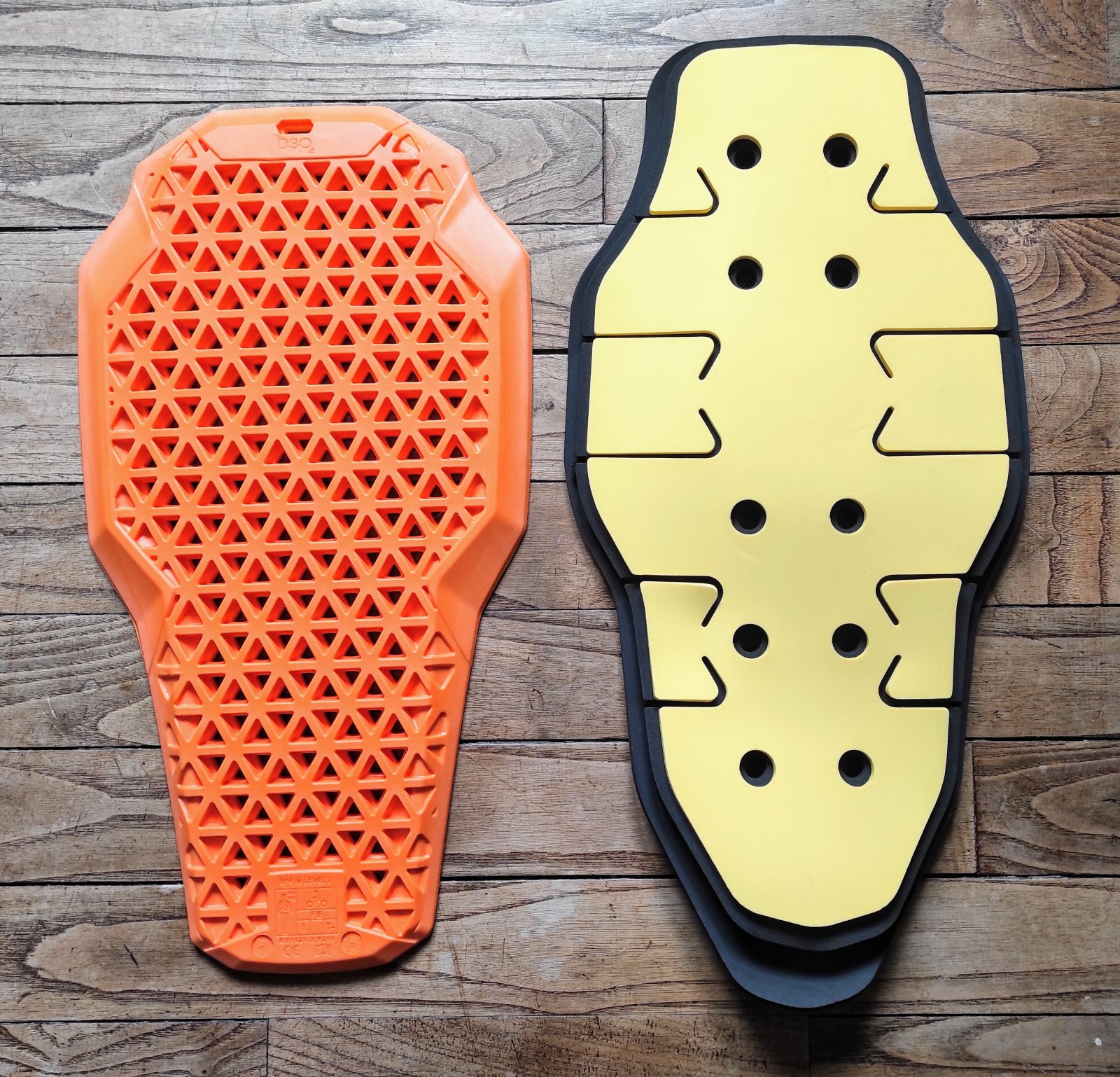

On the left a Medium D30 CE1 BP4 back protector. On the right a Small CE2 Forcefield back protector. The small Forcefield gives more coverage than the Medium D3O BP4 - though the D3O BP4 does give good back coverage compared to most other reactive armours.
And the inside views :
The Forcefield armour is also lighter. The D3O is 333g , the Forcefield 324g !

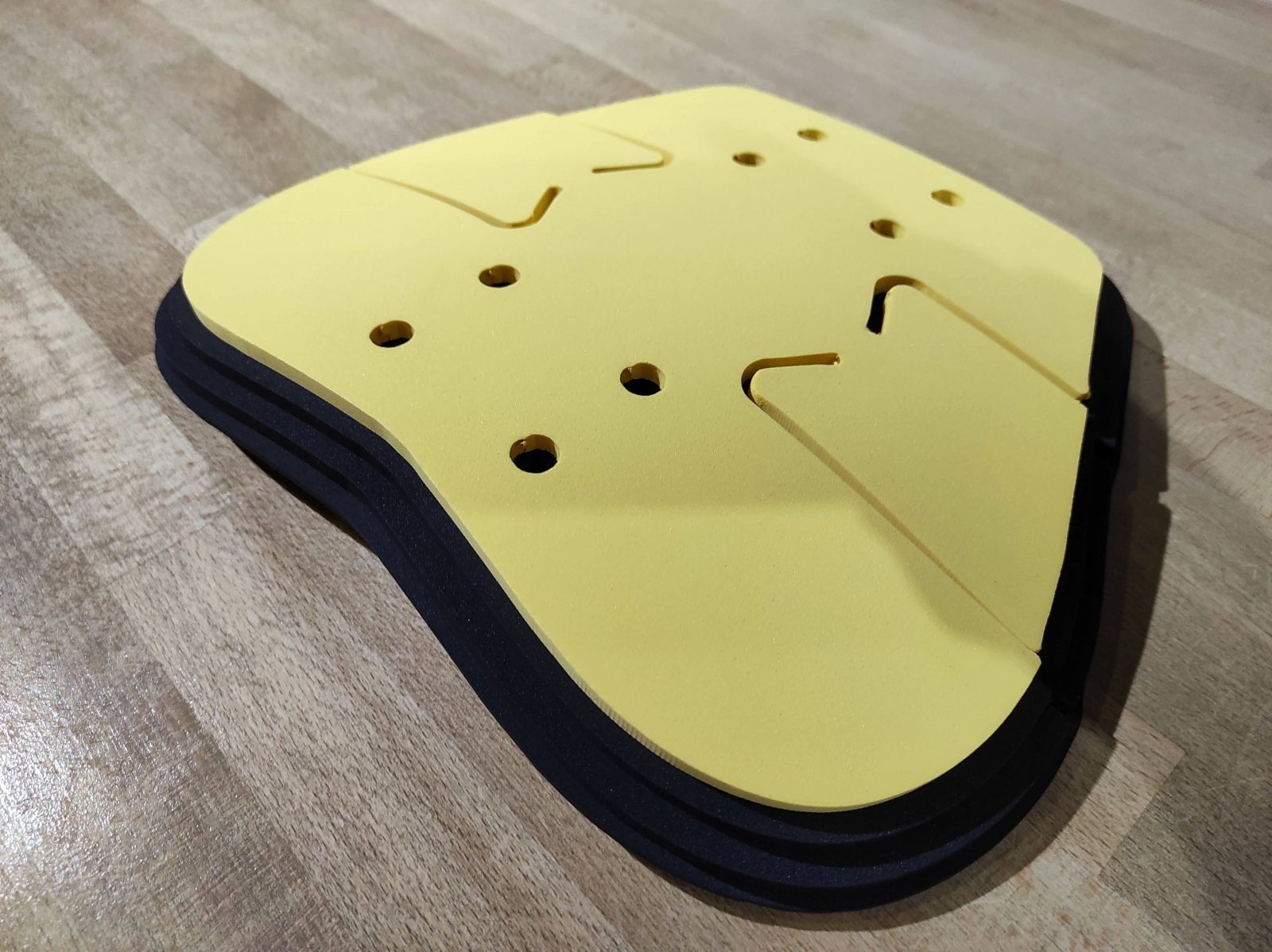

The chest protector : Just after a ride, so you can see it's still slightly curved and hasn't settled fully flat yet - if you leave it hanging up, it maintains the shape from wearing it.
Armour thickness : As mentioned it's not skinny. The Forcefield chest and back armour is about 22m thick. CE1 D3O is 16mm and CE2 D3O is also about 22mm. I don't have the CE1 Forcefield armour, but I'd guess it's similar thickness to the CE1 D3O.
The Forcefield armour is made up of 4 layers, presumably you could peel a layer off if you felt it was too thick - at the expense of some protection.

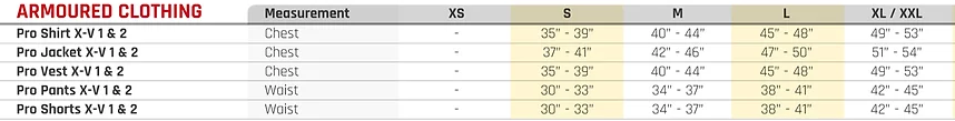

Sizing :
More sizing and in CM's from the website :
