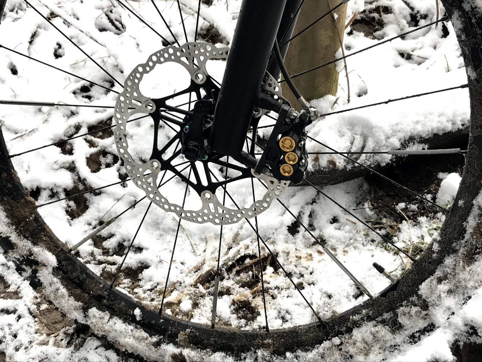

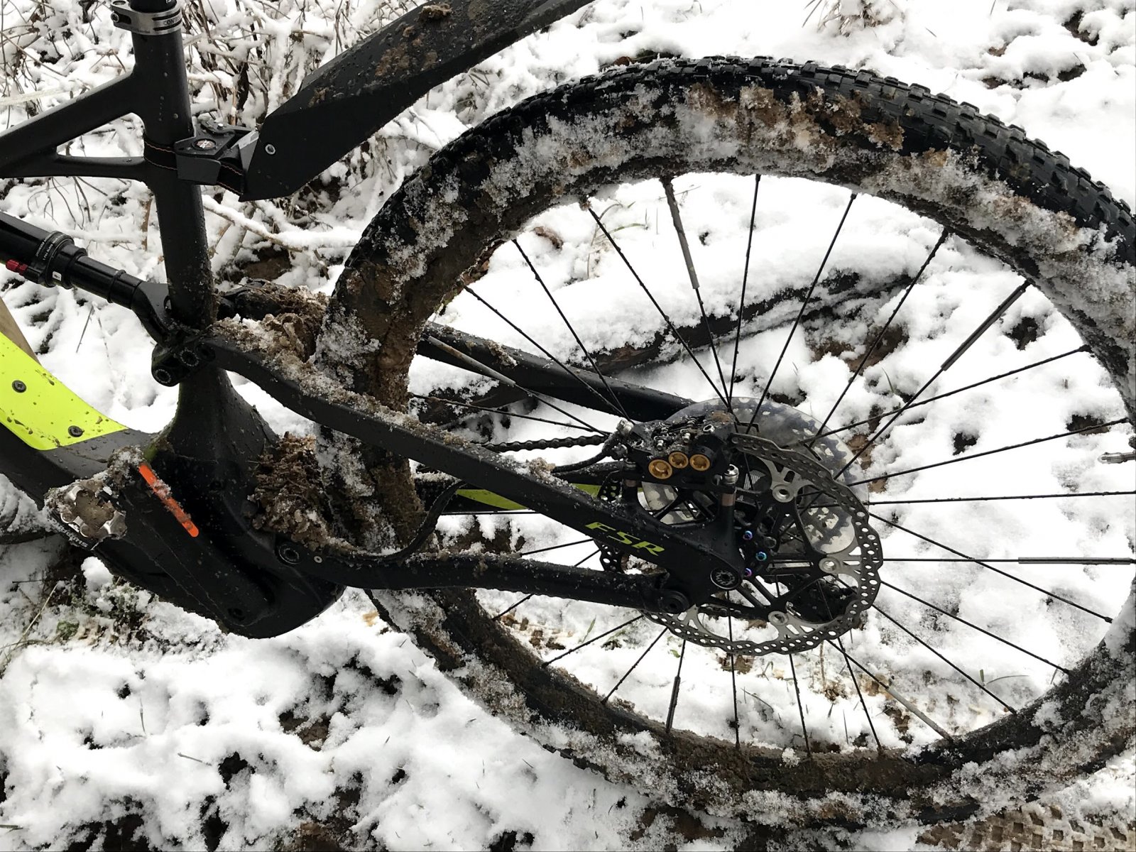

Hi,
this is the Setup i've been using for the last 5k Kilometers. Its an Hope Tech3 Mono 6 ti running on Bionol Brake Fluid and 223 Discs.
Very dependable and controlable Power.

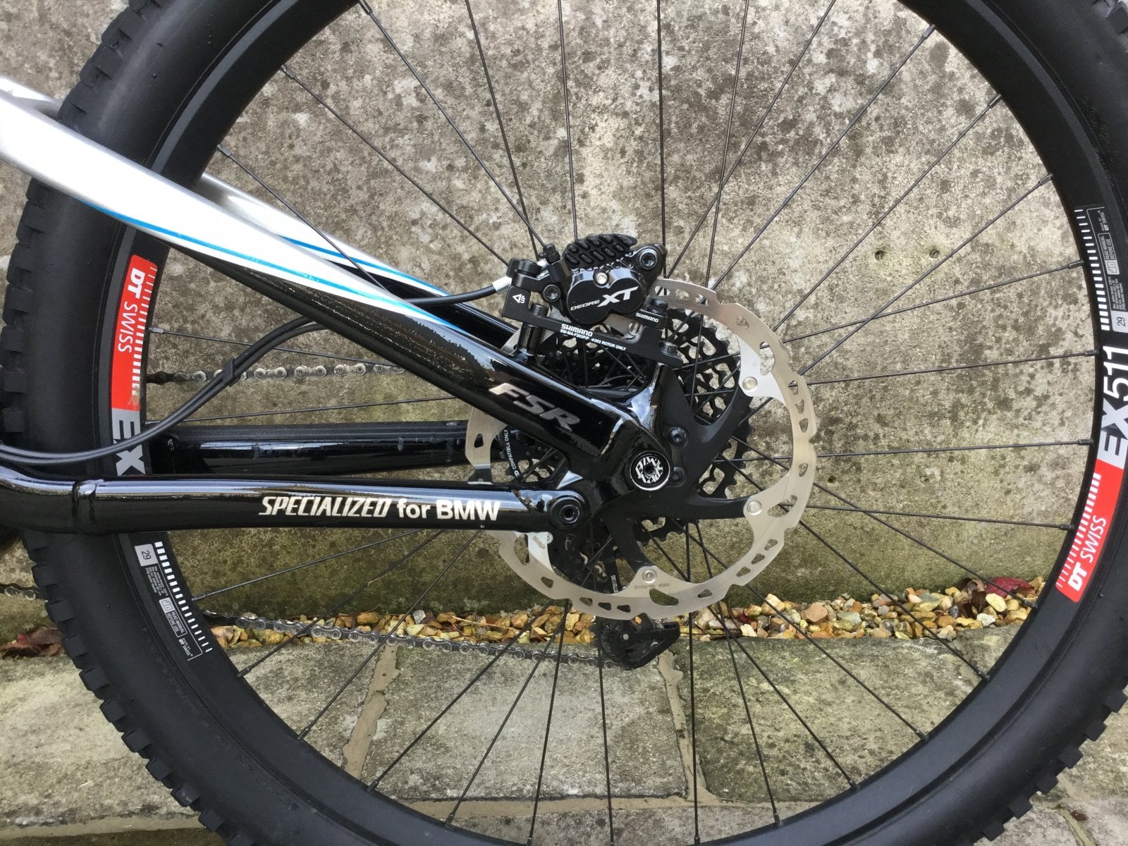

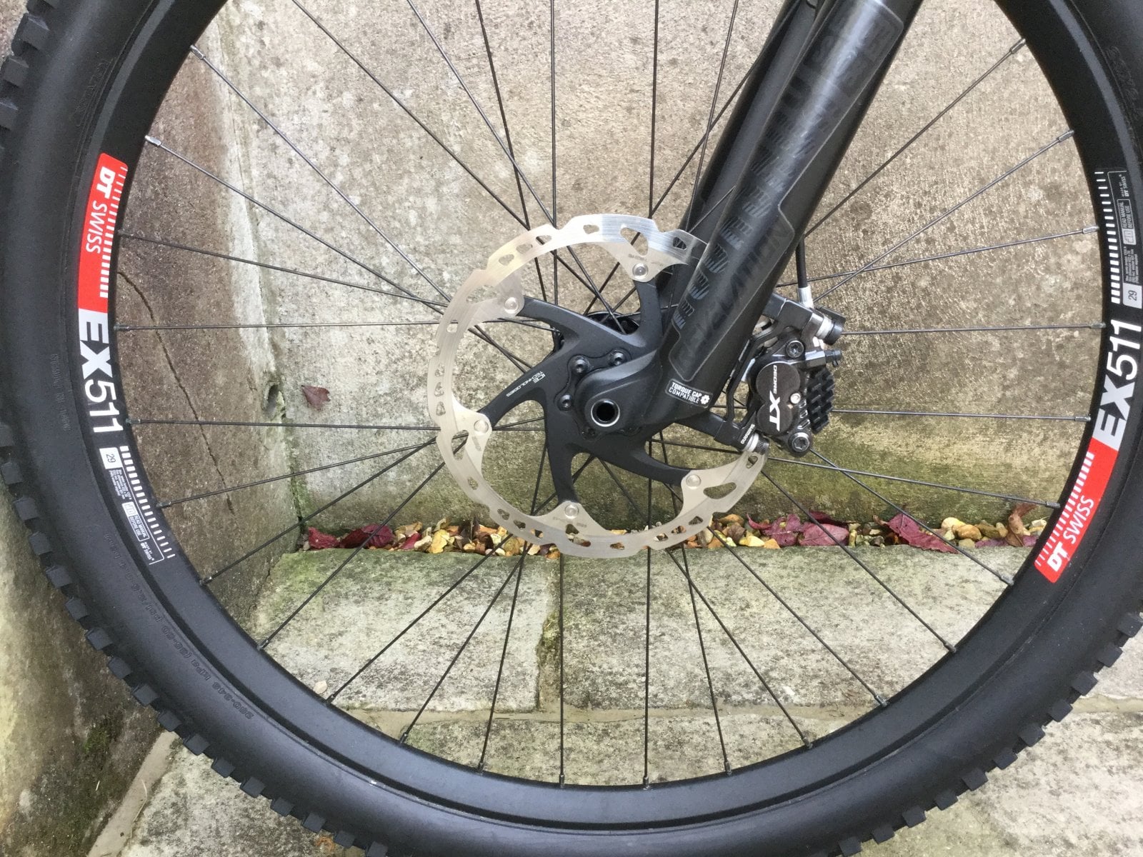

Hi As ccrdave said, I also upgraded to XT four pot.
I went the 203mm rotor so used Shimano adapters. As far as rerouting, apart from disconnecting the hose from the rear lever to reroute through the frame all I had to do extra was take the battery out upper left motor cover and one securing clip on the swing arm. After shortening the hose, reconnecting to lever, all that was required was a lever bleed.
View attachment 8942 View attachment 8943
Could you post the part numbers for the Shimano adapters you used on the front and rear. I love this setup.

Hi jxj, the Shimano adapters are, front - SMMA90F203PPM and rear - SMMAF203PP. Readily available I got mine from SJS cycles and they came complete with bolts, spacers and washers. Hope this helps.

I believe so my levo is a 18 comp with alloy rear triangle and revelation forks and 180 post mounts. The only reason for ditching the standard adapters is I went 203mm rotors from 200mm. As others have stated you could use 1.5mm washers to achieve the same result. I just wanted to do the job neatly.

Hi,
I’m all about 4 piston shimano brakes but those 6 piston hopes seem like they might make a lot of sense on an emtb. I don’t see many 6 pistons on peoples bikes or the interwebz. I’d really like to try them, and the floating rotors. Might have to buy a ten pack of brake pads to keep stock. I can’t see many shops, local or online, keeping stock

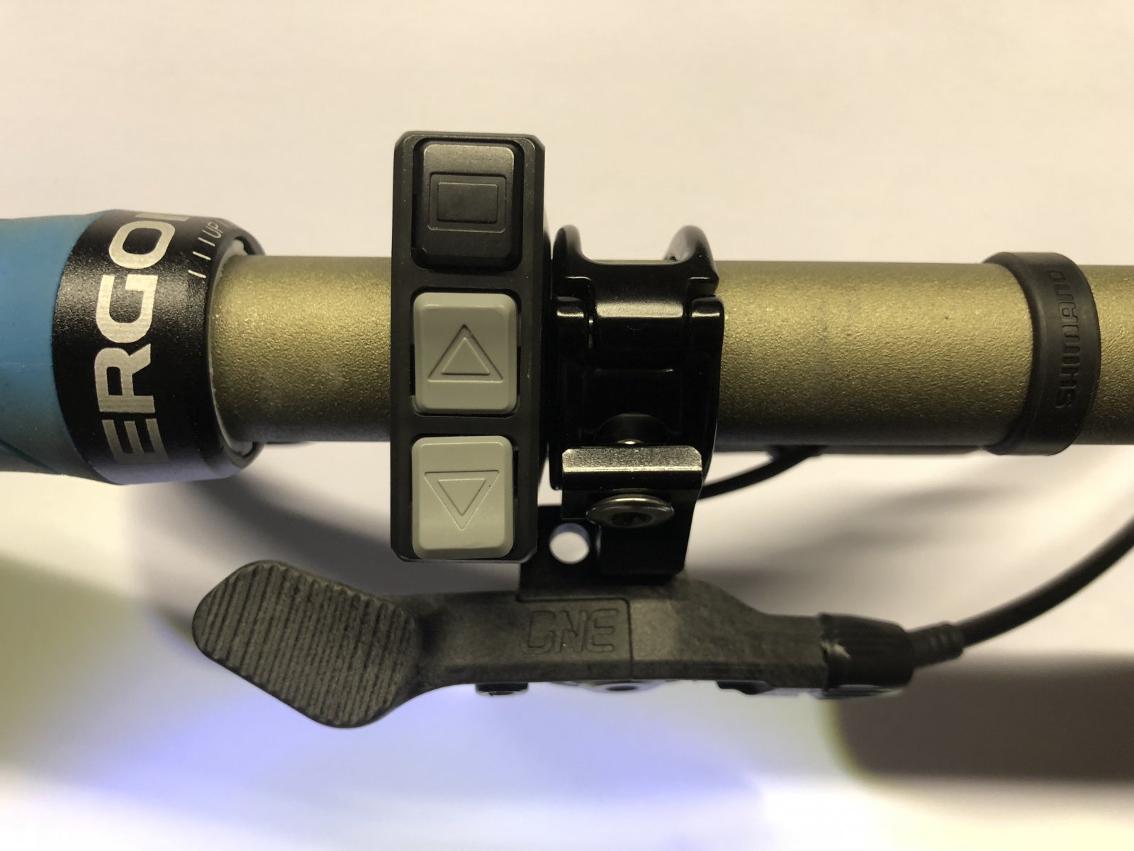

junglie69, or others that have managed this upgrade to Shimano brakes how did you handle the cockpit lever mounting? Mixing the dropper post and the Sram shifter looks problematic as I look at the mounting arrangements. I'm betting there is a simple solution. Pardon my ignorance, I'm a fair mechanic but am a roadie by background and haven't done that much work on MTB or mixed mfgr setups on any bikes. Thanks for the support.
9,190
Both Shimano and Sram have systems for mountain the dropper lever/shifters to the brake lever clamp.
Most dropper lever manufacturers offer specific mounts for utilising the brake clamp.
Third party companies, such as Problem Solvers offer solutions for mixing Sram/Shimano products onto one mount
Products | Problem Solvers
9,190
In this pic I have a One Up dropper remote mounted using an MMX adapter to my SRAM Guide RE brakes

Looks real nice. I'm with shimano XT 8000 levers now, just had too many problems with the Guide REs thus the mixed shimano lever with Sram shifter and the stock "Command" dropper (second command dropper as the first failed on the test ride and this 2nd one is not great)
9,190
If you want to tidy up the cockpit I would suggest buying a third party dropper lever, such as a Wolftooth, PNW Loam Lever, or One Up lever, which can be bought with the applicable compatible mount for the Shimano levers.
With the SRAM shifters you are looking at getting one of the Problem Solvers adapters if you want to piggyback the shifter on to the Shimano levers.
