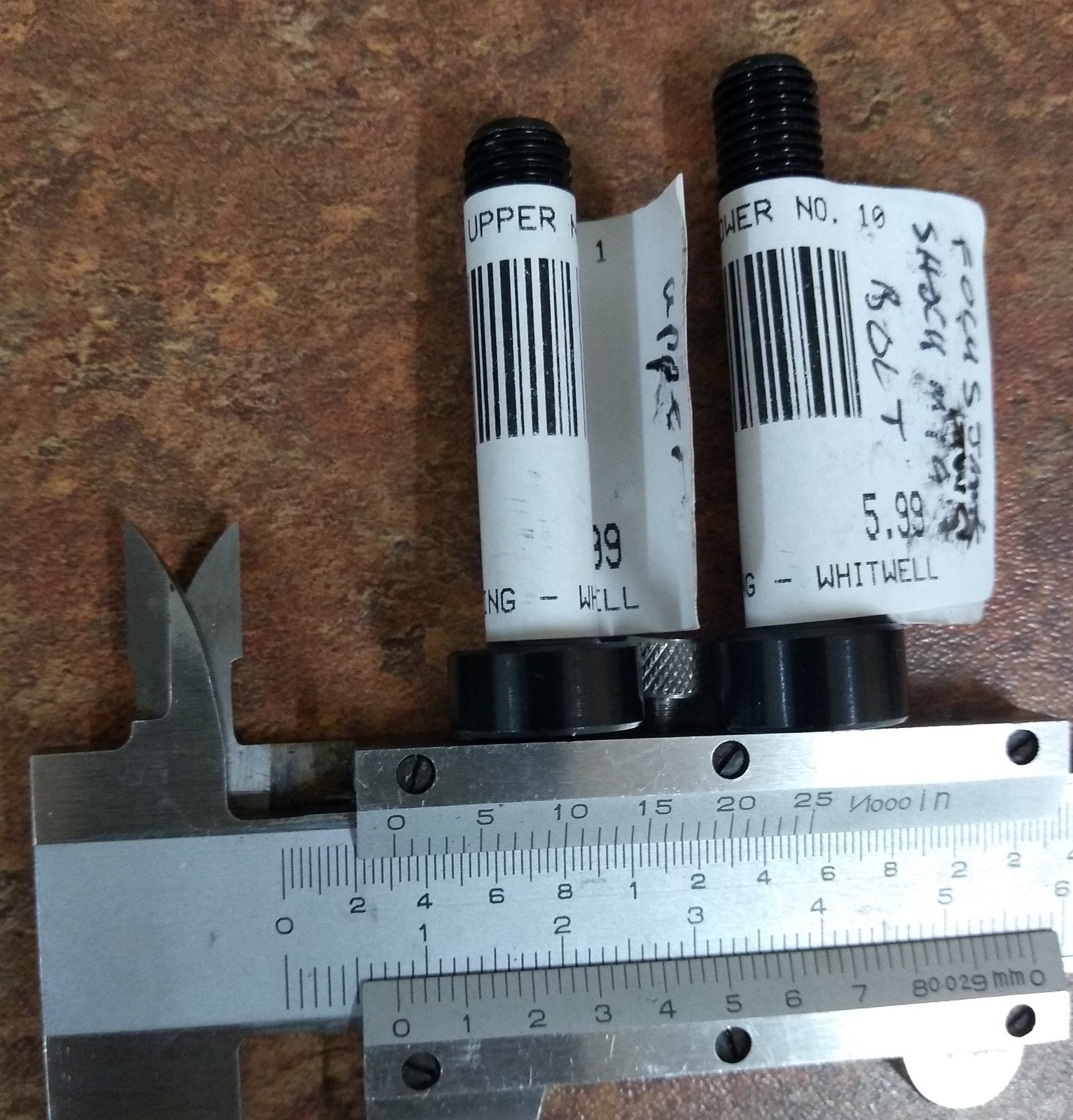

Any dealer selling Focus will be able to help. The bolts come in packs of two and cost about £6. Check whether or not the same bolts are used top and bottom before ordering. (I don't have a Sam2, I have the Jam2).
I got mine from Rutland Cycling at Whitwell. 01780 460705
I would change the bolts asap. As soon as one of the loose bits comes out the frame will start to get damaged (if it isn't already).
To remove the threaded end, use a small diameter drill bit and drill into the end of the bolt. The torque should loosen the bolt and wind it out. Let the back of the bike hang in the air for this to remove pressure on the bolt.
PS: My problem had been the bolt coming loose, so I used threadlock upon reassembly. Loctite blue was fine.

Cheers Steve for reply and advice. I’ve contacted Rutland so will hopefully hear from them in the next few days. If not I will try Telemarker’s suggestion. Attached is picture of the bolt. i am surprised as to how soft the material of the bolt is. Appreciate it’s probably a sacrificial part and the role it plays is to just nip the shock bushes up but you would think it would be made from at least low grade steel so that it lasts a bit longer. The wear at the head end is plain to see.

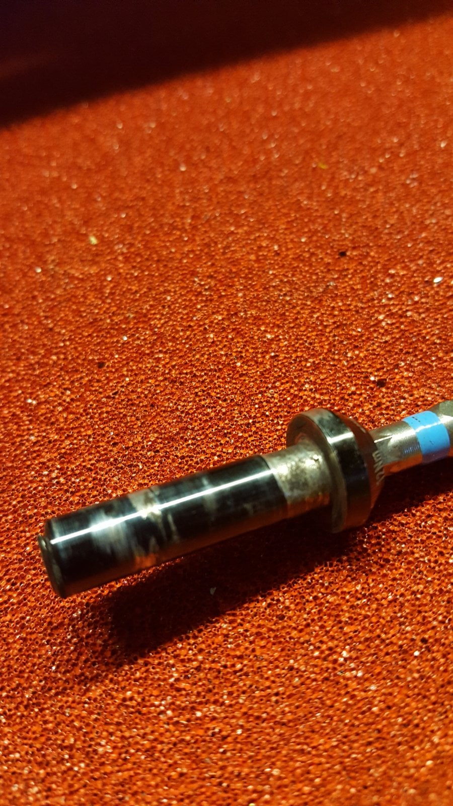

That’s what my shock bolt looked like after snapping.
I reckoned the excessive wear near bolt head happened AFTER the bolt snapped because I didn’t notice until end of ride that there was play in system,
My take on what happens is, the pivoting doesn’t happen at the eyelet bushing but at shock bolt/mounting hardware sleeve, this leads to friction wear on the bolt and loosens it. Then the bolt may snap if it gets too loose.
You can see the wear in the middle area of bolt, that’s what I have seen on new bolts I have fitted... it shouldn’t happen, the movement should be in the eyelet bushing.

Yeah see what you mean. Makes sense. I’m tempted to use a M8 x 40mm socket head shouldered bolt whilst waiting for the replacement. The bolt will be high tensile so transfer any wear into the eyelet bushing maybe?? ... I’ll wait to get a reply on delivery times first then decide what the best way forward is. Cheers for advice.

I have a 2020 Jam 6.8 so will need to check this. It looks like the wear on the bolt, at he head end has been caused over time?, so may have elongated the hole slightly in the linkage. If so, it won’t be a snug fit, so replacing just the bolt, may not rectify the issue. Might need a new linkage. It’s worth checking. Keep us updated in the thread. ??

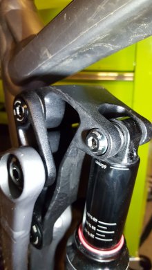

I have checked the linkage and fortunately the 8mm dia hole is concentric and has no wear . The bushing in the top of the shock and spacers are also not affected so the replacement bolt should cure the issue. However.... Whitwell Bikes (Rutland Cycles) have not been very helpful. They quoted me the part number but cannot locate one from abroad. But the strange email reply I received was that a competitor did have stock but would not quote who the competitor was.... very strange behaviour and for a bolt that costs £5.99.
I’m not happy with Rutland to be honest. I have just bought a 2nd Focus Ebike from them in January and had I known they would be so coy over a £5.99 bolt I would have given £2500 of business to someone else. Anyway i will try another Focus supplier to locate the bolt or may still go for the M8 std cap head. Will keep the thread updated.

The issue could be caused by incorrect assembly? Clearly the linkage and bolt should move as one such that the bolt rotates within the bushing. That means the head of the bolt/ linkage should be free of grease, the central area of the bolt which sits in the bushing should be greased, and the thread should be thread locked. Then the bolt torqued to spec. I know the bottom bolt on my Levo has a pretty high torque setting of nearly 24 nm. Note..do not apply grease to the bushing because that will be picked up by the threads as you push the bolt through. Loctite needs to left for 24 hours to set before use.

I got my bike from sprockets in Kilmarnock. Try them, there really helpful & have good knowledge of the products they sell. Can’t understand Rutland cycles being like that. They have nothing to gain & more to lose. Why don’t they get the bolt off the 3rd party put a couple of quid on if need be & have done with it. ??. All the best with getting sorted.

........However.... Whitwell Bikes (Rutland Cycles) have not been very helpful. They quoted me the part number but cannot locate one from abroad. But the strange email reply I received was that a competitor did have stock but would not quote who the competitor was.... very strange behaviour and for a bolt that costs £5.99.

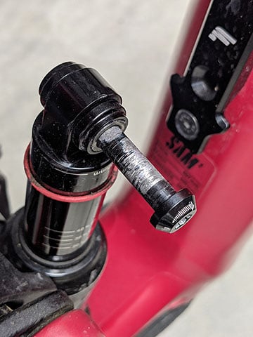

Had a nasty squeak when compressing the rear suspension that did not know where it came from and saw this thread...
Not broken but only a matter of time. After cleaning and greasing it stopped making noise but I don't trust it. I'll order a set but this will happen again. It would be great to find a long-term solution (small bearings?)

looks like you might have caught this just in time. I would get a replacement bolt before it fails. Not sure about smaller bearings but you can replace the shock bushings to return it back to its original state. The centre sleeve in the shock may have wear so will not help just refitting the bolt. The sleeve and bushings are not too expensive. Hope this helps

The bolt shouldnt be getting any wear, I have never had shock bolt wear on other suspension bikes. The rotation and wear should occur between the shock eyelet bushing and the sleeve/tube the bolt goes through.
But on these focus bikes seems rotations and wear also occur so between the bolt and metal sleeve/tube....
Not sure how to stop this happening
I have bought fox roller needle bearing unit from BETD but not fitted it yet
