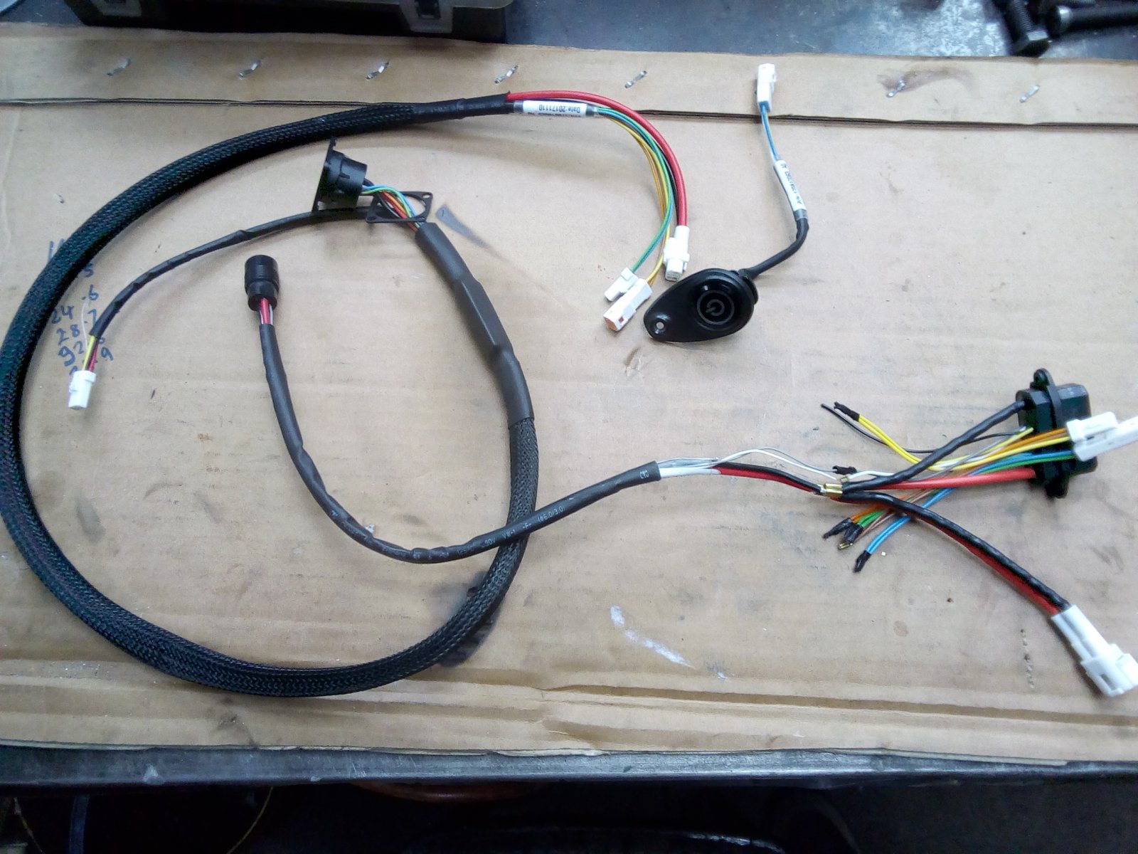

Very interesting to see the wiring loom like that Russ. Thanks for sharing. I was wondering if any of you guys experience the blue power light randomly glowing when lifting or turning the bike? The light also lights up when washing the bike. Strange behaviour if you ask me.
Yes, all of those things happen with the three we have over here. The blue light glows brightest when wheeling the bike backward!
I had a similar behaviour. I had the problem that I would turn the bike off, and the light would turn on and off every few seconds and just continue doing it.
That was after another problem I had where I could occasionally not turn my bike on if I turned it off. And then when I shook the bike, the light would glow for a while.
I have a video of it doing that.

Does anyone have a schematic of the Jam2 Shimano cables?
In the first pictures I recognize the swhitch and the charging port, but I don't know where the other connectors are pluged (motor controller, battery, display, ...). Tis would help if we have to solve some issue.
Thank you

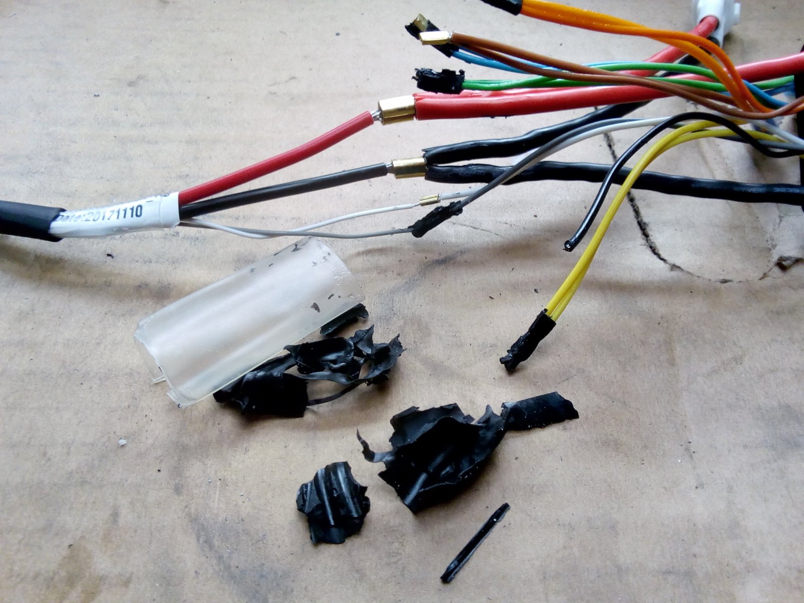

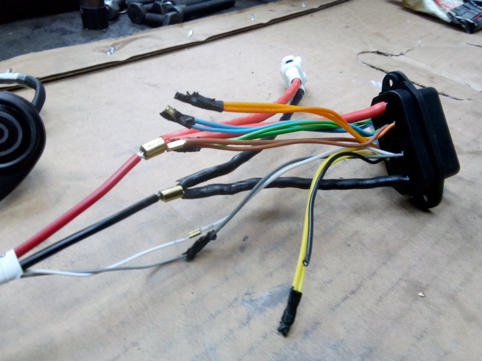

Removed the complete wiring harness from the jam last night to check for continuity of the various wires , I had to satisfy myself that no fault existed with the loom it's self, all check out ok.
However, all the wiring that comes out of the battery about 3" latter disappears into a black rubbery lump of silicone like material.
I picked all this apart, my biggest surprise here was nothing is soldered together, only crimped.
The thin wiring joints had heat shrink insulation , very good, but the heavy black and red cables ( the main current carrying cables !)
have no insulation!! Only separated by the silicon like material. Fair enough the are not touching , l would soon be aware of it if they did!!,
It's hardly a well executed design?
I'm just pedantic when it comes to doing things properly .
Henry Royce (one half of Rolls Royce) once said "whatever is rightly done, however humble, is noble"
Russ. View attachment 10954 View attachment 10955 View attachment 10956
Any idea what the black cable in the third picture does ?
