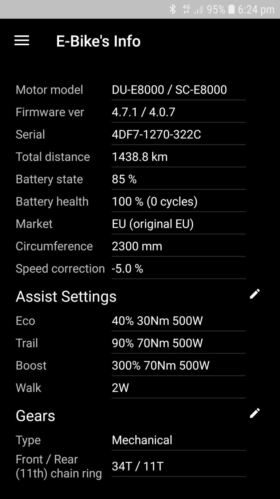

Anyone used the basic st unlocker to show the battery state and charge cycles on their Focus ebikes?
I just have to try and see the state of the internal battery and it's showing up like this
As you can see it's showing battery health at 100% and 0 cycles which is obviously wrong. I've had the bike 2 years and done over 3000miles on it so it's had plenty of charges. Mileage is showing different because I'm on a second motor which was swapped a year ago.
Has anyone else found this not reading the correct health? I'm thinking it's because the batteries are focuses own battery and not Shimanos !!!!

I have a Focus Bold2, ride it for a year now, and it shows the same Battery Health Status.
Theres another thread that explains it is because of Focus own Battery.

Can I ask you what the Speed Correction -5.0 does?
And the Eco on 40%? Do you get a bigger Range with that setting?
-5.0 is for the speed accuracy reading, makes it more like my GPS Garmin Speedo reading as my bike was always reading about 1mph faster that the Garmin.
40% on eco is putting eco in medium setting so will give a little extra range, just have to pedal a little harder

I believe it only reads the correct amount of cycles and health etc if you have the official shimano battery. I don't know what's in your focus but I have a simplo battery in my norco and it shows the same as yours.
Cheers for that, mine is a derby cycles (Focus) Battery so that's why it won't read it. I'm led to believe that no dealers have the software to read s focus battery

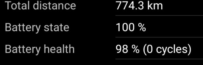

Hey Guys, funny thing happend today after loading Battery (Bike: Focus Bold2) I checked with the ST Unlocker and IT showed me this. Three Days ago Battery Health was at 100%

Just had mine on charge again and it will only got to 91% charge, just need to find out if this is anacceptable amount of battery degrading after 2 years and 3200miles
