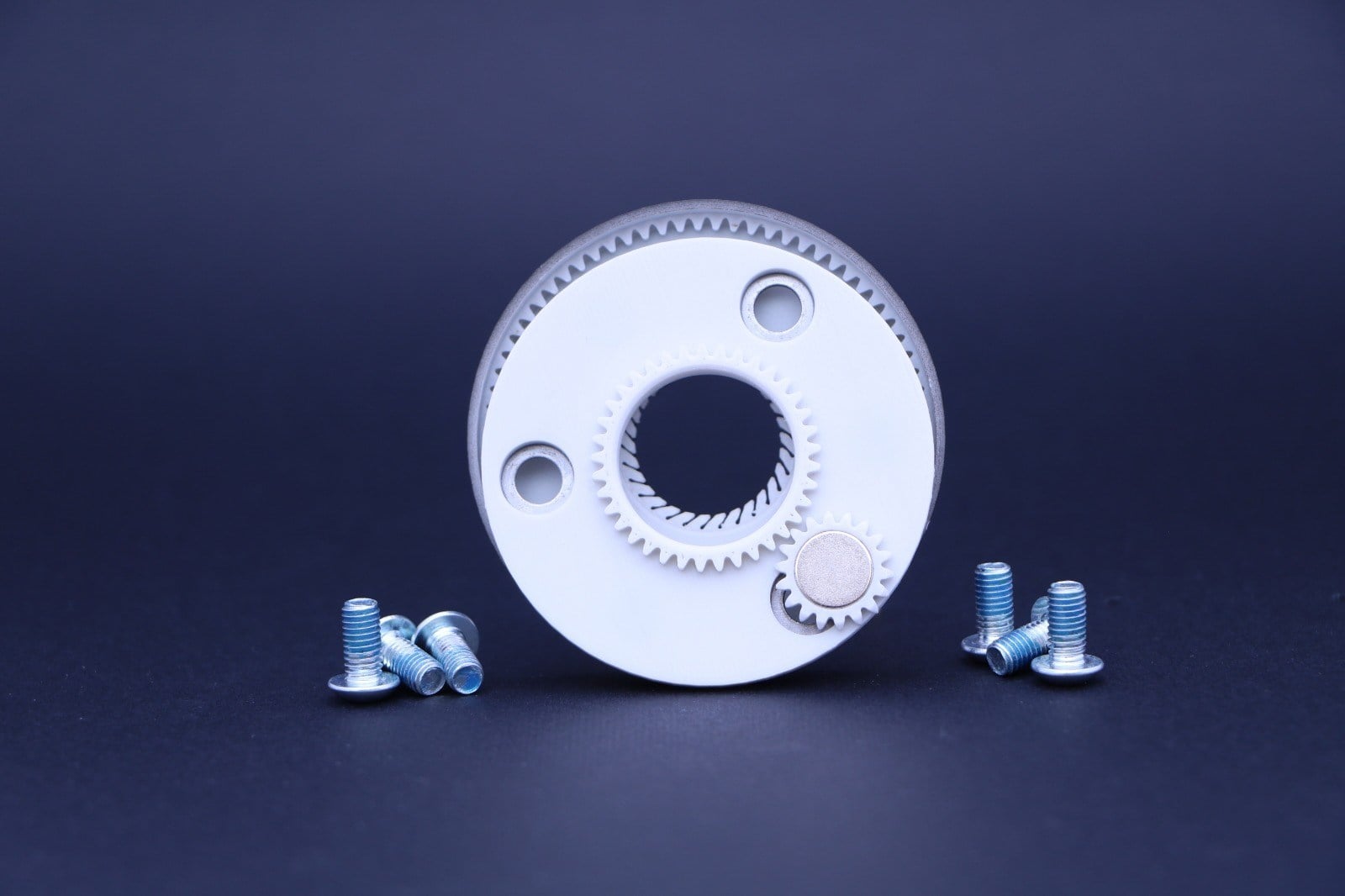

It mounts to the rear wheel and makes the bikes computer think its only going one half of your actual speed. So instead of assist stopping at 15 mph it will go to 30 mph before assist stops.
Be careful when using these sorts of methods to trick the e8000. The e8000 and other lower spec models can detect manipulation using these methods and may throw error codes that in some cases cannot be cleared. The E5000 in particular...there are documented methods to reset some codes but they will not always work (firmware dependent)
