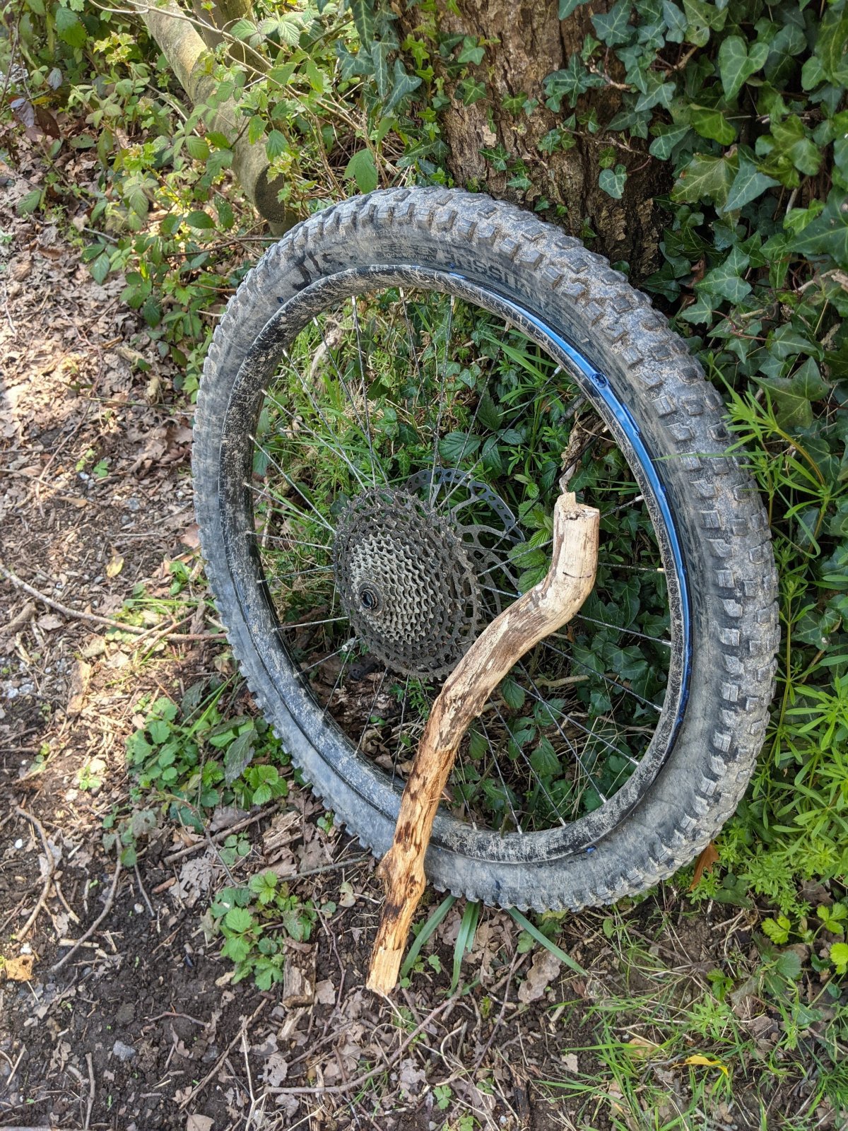

I didnt really have an opinion on this until recently when on a big ride one of the lads had a tear in the sidewall, couldnt be plugged so needed a tube putting it.
he had the nukeproof inserts which proved to be a total bastard to get the tyre off and insert out, it was hard up against the bead meaning that the tyre lever wouldnt get in there.
with my mighty plumbers grip I bent the tyre enough with both hands so someone else could get in there and break the bead but alone it would have been near impossible with backpack trail tools.
the nukeproof inserts arent man enough to enable the bike to be ridden with a flat tyre, I believe the cushcore are though.
so all in all, it was a terrible mess of sealant and swearing, sweaty middle aged men fixing a bike in the Welsh countryside that put me off inserts altogether..
I usually just use a DH sidewall anyway.
I've got a stick for this if you're interested. Found it the one and only time i had to get a tube in a torn tubeless. Superb fit, makes getting the tyre off a piece of p!$$.
Was going to patent it but haven't found the time.
Moved away from tubeless but kept the stick 😁
