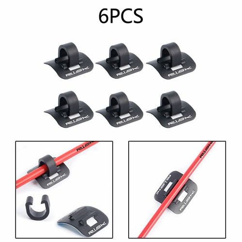

I've the same issue(flash new T4 V4, and the LEBS is saying its £50/h, about a 3h job.
Simple solution is to surface mount it. Which is what I'm intending to do.
You get these stick on frame hose clips, and similar which i think stick on,but also fix using zippies.
I think I could probably pull the original hose out, by snipping off the banjo and just pulling at it behind the battery, but I reckon trying to feed through a new hose without dropping the motor might be impossible.
