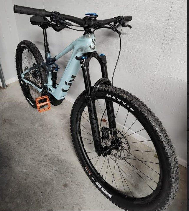

First time owner of an EMTB. I have been reading this blog for a while and have finally taken the plunge and purchased my first EMTB (with a crazy long name). I am a female rider, and a bit of a shorty so need an XS size frame. I considered the Specialized Turbo SL (2023)
but decided to go with the Liv, it has a slightly bigger battery and more power. It arrived on Tuesday, so far only had a few quick rides (on the flat) due to poor weather. Looking forward to having a decent blast on it over the weekend. So far loving it. I think it's going to be an awesome bike.

is that the full power but 400 battery model?
I'd be very interested on how you get on with it. Did you get the range extender also?

Yes, 85Nm and 400 battery. I haven't got the range extender as yet. I expect I will get one at some point in the future. It will be interesting to see what type of range I can get.

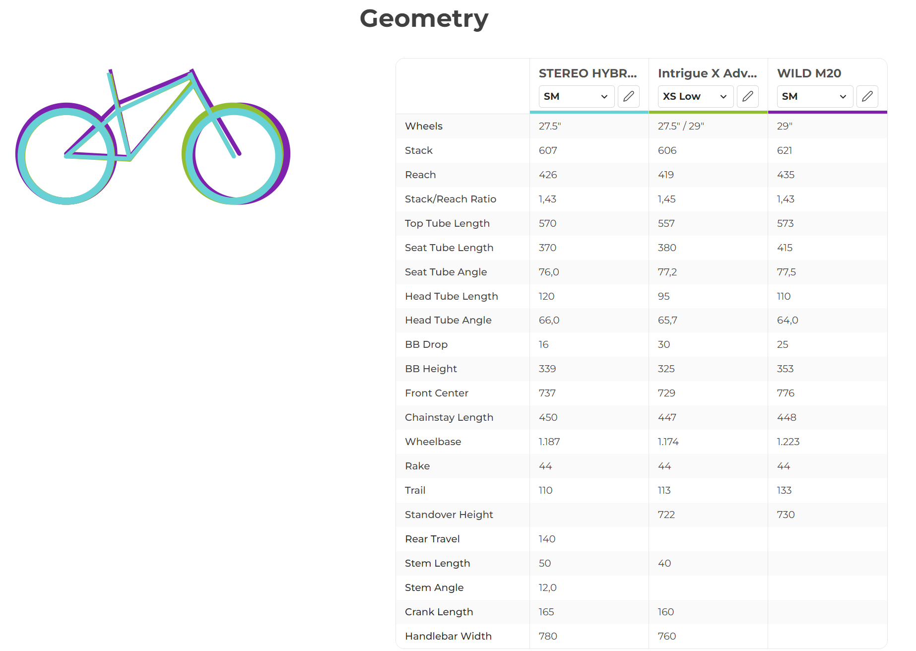

@AMD I'm sending you the link, stantdover on my cube is about 75-76 cm measured by me, the comparison bellow does not take that into account. The rest of the geometry seems pretty similar it's between the blue and green
Here is the Cube link as well Cube Stereo Hybrid 140 HPC SLX 750 carbon´n´reflex

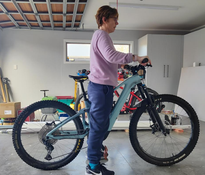

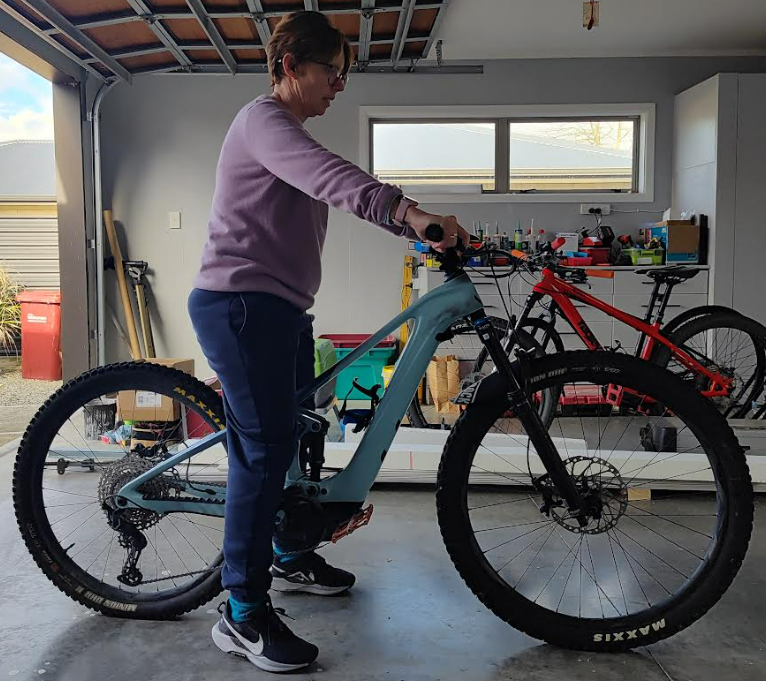

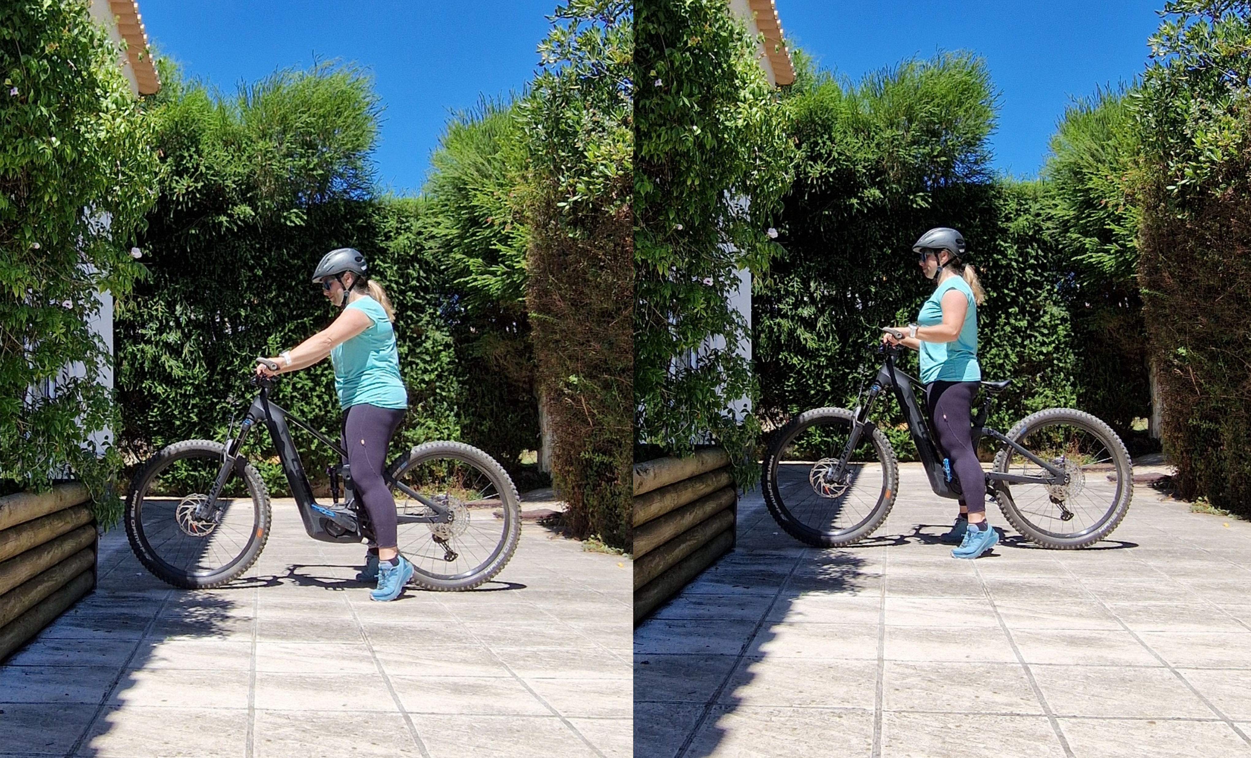

Hi
Sorry for the delay. I didn't have anyone around to take pictures of me on my bike yesterday!
I am not quite flat footed with seat all the way down, not far off though. As noted earlier should be able to swap out my post for a 120mm dropper (One Up).

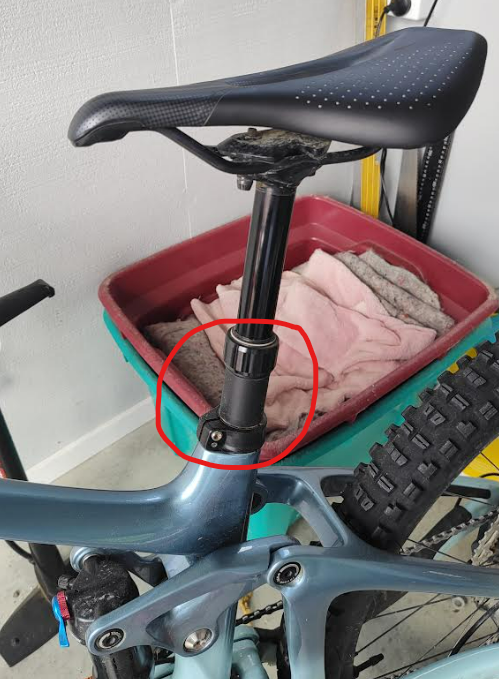

Seat Post

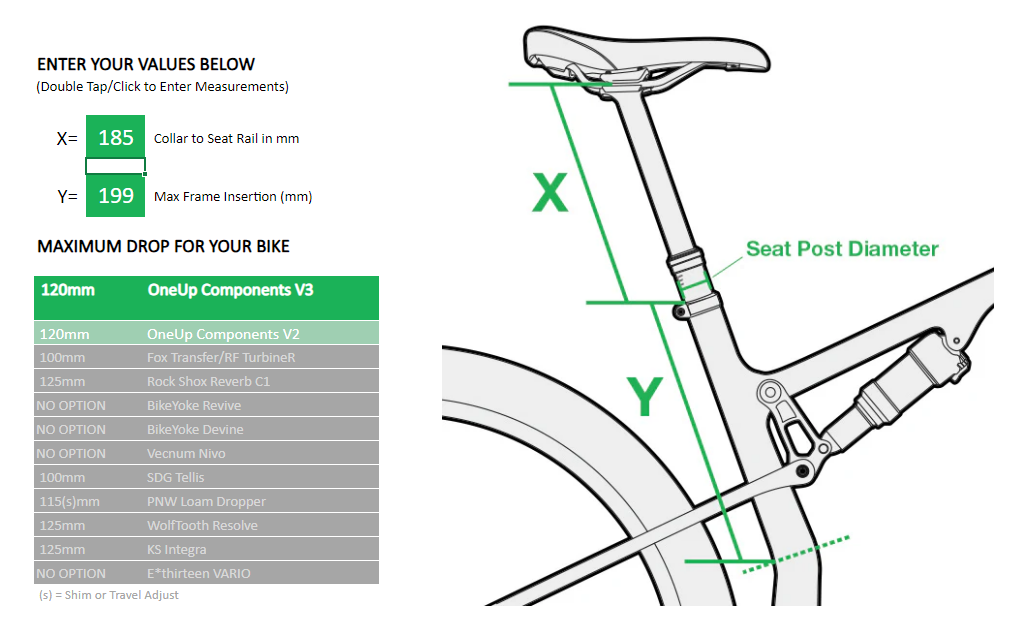

The seat post insertion depth on my bike should be 199mm, same as the model above mine Intrigue X Advanced E+ Elite 1 (2024) | Women bike | Liv Cycling New Zealand. The geo numbers look the same for XS, so can't see why my bike would be different.
Click on the video
I had a measure on my bike X = 185mm and Y = 199, therefore I can run a One Up, plus there are a couple of other dropper posts that I could run.
Hope this helps, good luck :)
