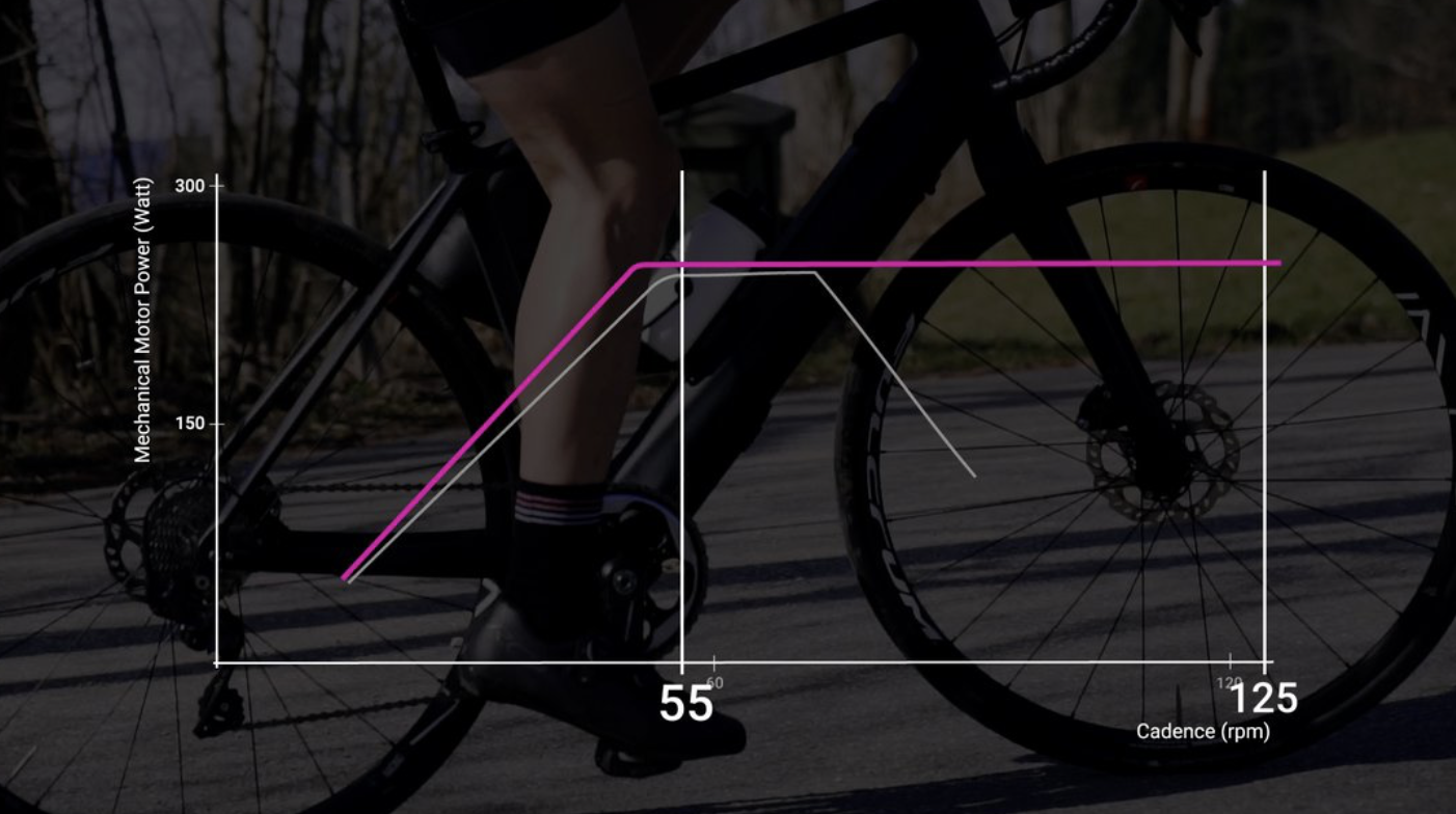

I have a Fazua powered bike to test with the software already. I'm really interested in how they compare.
We can now see how Watts are maintained across the cadence range (pink line). Interestingly we can also see the drop-off in power as on the previous software at a cadence of around 70-80 (grey line).
I've asked for the same graph depicting NM across the range too. This is an important comparison tool so we can see how rotational force is provided across the cadence range.

Interesting to see they are now quoting Mechanical power, good for comparison:
Max torque: 55 Nm
Power max: 300 watts (mechanical) / 450 watts (electrical), basic setting: max. 250 watts (mechanical)
The motor has an electrical power of 450 watts (Max) and 300 watts mechanical, which is an efficiency rating of 66%. I suspect this update will impact battery life / range.
