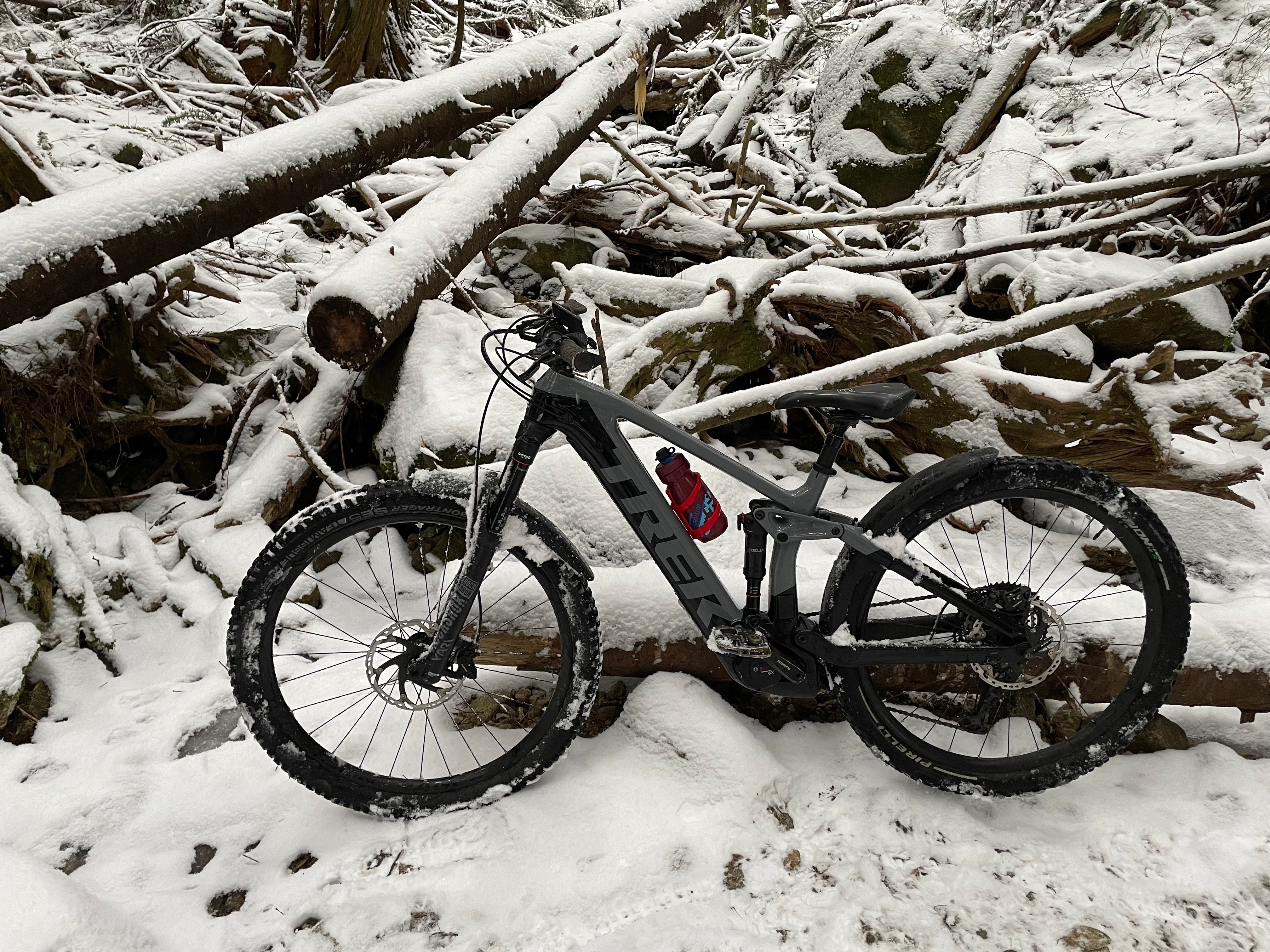

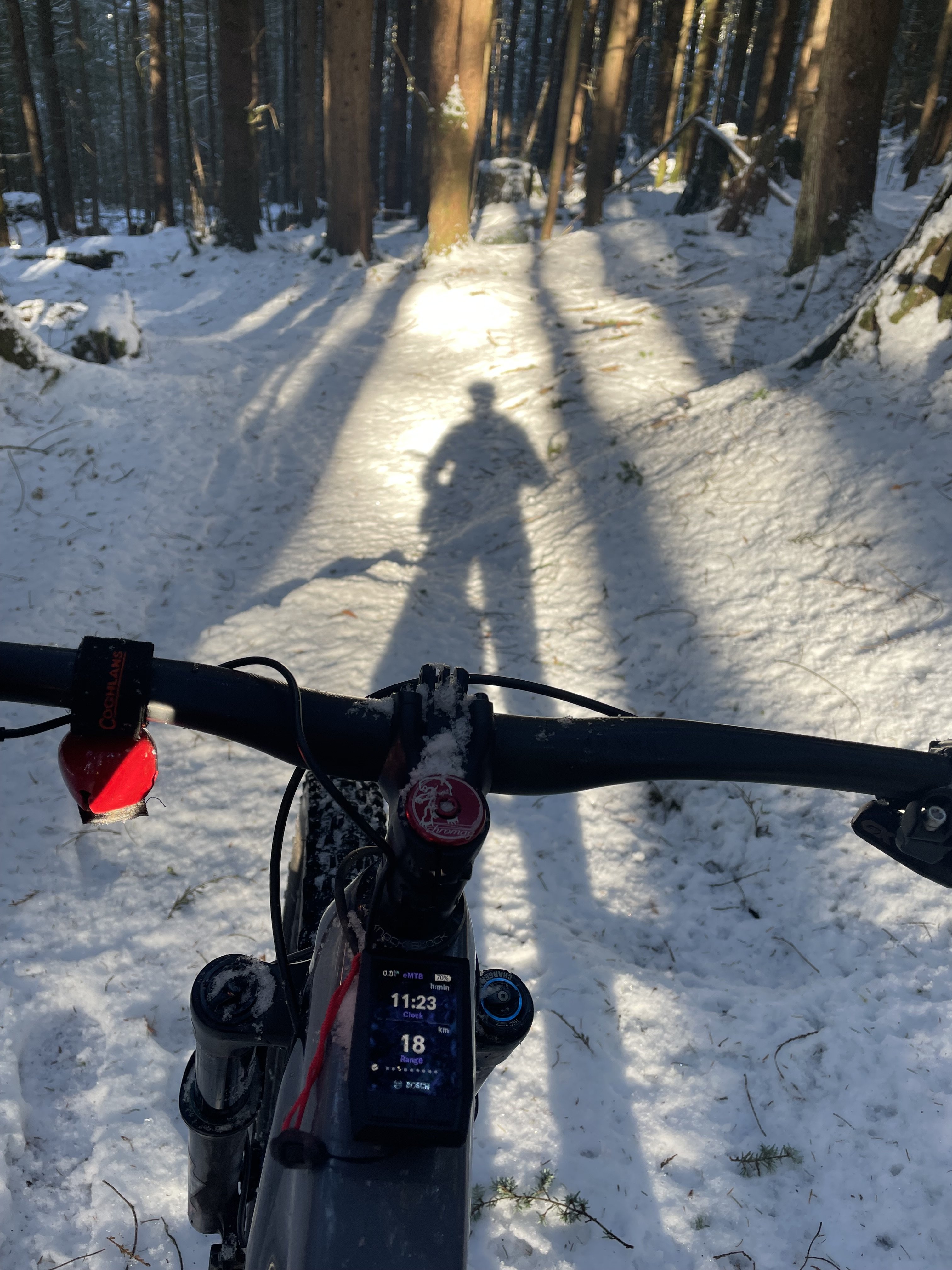

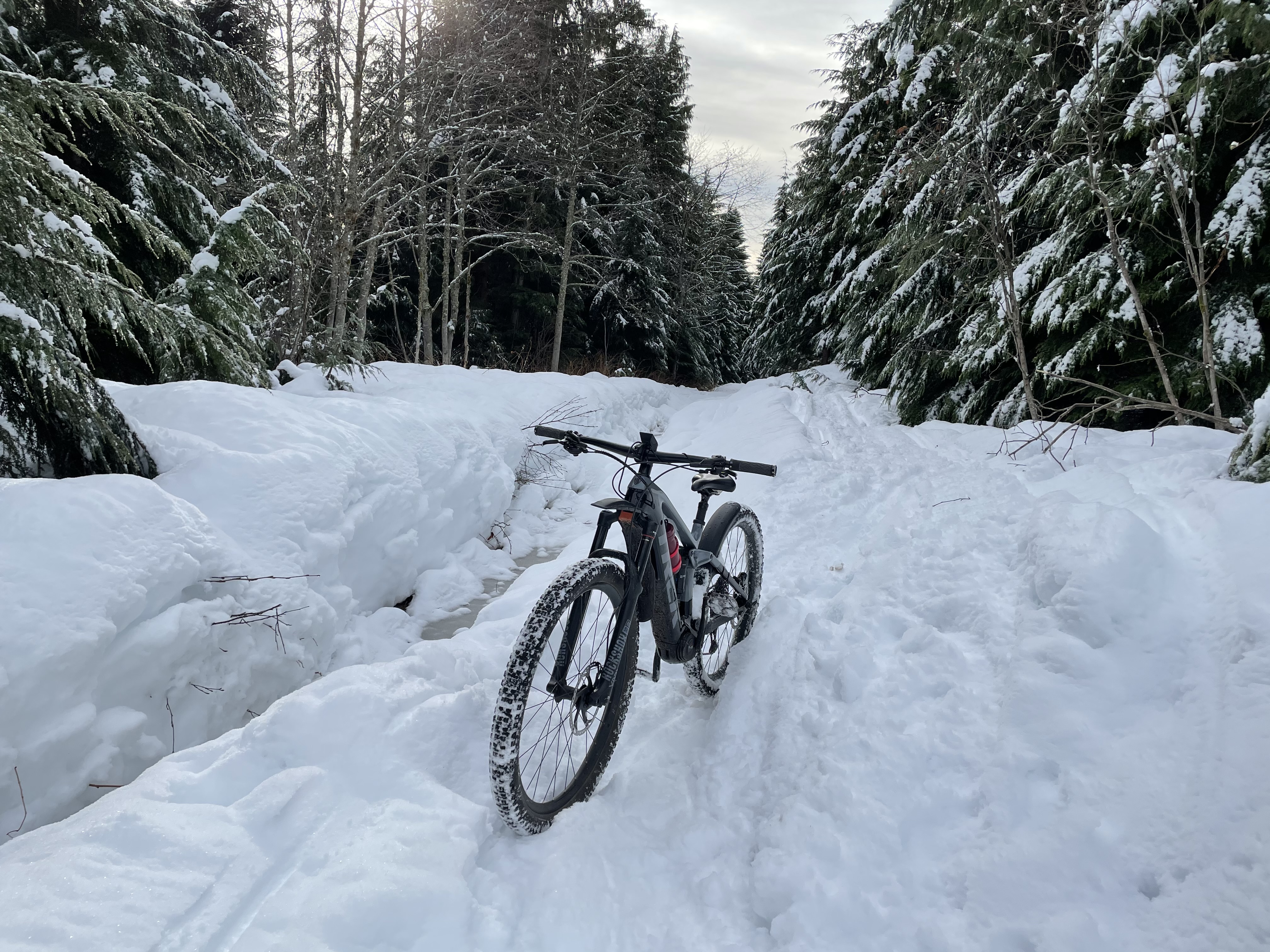

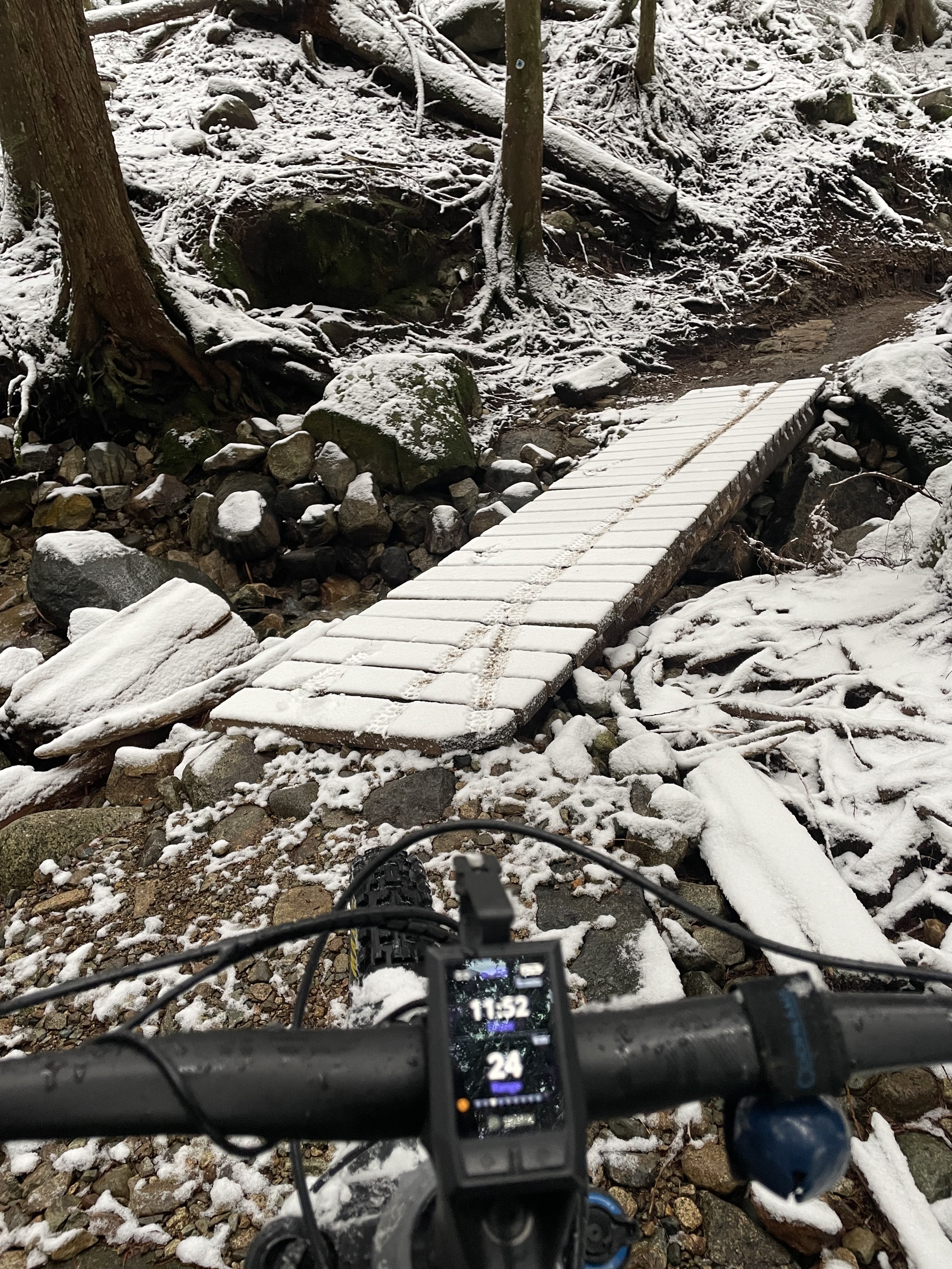

Looking forward to some snow conditions again this winter. My rides usually turn into-‘how far can you go’.
With 2.6” tires the snow texture and depth needs to be just right. Powder is nice, frozen top layer is ok, melting icy snow …not so good. Compacted skidoo trails are fine unless you stop, or slip off the track. Rarely do I see other tire tracks and riding while dark can be really friggen different. You really need to know the trails and any surprises or snow covered rocks.

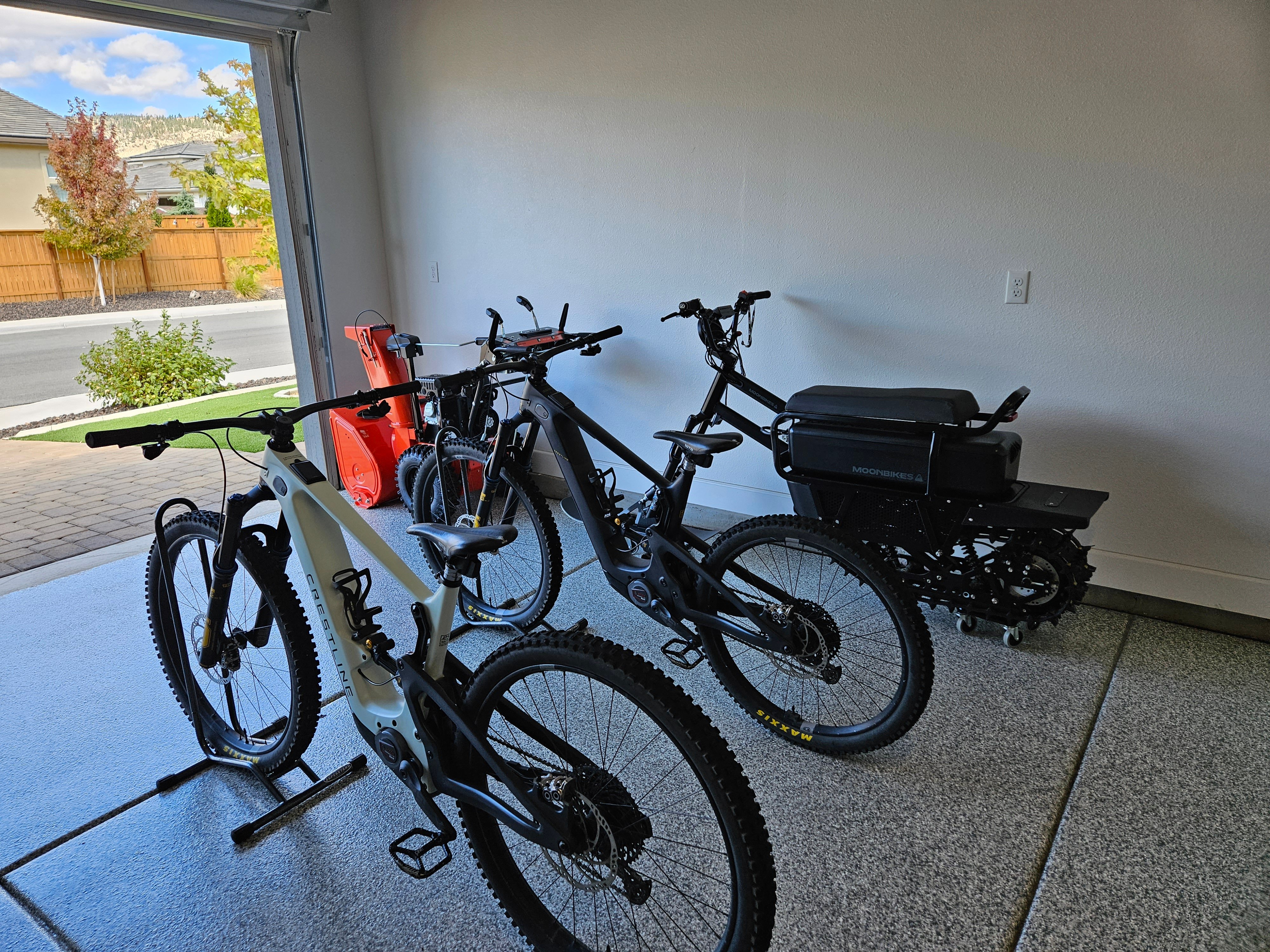

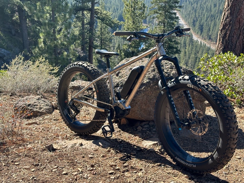

I just purchased a MoonBike! Haven't had a chance to ride it yet but hoping for winter fun!

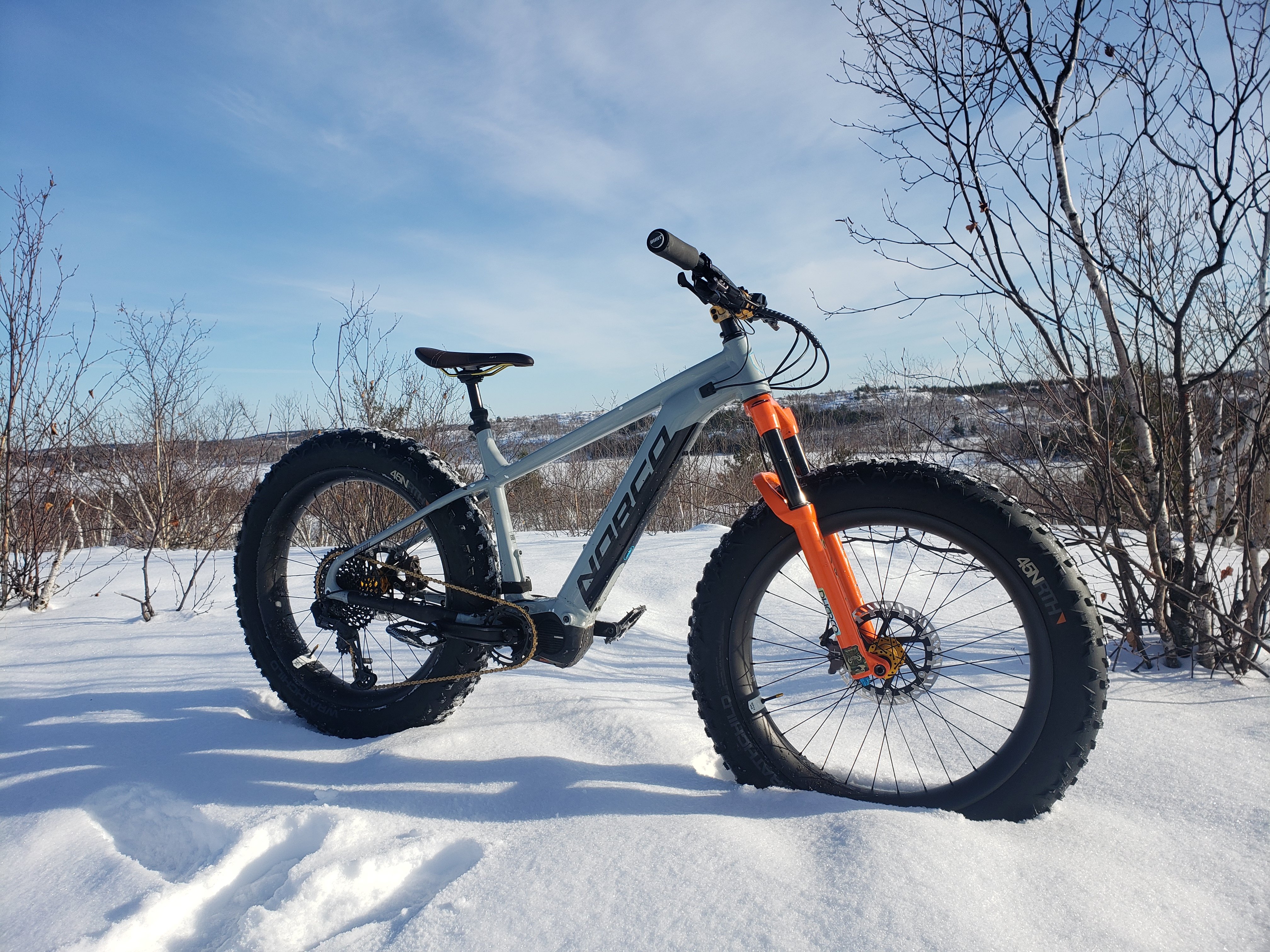

I love my Norco Bigfoot VLT -- Just put my studs on yesterday, and I love this bike. 27.5 is I think the way to go but if you go 26 you can often go a tad wider.
Note: 27.5 fat bike tires are bigger than non-fat 29s and 26s are bigger than non-fat 27s.
I don't really have many videos of fluffy snow because most of the time its is in the dark

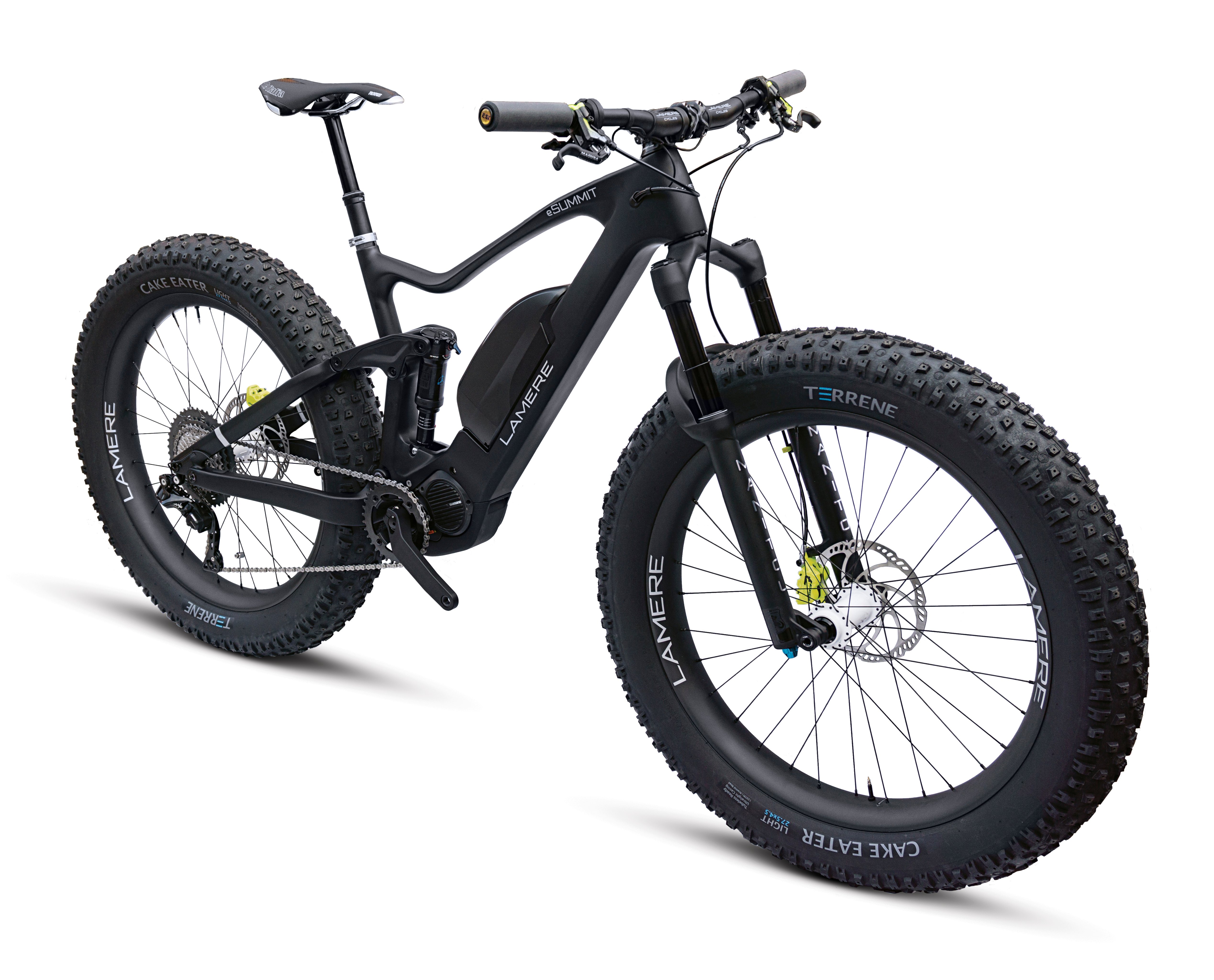

Of couse I'm biased as my last name is LaMere, but here in Minnesota, USA we at LaMere Cycles build the world's best electric fat bike, full suspension, full carbon, speed-tuned Shimano motor, hand built up any way you like with either internal or external battery.
I just looked up the LaMere bikes really awesome! Replacing the rear triangle for the summer is an amazing idea! Really cool bikes!

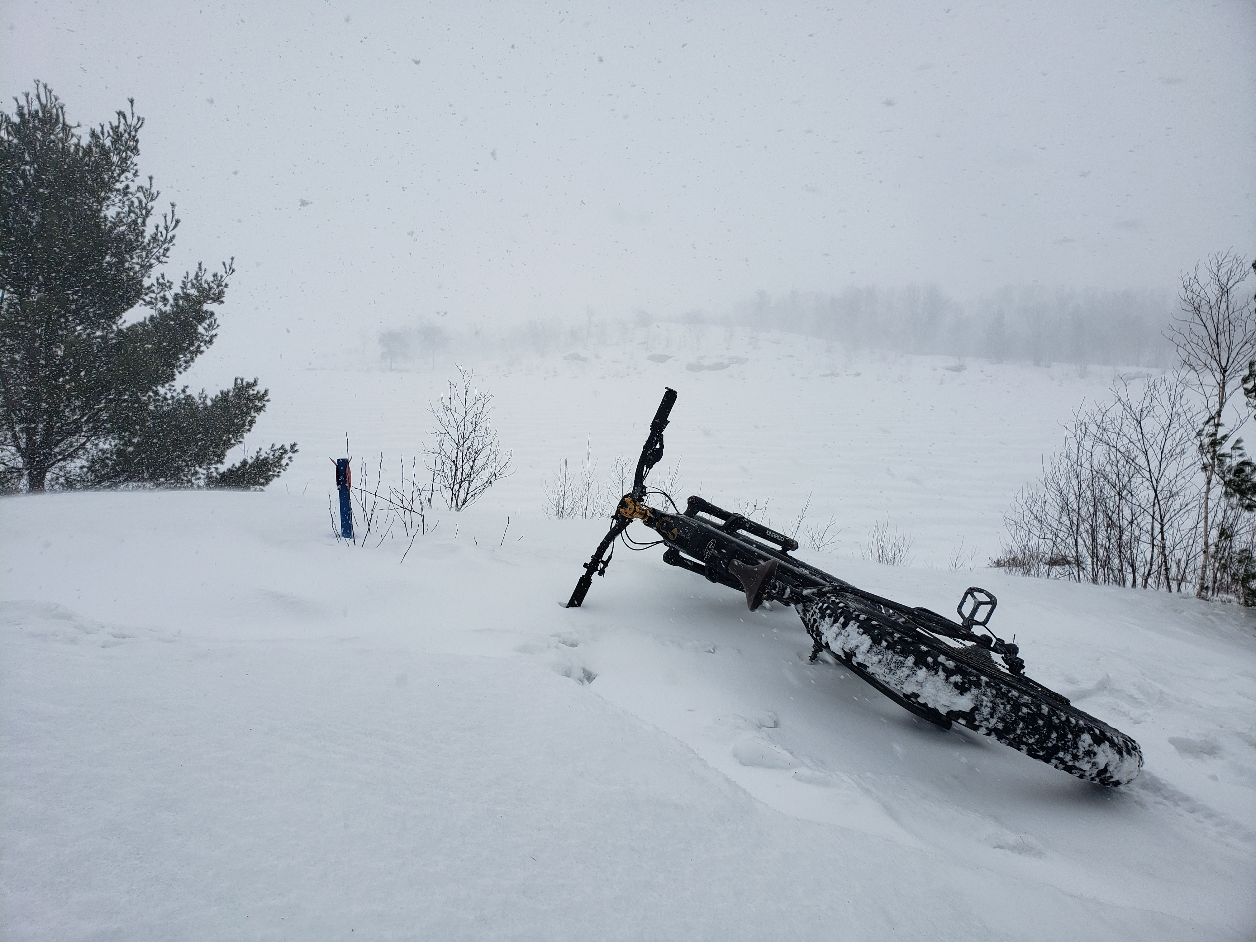

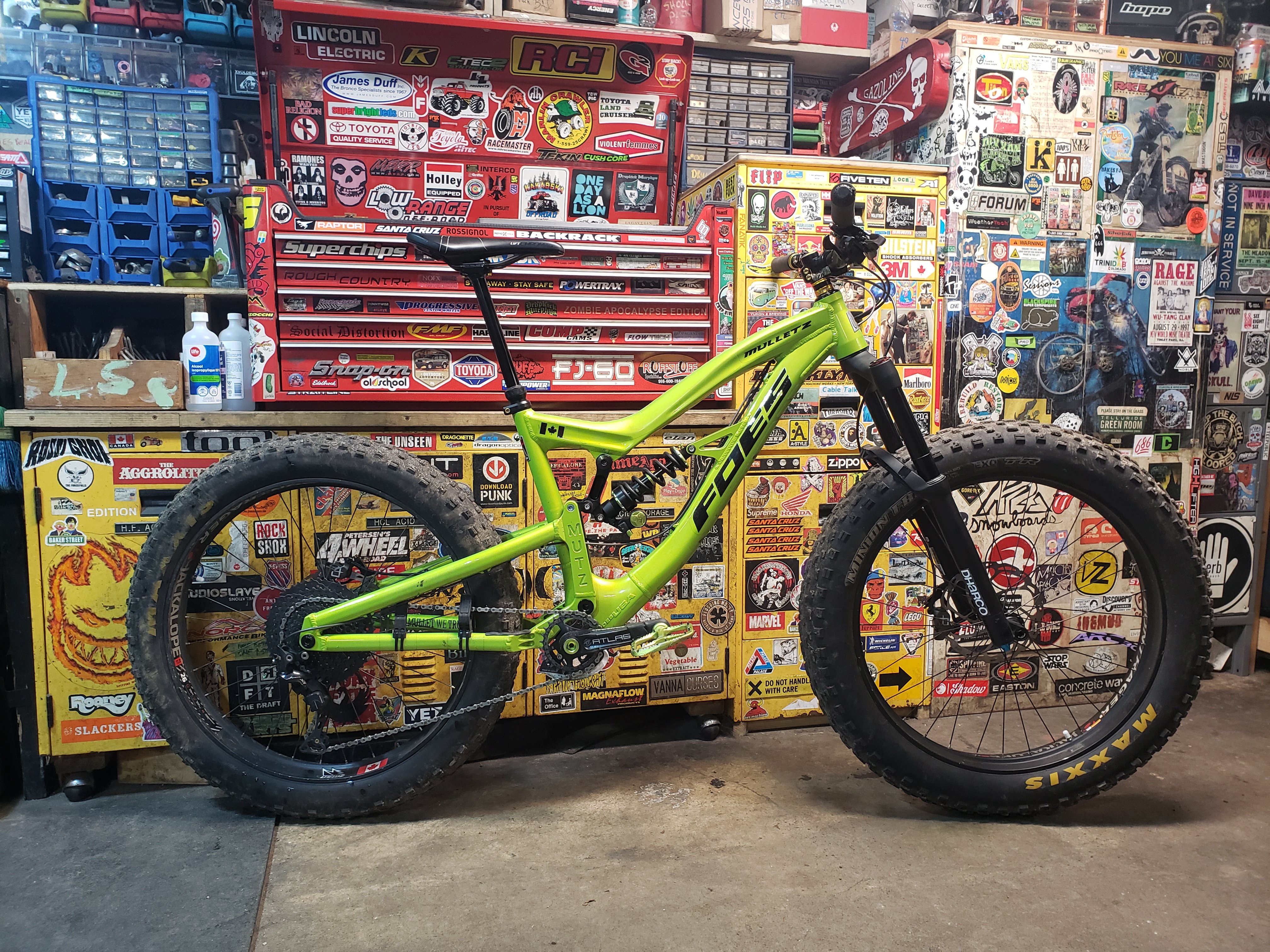

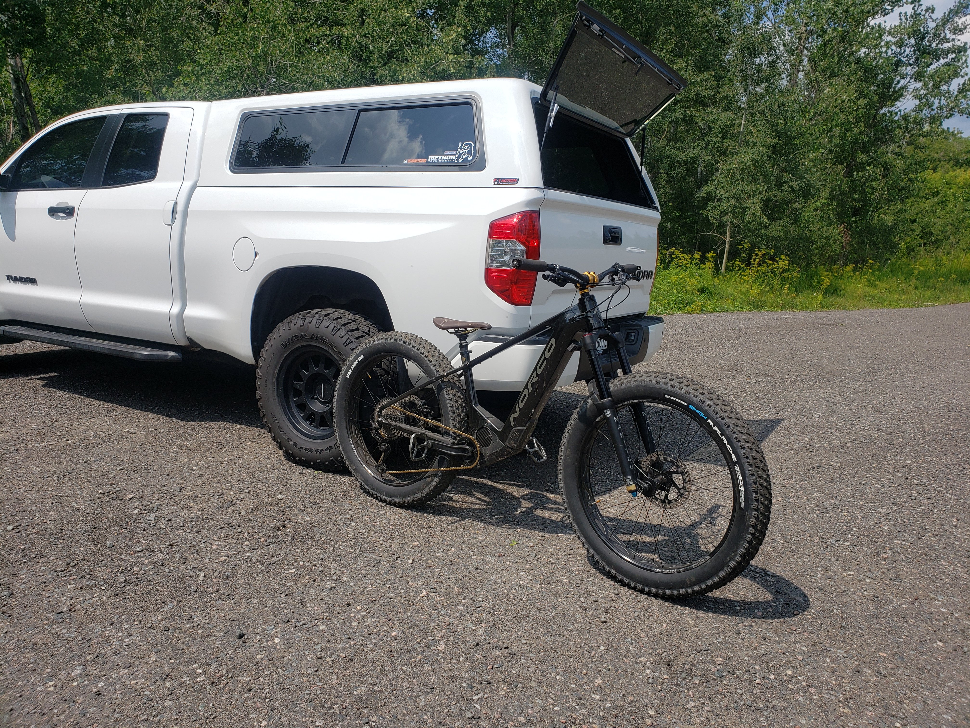

I ride a 23' norco bigfoot vlt 1 ep8 with the 27.5 wheels and previously had an 18' gen 1 vlt bigfoot e8000 with 26" wheels.
Both are great and make all the difference in the snow compared to a muscle fattie. Winter is actually where an ebike shines brightest imop especially if you get proper winters with a lot of snow (northern Ontario Canada here). The 27.5 wheels can be cumbersome and a little ungainly compared to the 26" at times which does make a difference when you're trying to maneuver in deep snow. They do roll like a mofo though so that's the tradeoff (just like 27.5 vs 29). Both bikes are surprisingly pretty fun in the summer as well..
As far as tires go I prefer 4.8" wrathchildren for non groomed trails and something a little less knobbly like a dillinger for groomed trails as it won't dig too much.
As far as setup goes, for me, front suspension is a must but if you ride groomed trails mostly it isn't necessary. I actually have a Foes Mutz full suspension (150/150mm) muscle fattie as well and would prefer a full sus e fat but most are cheap garbage. Foes is launching a new Fat E-ticket this season with the Bosch system, a 150mm mastadon fork and 150mm rear travel that I'd love to try.
Feel free to ask any questions you may have.
D
20230725_123426.jpg 20230325_135932.jpg 20230110_141313.jpg 20221122_014950.jpg

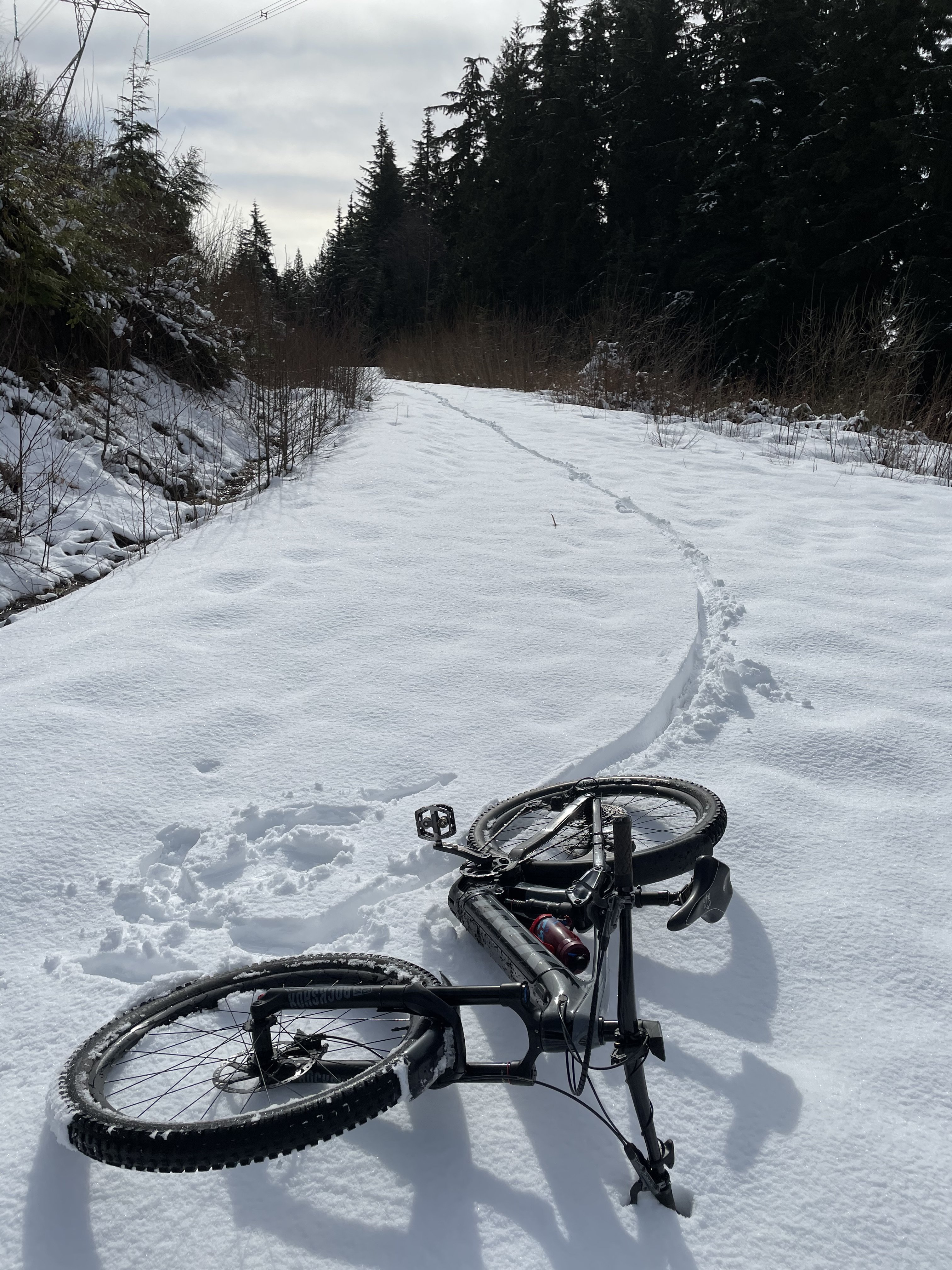

At the beginning of snow season I usually change to some new 29”x2.6” Maxxis Assegai. If I could size up to 2.8” I would, but that would be the max for me. My wheels are RacFace offset 35mm wide with a CushCore plus in the rear. I can drop the tire pressure to 12 psi if I need to.
My bike(Rail), my tires, footwear etc, are ready for the snowy conditions, when that happens. The conditions or texture of the snow is not always perfect. Icy or slushy snow is almost impossible. But powder, crusty or compacted snow is fine. I’ve even surprised the skidoo’ers sometimes by using their tracks. I just don’t stop cause you can never get going again. IMG_8801.jpeg
About 100-200m behind my bike I had to turn around. I fell off the trail, and then into a tree-well. Was only 5’ deep snow but I couldn’t touch bottom.
Anyways, my aim is to ride all year round. 11 months a year is better than 9 months a year, but it’s time to breakout the winter gear. 👍🏻
