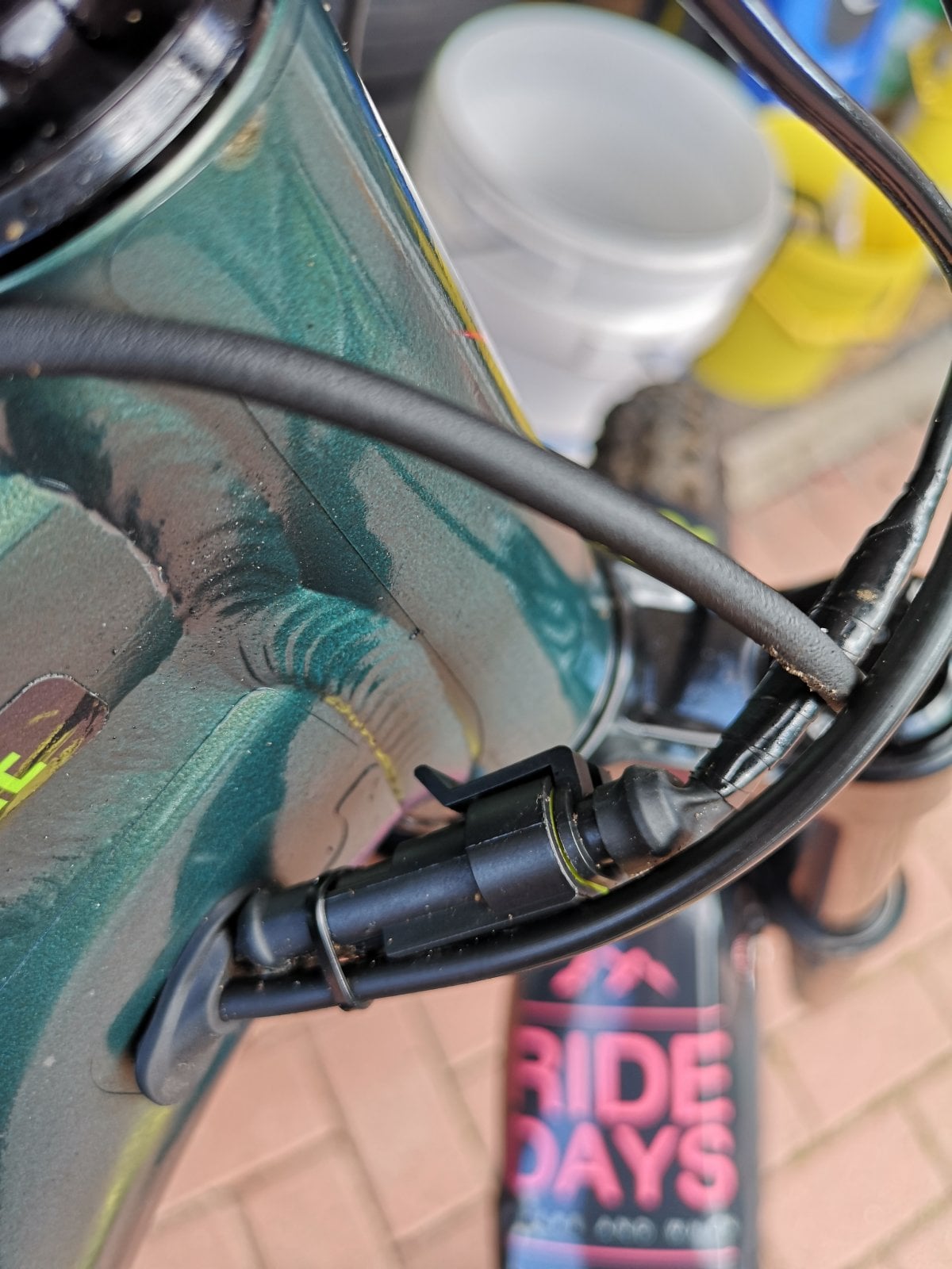

Fitted an exposure Flex 3300lm light to my E180. The installation was very easy, just run the cable to the motor and plug it in to the front light port. I opted to install a waterproof plug so I can remove the light easier when not in use.

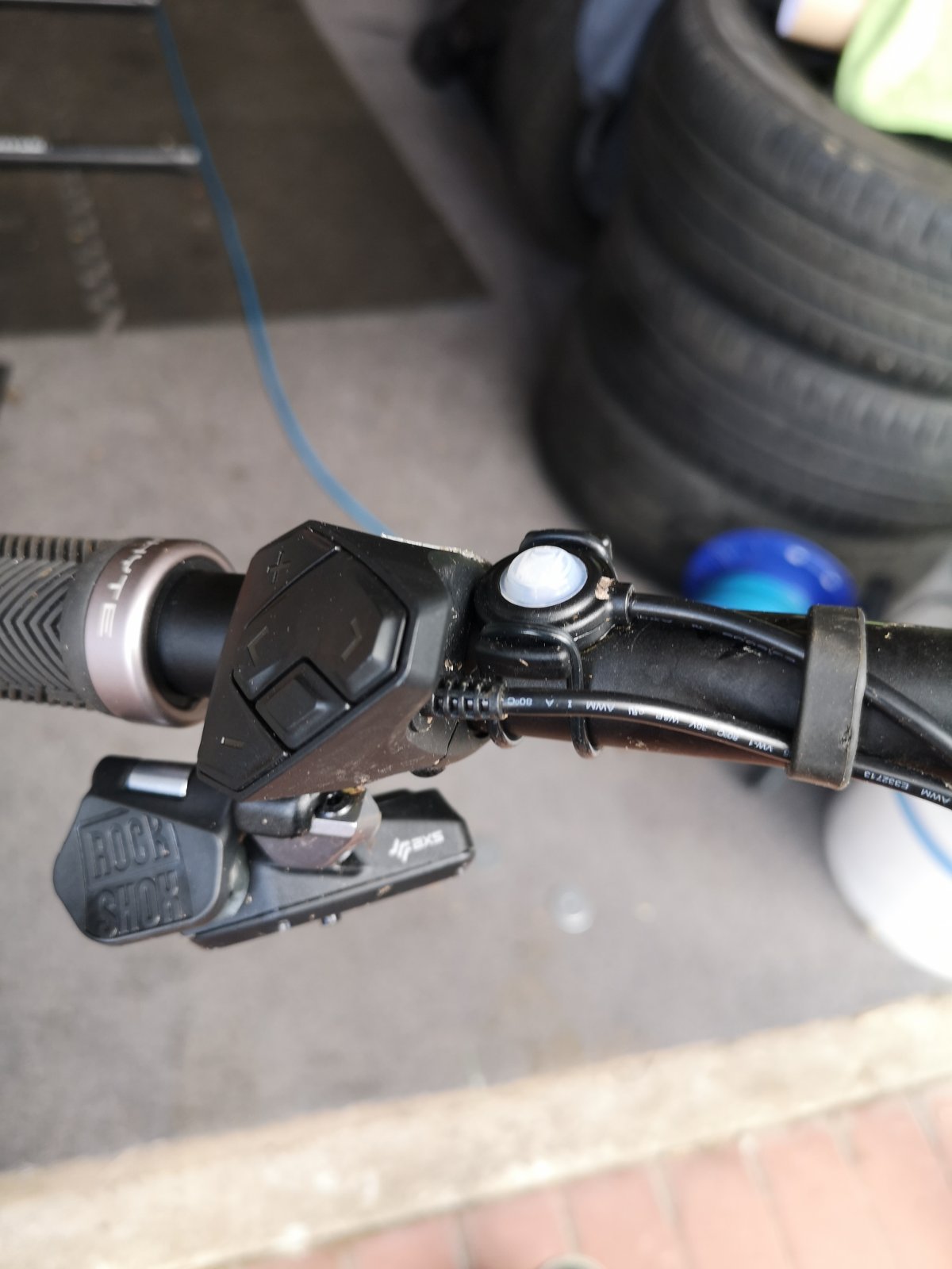

Is your light up the correct way?
I have the same light I wired into my Rail. With the connection hidden inside.
I have the light up the other way though, I’m sure the three LEDs and lense are meant to be up the other way as they aren’t symmetrical.
I had to rotate the bar mount higher than I wanted to get the cables so they didn’t touch the stem faceplate.

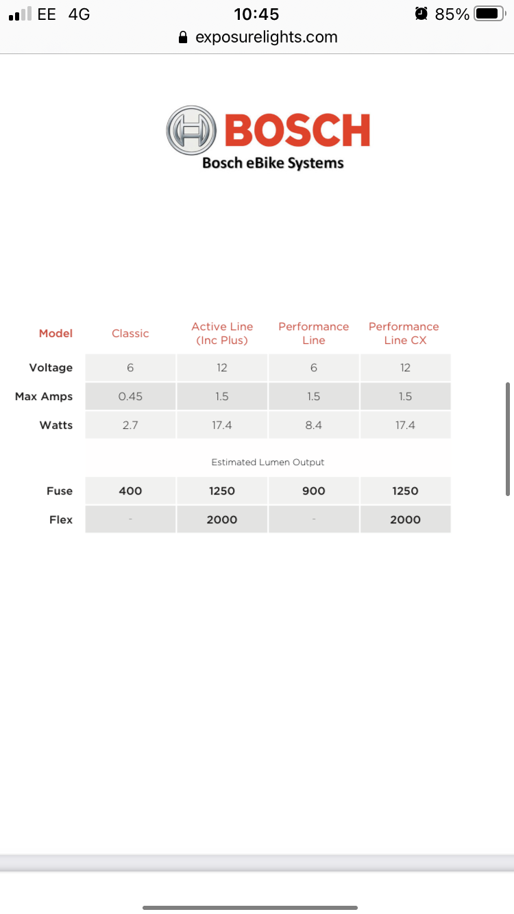

Some info on this thread
Also if you are using the Flex on a Bosch Gen4 system, the output is 12v / 1.5amps max (set the Flex to Orange led current spec) = 18w
Exposure say at 18w the Flex Gives 2000lumens.

Yes it's upside down as I don't like the light being interfered with the bouncing hoses, it's just a pet hate of mine. It makes no difference to the riding I do and i get more adjustment should I need it.
I have it setup on the correct settings for the Bosch motor too.
