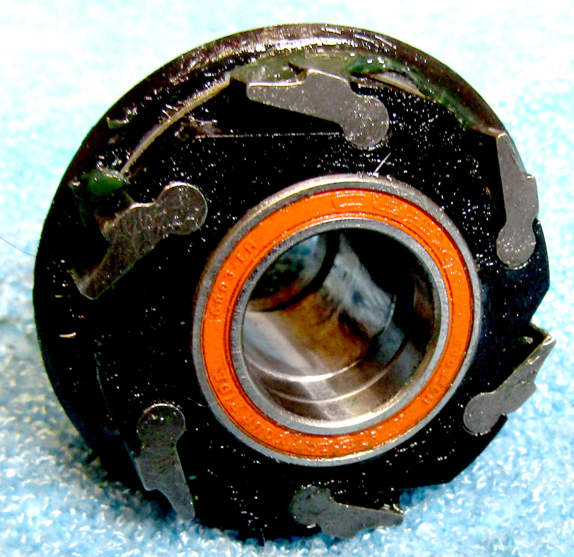

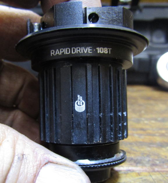

Rail (750Wh) Expected to find 3 pawls in freehub (based on what I read here and there), but has 6.

Yesterday I removed and serviced the freehub on both my:
Rail 7, and
Fuel EX8 g5.
Both had the identical freehub, and both have 6 pawls, so obviously I was wrong.
Sorry for the marginal pic... not grit in pic, fresh grease sparkling in the light I suppose. Post cleanup, about to install:
Thank you,
Andrew Cooksey

Yea majority of Trek's medium to higher level bikes will have "rapid drive 108" in the hub/wheel specs. 6 pawls, 108 points of engagement. Its very common to find and easy to tell POE with a simple spin of the wheel.
Thanks! You know your stuff!

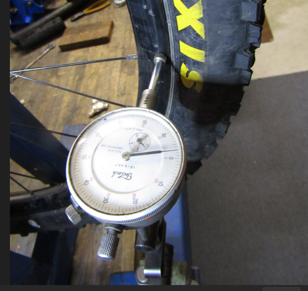

So far the LineComps have been just fine for me. Although I do a bit of racing, and like to ride in the rocks, I am 67 and weight 140 lbs... and am fairly cautious to be able to ride another day.
Gosh, maybe pinned-sleeved rims have come a long way, as I true my rims with a dial indicator but have not noticed that extreme mis-match at the "rim-ends" that we typically get with p-s rims, see pic below.
No broken spokes yet, but anytime I remove a wheel for any reason, I put it on the truing stand and adjust it back to within .010" runout max.
QUESTION if you don't mind... If I wanted to mount my XT 12 spd microspline cassette to a DT Swiss wheel that I have laying around, what freehub would I need.
You would need a DT microspline freehub that matches the DT hub design that you have, e.g. hugi ratchet vs spring&pawl. Determine the design and then research availability.
