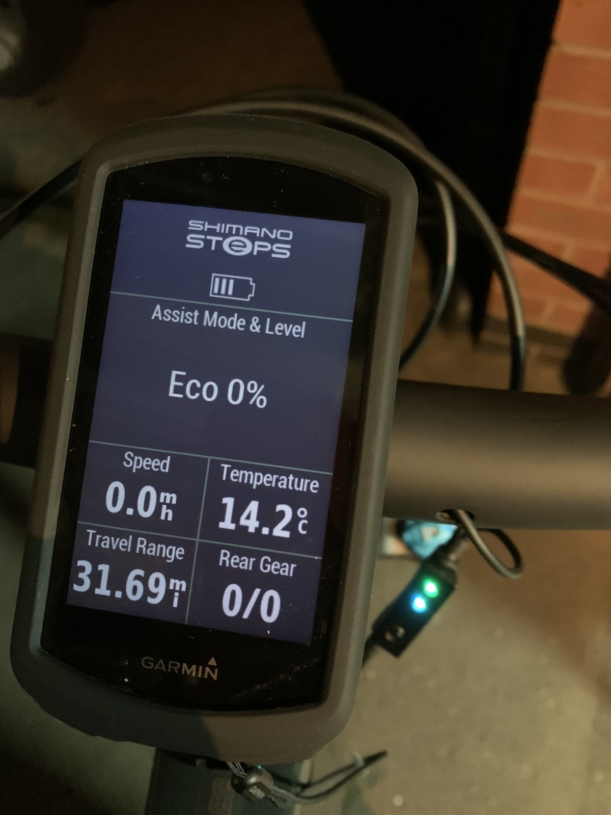

I have installed ew-en100 with Steps e8000 motor and using Garmin Edge 830. All works fine. But how do you clear Distance? Thanks in advance.
When I start an activity on my Garmin Edge then the distance always starts from 0 for me? Is that what you mean?

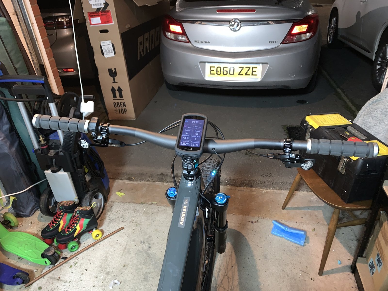

if I use a EW-EN100 can I remove the e7000 display from the bike?
does Garmin Edge 520 plus then connect to the EW-EN100 via bluetooth or would it connect to the motor via ANT ?
9,190
Yes you can remove the display
Not sure on your second point as, but mine connects via bluetooth to my Garmin Vivoactive 3 Music watch

Does anyone know how to get a Garmin 1030+ to revert back to its own wheel sensor for speed readings instead of the one in the E8000?
New bike yesterday and I fitted the EW-EN100, removed the 7000 display. Obviously I now use the E8000 as a “Sensor” in the Garmin so that I get battery/assist level but this then uses the E8000 for speed and cadence too but I would like to use the Garmin wheel sensor for speed.

Is the EN100 small enough to go inside the handle bars? I have di2 carbon bars. (Or do you need it functionally when installed)
Biano44
Oct 7, 2020
100
87
Charnwood
Are you referring to the Santa Cruz Di2 bars?
If so, I tried that but it wouldn’t go past the inlet hole (on the left hand side anyway)
Ended up simply plugging it in where the 7000 was but attaching it to the dropper post cable.
I don't think it's possible, I have the same problem.
I have AXS dropper and shifter so trying to hide the en100 but it will likely be put on the rear brake hose in a similar position to you
9,190
I would say you want to keep it visable, because if you go for a ride without any device connected its you only way of telling battery life/mode/power.
With the EN you can also get rid of the mode controller if you want, and use it to change mode, or you phone, via the E-Tube Ride app.
I know one person who has done this and hidden it in the down tube, so you have nothing at all on the handlebars
Yep.....I just wanted the Garmin as the display and not that silly display on the handlebars.
When all the other stuff is done I will tacle it again and hide it in the top of down tube.

Im going to keep the mode switcher and use a Garmin for the display info. I will put the en100 in the down tube.

I keppe the EN100 visible because it's much easier to see what mode you're in compared to trying to read my Garmin screen. The cable is taped to my rear brake cable so pretty neat.
Have you tried making a custom display screen and using that instead of the default STEps screen. Maybe you can pick and choose your sensors there. I use a custom screen but don't have a Garmin speed sensor to test with because I have set an accurate wheel size with ST Unlocker.

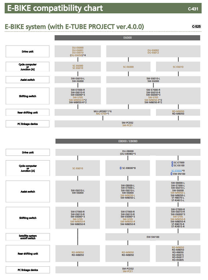

Hi. I have a STEPS SC-E6010 display on my bike, which unfortunately lacks wireless. Super annoyed the bike didn't come with am E6100...
Anyway, does anyone know if adding an EW-EN100 would help me out here? A similar wireless device seems to be the EW-WU111 but it's for some reason more $ than the EN100.
Thanks!
The wu111 is only for Di2 I believe. I see no reason why the EN100 wouldn’t work sided by side if your display has no way of conflicting with it.

Yes. It didn’t work.
With the Garmin 530,830
Garmin's wireless speed and cadence sensors will override the speed/cadence data transmitted by the motor if fitted to your bike.
You will require them if you're running a derestricted set-up otherwise your garmin will log your rides as half the true distances/speeds
Thanks!

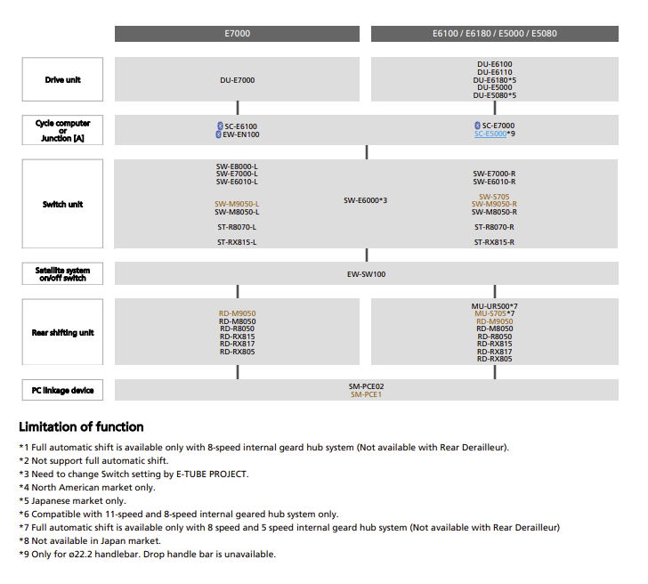

I think this is the latest compatibility table: https://productinfo.shimano.com/download/pdf/com/2.6/en
I don't think any of the options allow for a display to be used alongside a EW-EN100 (one or the other, i.e. one option from each connected box):
I didn't expect a conflict but googling brought be to this thread here which has some comments indicating the units cannot be used in parallel. I wished I could try this out without commitment :-<

in that case you can ditch your display entirely and instead use the EW100 junction box with or without a bar mounted STEPs mode shifter switch.
Well, the actual idea is not to ditch the display. An E6100 display instead of my E6010 would be ideal but my budget is maxed out. I am basically looking for the most affordable way to add wireless to my setup to be able to use the etube app, update firmware, adjust settings etc...

Ah... So I guess it's not an Emtb you have if it came with an E8000 motor but a city bike display?
If buying new EN-EW100 is your cheapest option at £60 and will do all you want. Once you've updated software and set your assistance preferences etc you could then just sell it on.
I don't update my software at all anymore (over a year since updating) and never change settings.
