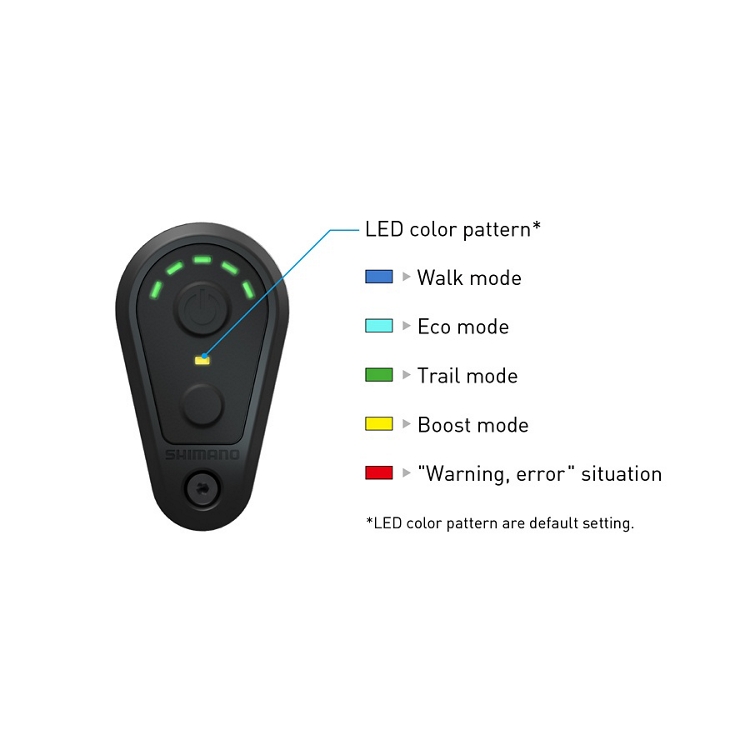

Hello i run my yeti with EP801 without screen. Just ising The EM800 assist switch on the bar. The ew-sw310 powerbutton indicates witch mode im in 👌

I'd be also interested how that connection work. SW-EM800 (mode switch) -- > EW-SW310 (updated power button) --> EP801 drive unit? Or do we connect it diff
I'd be also interested how that connection work. SW-EM800 (mode switch) -- > EW-SW310 (updated power button) --> EP801 drive unit? Or do we connect it differently?
Just like you said! The EW-sw310 has 2 ports!

Hello i run my yeti with EP801 without screen. Just ising The EM800 assist switch on the bar. The ew-sw310 powerbutton indicates witch mode im in 👌 View attachment 121183

To run screenless, you'd need EP801 and 2nd Gen Shimano battery, as well as power switch above.
If you have any other motor, or any non-2nd Gen battery, screenless won't work.
