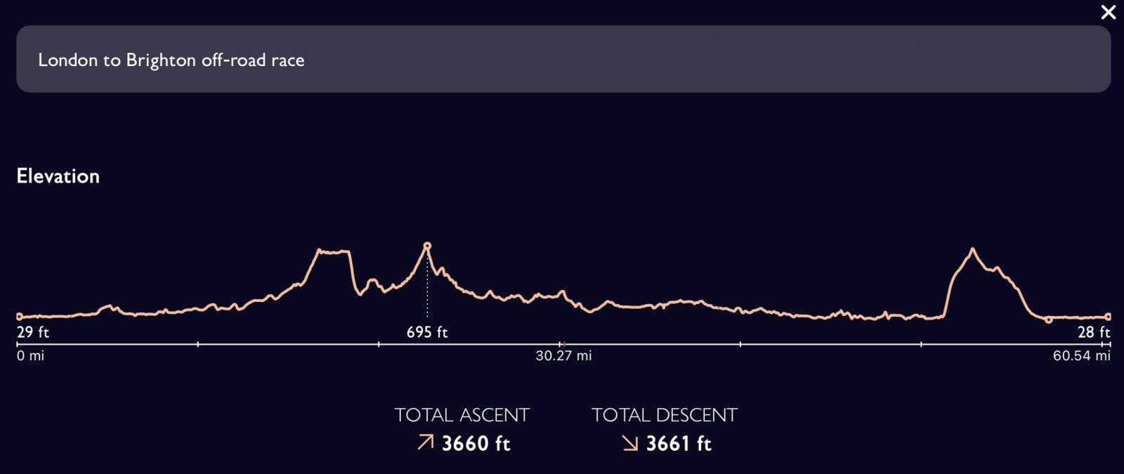

Is it possible 37-43miles + 6500 ft (eco mode) ?
I have done 151km or 93mi and 1196m or 3900ft on E8000/500Wh, in Eco-low (20% assist, 30Nm)
So, I am convinced that I can do more with more efficient/lighter/more powerful/higher capacity EP8/630Wh. I will let you know once I have tested it.
However, having done E8000 test, I have to admit that riding in Eco-low is defeating the point of having an e-MTB. I would be faster and had more fun riding analogue MTB rather than eMTB in Eco-low.
Pivot
Jun 11, 2020
668
1,088
New Forest, England
Yes, I have done today 97km today and I have 62% battery charge left.
Admittedly, I have done first 40km with motor-off, but that means that 55km used only 38% of the batt charge. The 95km race had ascent of 3660ft and descent of 3661ft

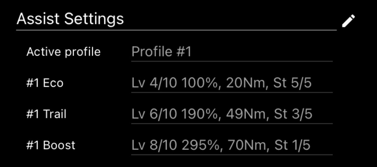

Hey @Pivot, I am looking at a bike with the EP8.
Could you describe a bit more about this race you did with the EP8...what settings(assistance and torque) did you use? What was the terrain like? Which bike? Thanks 🤟⚡

Hi @emtbeast
Last year L2B off-road was ~95km. Very well organised and run event. I saw 8-ebikes on the day, but must have been more, as there were ~3000 riders in total.
Registration is open for 2022 and I am doing it again.
There are check-points / pit-stops every 20km, so you can stop to eat/drink or just ride through. Last time we ignored the first pit-stop, next time I will stop at every checkpoint, as when I asked for my clocked time at the end, I was told they were clocking only to see that they didn’t lose anyone in a ditch somewhere so it’s a social ride, not a race.
There are 3 major up-hills, see attached profile from OS app.
I rode on a brand new Ducati TK01RR (I got it via DHL 3 days before the ride) and I didn’t know by bikes range, so I set the Eco mode to 20% and I rode first 40km with the motor OFF.
I cleared the first hill with motor off, enjoyed the downhill and I switched the motor ON at the bottom of the second hill (what a relief )
The third hill is the killer, uphill lose gravel and stones, with people pushing their bikes. I went into Trail mode and I had probably the biggest grin ever! Many people pushing their bikes just gasped “I want one of those” , no one had any energy to come-up with any nasty one-liners
When I finished the ride I had 4 out of 5 battery bars on my display(?) I thought I should have been riding the whole ride with the motor on! When I connected to the App, I had 62% of battery left (IIRC)
Here are my modest settings for L2B ride:
Anyway, I highly recommend the ride, next time I will have thicker-padded underpant, as that was the only aching part of my body. Otherwise I could ride another 50km, with pit-stops along the way.
