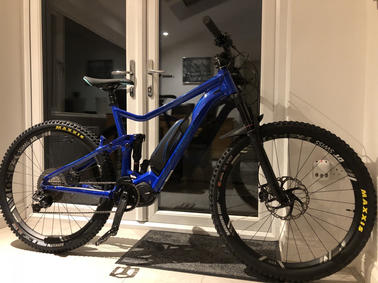

First up I'm happy with the Shimano motor, I had a Traxer with the same system & I like it a lot, I have only compared it to a Bosch unit so far so can't compare to Brose which is the only other motor I was considering.

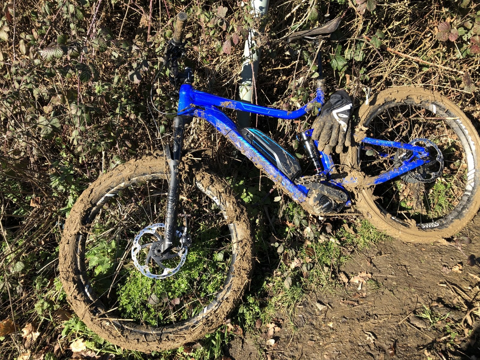

The bike has some great bits bolted to it which is why I went for the 900 over the other models, Pikes, Reverb DT wheels etc, but why fit Di2? I have never in 30 years had a problem with a normal cable but now I'm scared I'm going to rip the thin electric cable out if it catches a branch or some undergrowth, I had one silly muddy ride & even the build up of mud started to move/stretch the cables by the BB. The only other thing I didn't really like were the big tyres, a bit bouncy & although I thought running the lower tyre pressure was great for traction it does nothing for drag. I bought the onetwenty as it's pretty much the shortest full suss emtb on the market, I don't do anything that warrants a DH style bike but I wanted the traction & comfort of a FS bike. I have also seen some people say they get a lot of pedal strikes, I personally think the BB is quite high, I struggle to get my toes down on the ground with the seat post fully extended & I also find it quite hard to mount the bike without the saddle dropped. So to address the last two issues I have tonight fitted some normal rubber, Maxxis Minion DHF 2.5 WT TR Folding Tyre Exo Protection 3C MaxxTerra & Minion DHR II 2.4 WT TR Folding Tyres, they seem to have dropped the BB a little but I have yet to ride them.
I have also changed th saddle to a Bel Air 2 & I'm going to change the grips to Fabric mushrooms as I'm struggling to get a nice hand position on bars much wider than I'm used to.
I hope to update when I have had more than the couple of rides I have done so far & certainly after the mud has dried out a bit as that has marred both the rides so far, I'm hoping the changes I have made are for the better ;)

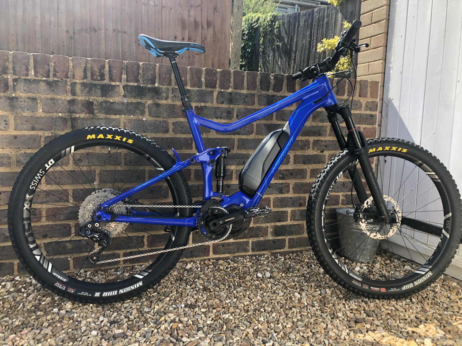

An update, later than planned. Today saw me hit the 600 mile mark, TBH I thought it would be a lot more after this long but shit happens & it is what it is. So after todays 25 mile ride I thought I would check the tightness of all bolts, give it a good clean, which despite my instinct I did without a hose or pressure washer, polished it up, T-cut the scuffs & touched in the chips of which there were many :mad:
The result
I also took the chain off to give it a proper clean, it's bloody twisted & I can also squeeze the .75 in there if I force it a bit, 600 miles of being nice to it & the thing wants a new chain! Anyway ordered a KMC from Merlin for £20 so I'll see how that goes as they have great longevity reports, guess it will be another year before I can report back though :(
But the main point of the post is I still have a massive smile on my face when I get back from a serious ride, this bike can take anything the uk can throw at it & I see no need for a longer travel bike.
I have changed little & it hasn't cost me a lot to do so, I'm not saying that having £3500 in a bike is cheap, but it could of been a whole lot worse ? I think this is the first time in over a decade I haven't bought some kind of new bike in over a year so it must be good?
Cheers.
