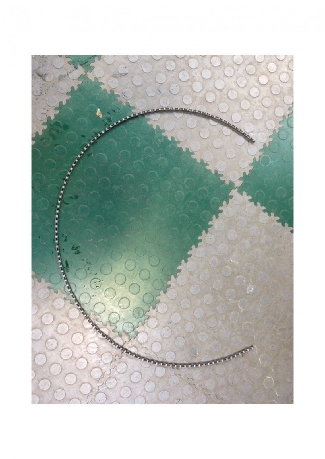

This chain has done less than 200 miles - This is the amount of lateral flex it has....if it were on any of my motorcycles, I would have binned it ages ago...!!!
