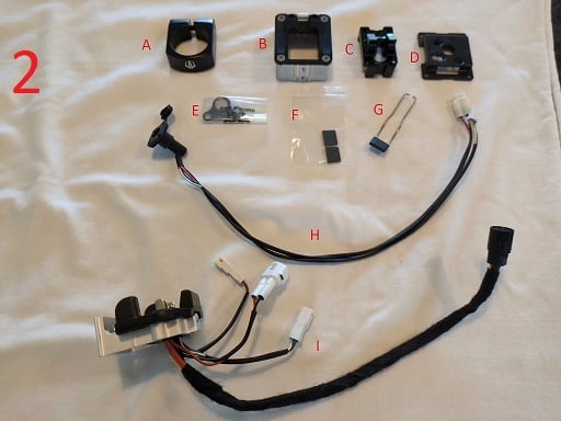

All parts finally in house. As I start connecting everything I noted that the battery harness (2I) has 4 wires with connectors. 2 of these wires attach clearly to the charging port (2H) and the black circular connector goes to the motor. What is the fourth wire for? Is it unused by design?
PS I found the down tube wire/cable routing maddening (specifically the dropper post). Found it much easier to run cable first THEN insert battery but YMMV.
I believe it's a on/off button connector. Here's an example Darfon part that looks to have a matching cable end. Just a guess though. BiXS Darfon wiring harness with starter button 500mm, 25.90 CHF

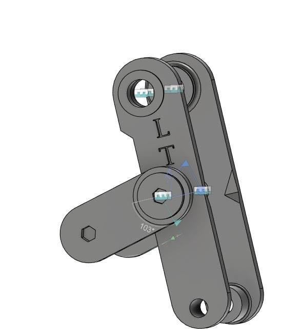

OK folks, here are some drawings of the LT link.
My friend Dave has been hard at work. I am cross-posting his message taken from the FB group "Eminent Cycles Drive LT/MT Owners". Adding it here for posterity (because FB sucks in many ways, including for retrieving info).
Here is what Dave said :
I measured up the LT link so that it might be used as documentation in future and to compare to the MT Link that hopefully we will have more data about shortly. Here are the fusion files. There are some useful notes in the model comments. The drawings probably suck and they have auto-generated dimensions. So ask questions, or get any details you need from the actual model.
Fusion
Fusion
Fusion
Password: Eminent
I generally didn't model chamfers, fillets, threads and everything is made to ideal sizes to not take fits or tolerances into consideration. Data was gathered by surveying 2 LT links on a surface plate with gauge blocks. Most of the numbers seem fairly sensible, but some stuff probably models my particular links, rather than what the exact design numbers are.

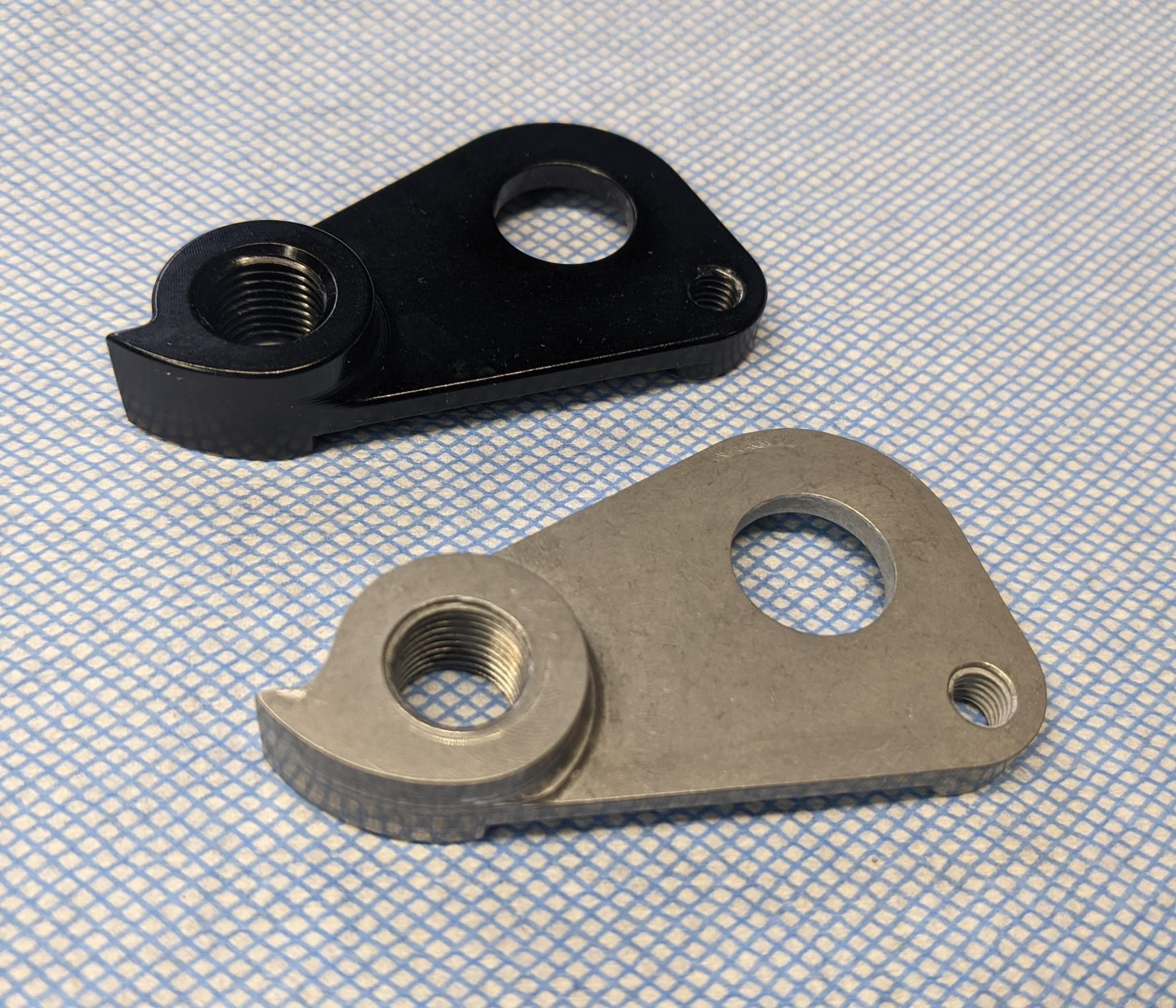

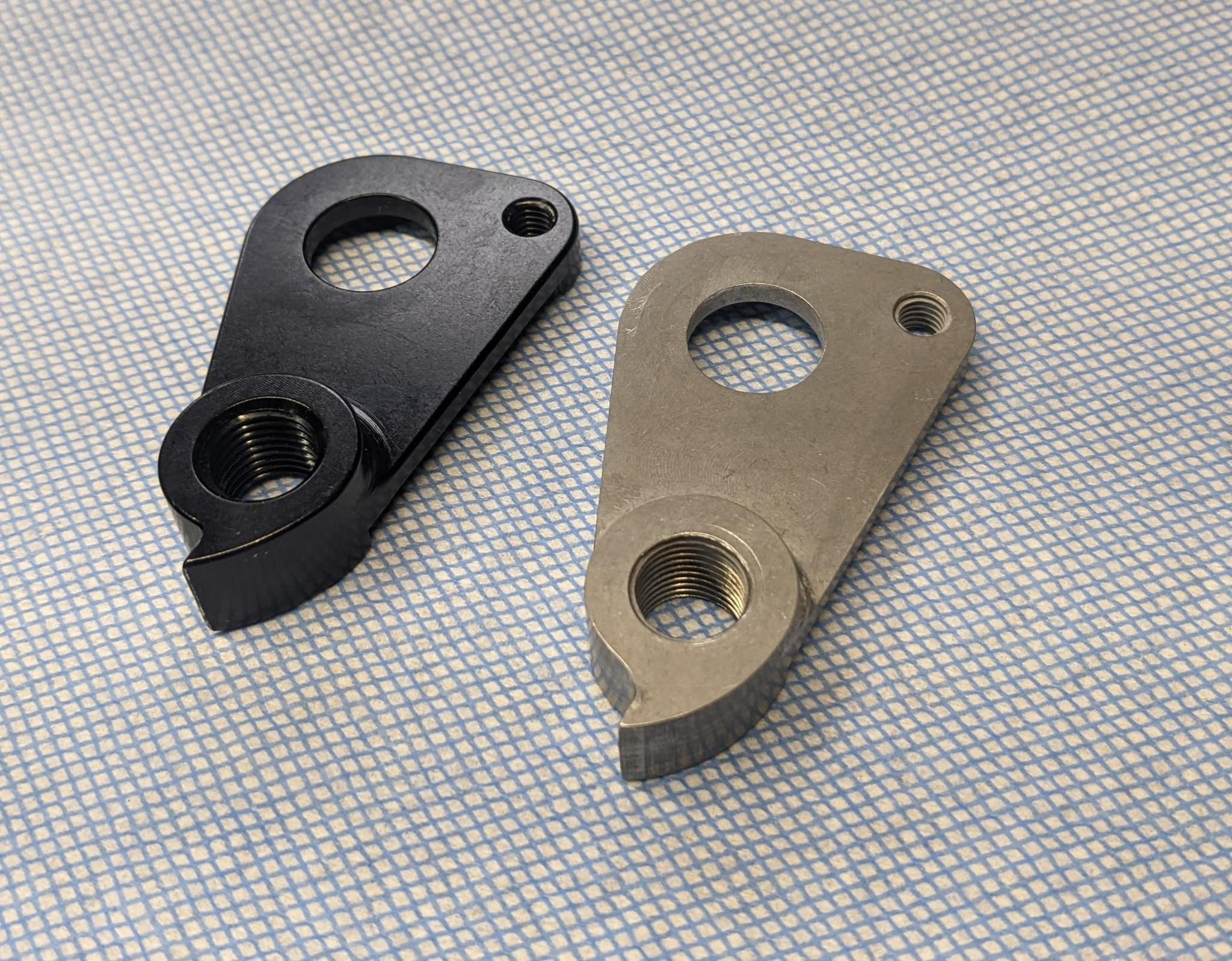

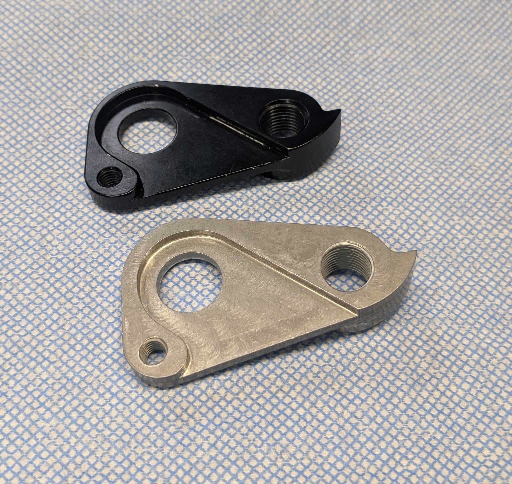

Dave has also been able to machine a derailleur hanger based on the one that came with his frame. It has not been tested yet, but it's only a matter of time. We're waiting on a few Shimano bits and pieces to make their way to the Great White North.
Fusion
Fusion
Fusion
Password: Eminent
Fusion
Fusion
Fusion
Password: Eminent

Also a reminder to the group that some small parts have been figured out. Drive derailleur hangers have been made and are ready for anodizing. Search the Pinbike Buy/Sell page for "Eminent parts" or hit up that PB ad if you need 'em, : 2023 Eminent Drive and Haste Parts For Sale
David (the guy who made the hangers) is drawing up every machinable part from the Drive, which is good if you ever need a hanger, spare axle, idler pulley, link or shock bolts, etc etc. He'll update his ad as he produces new parts.
