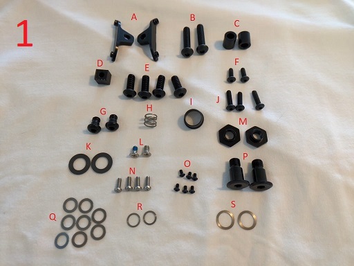

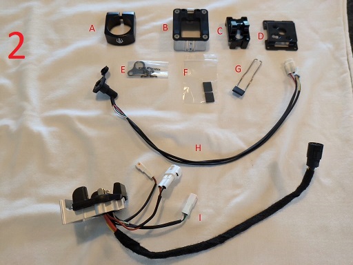

No linkage at all which would immediately put me in the "machining" category. I have inquired since the auction description did say it came with a linkage. Here are the detailed parts I got labelled for reference.

My Drive did come with an axle and derailleur hanger attached. I went back to eminent and got my LT link. Just ordered some new shock mount hardware and I think I have the frame sorted. Now working on the battery install. The side nearest the motor seems simple enough not sure on the upper battery mount near the headtube.
dreys
Jan 20, 2024
17
8
California
Yeah, that's the tricky part.
First picture - pieces A and H go there for sure
Second picture - pieces B and D and G align as well
