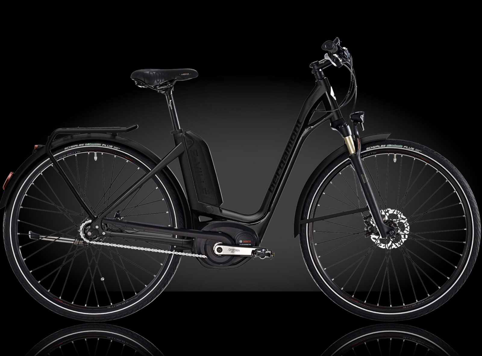

Well part of it relates to the fact you are riding a bike designed for performance mountain biking, and as such it is specified accordingly, with the components being designed for a mix of durability and weight saving. The bike is designed to be optimised for riding fast and well off-road, not cranking out the miles on road, so many parts will prioritise over durability in favour of performance gain on the trails.
Bikes do exist that are designed to be as maintenance free as possible, but they are not high end mountain bikes.
My father in law does about 5 k a year on his EBIKE, he rides it to the office and to pop around town. He has a Bergamont E-Ville, which runs the Bosch systems paired with an Alfine DI2 rear hub gear set up. The bike is designed for commuting and touring, it probably weighs a few kilos more than the Levo, but everything on it is designed for minimal maintenance, comfort and durability.
All he has had to change in that time are the tires, brake pads, and the chain and rear sprocket.
As someone who used to commute by bike for 10 plus years, I can tell you that (again ignoring the motor) for that milage you have done incredibly well to only have to replace the parts you have listed, to the extent that I would want a mechanic checking over my bike if that's all I had replaced over hat milage and I wasn't mechanically confident!
