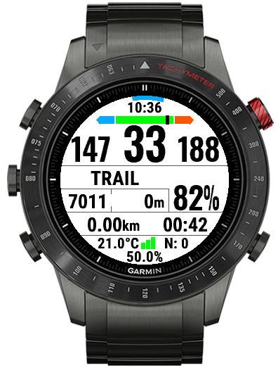

Lots of new compatible watches with new 2.1.0 update of Ebike Field - Nerd Style, enjoy!

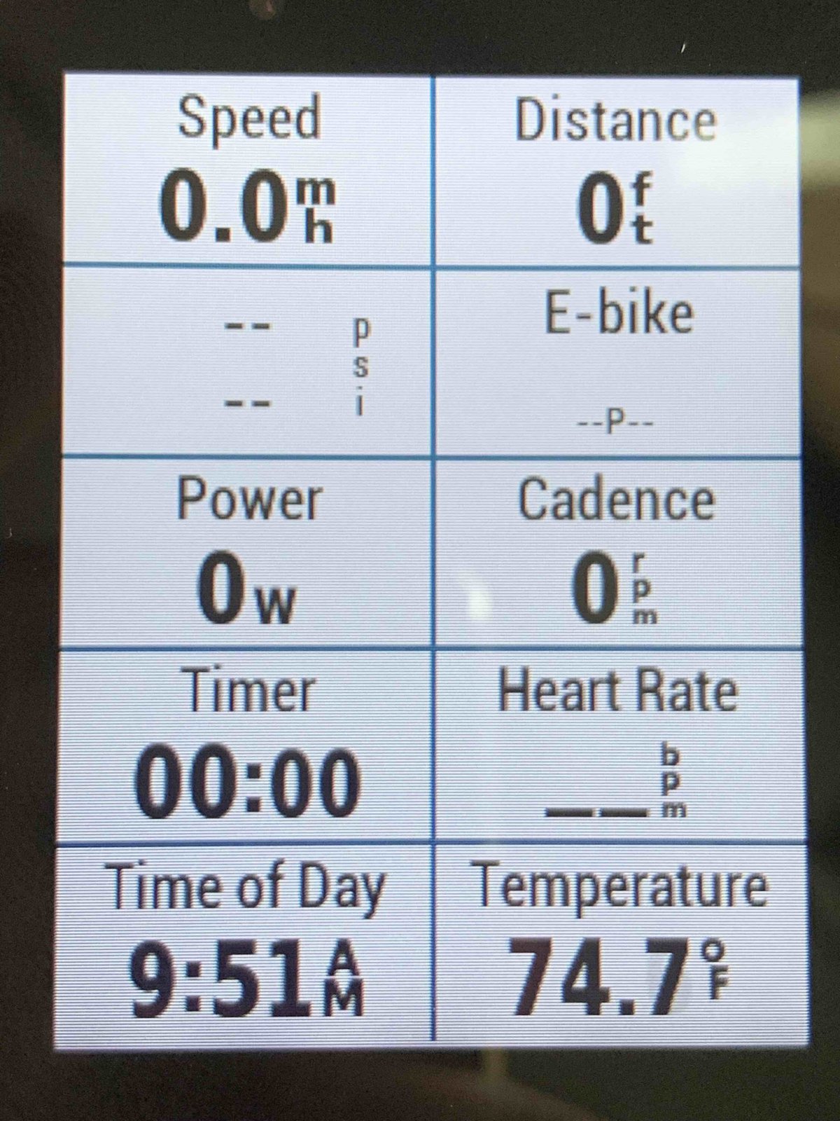

Thank you for the update! I have this working well on my 530, One request if possible is to increase the text size when displaying both fields in the small box. On my 520 it was nice and readable on the 530 the percentage and mode are tiny.

oripaamoni
Jan 31, 2019
17
10
San Diego
@oripaamoni Hi, Ebike Field is designed to be universal in the way, that Garmin system itself handle size of the fonts based on the used layout and whether it is plain number or text. For this reason, I can't affect size by myself. Please play with the configuration options, there are variants how to show both info as one single number for this reason. Or you can also complain to Garmin that they control size of the fonts wrong. :-o Can you send me picture to PM to see how small it is please? Thanks
wasn't able to get it connect today, but you can still tell by the size of the "--P--"
JanCapek
Aug 16, 2018
157
139
Czech Republic
@oripaamoni Uf, that is really tiny - well done Garmin. :-o This is clearly bug on their side. I will try to report them this issue, thanks for the image. Before it is fixed, please try to choose in the setting variant with number only, it should be bigger once it will load the data. You can change this settings while datafield is loaded, so you will immediately see the change.
JanCapek
Aug 16, 2018
157
139
Czech Republic
@oripaamoni Can you please send me images also when it is connected to the bike with value variants:
- Battery level + assist mode description
- Battery level + assist mode as one number (biggest font)
It will help me to report issue to Garmin.
Also please try layout variant, when Ebike Field have full width of screen to see if it will be better on edge 530. Thanks
