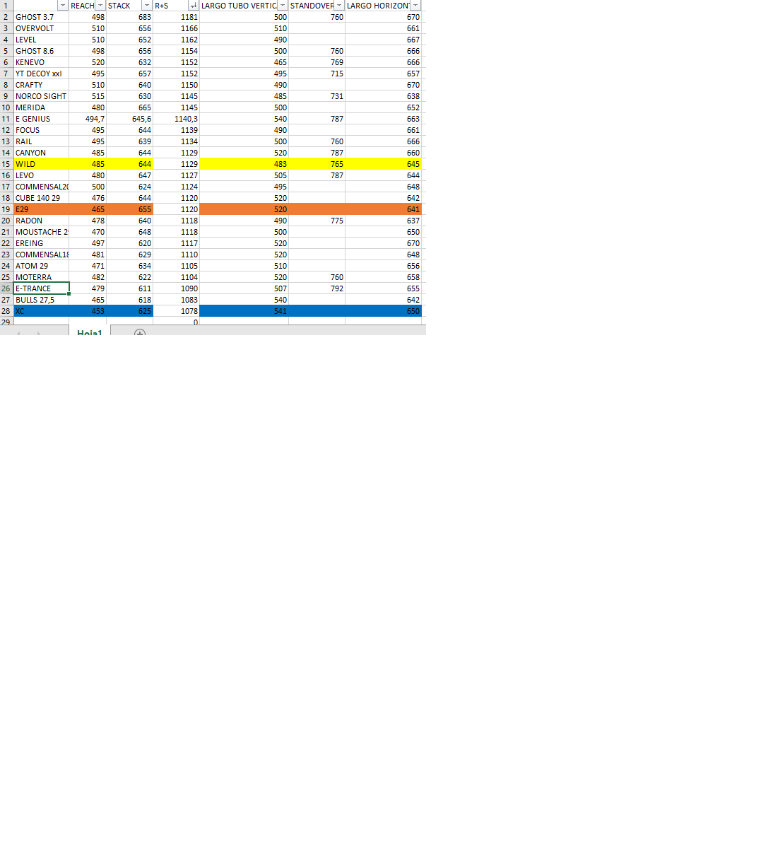

A Table with reach +stack of 25 bikes:
Wish I had a clue what any of this meant! ?. I’m 6ft with a large Wild and it’s perfect for me
