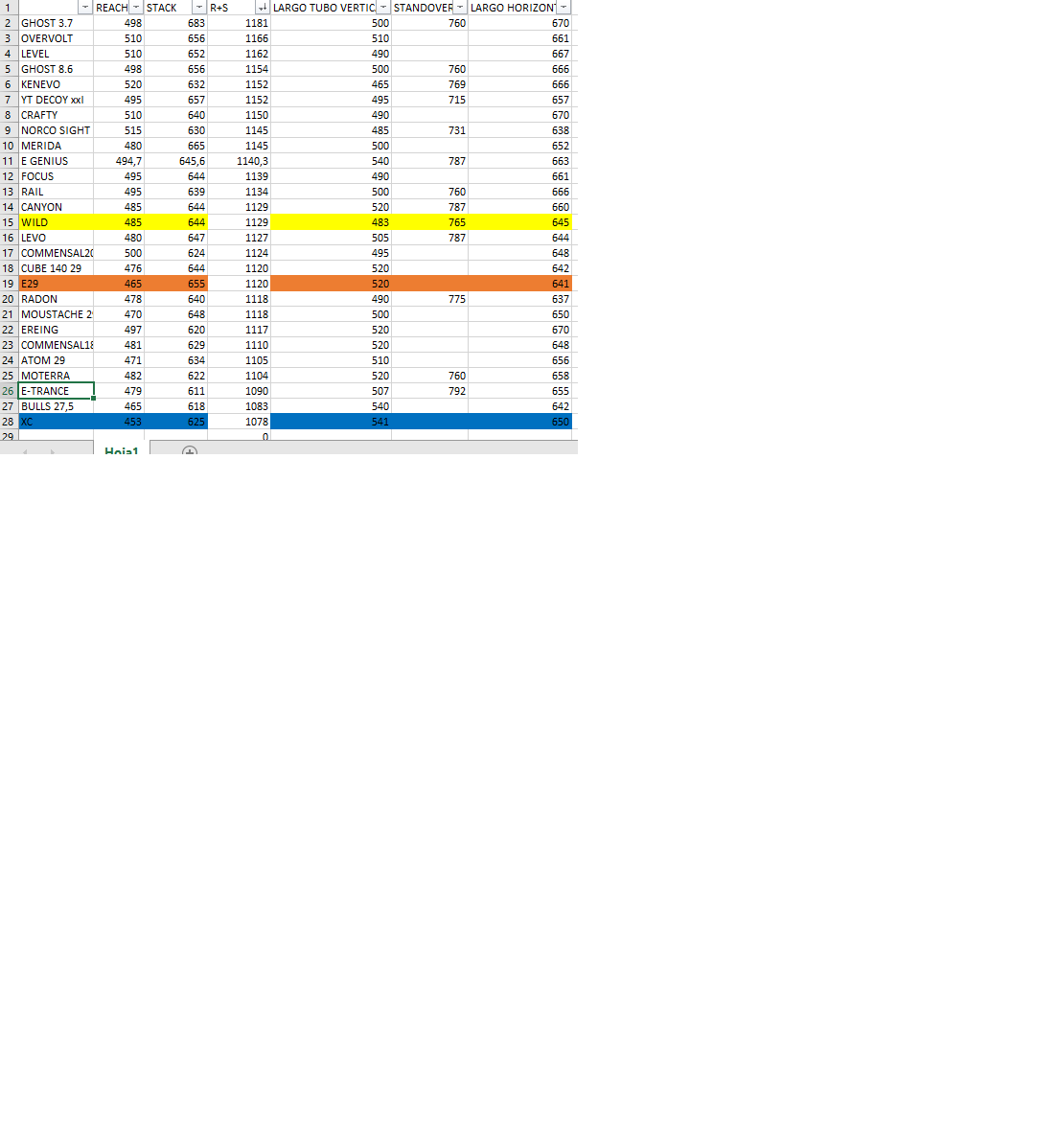

A Table with reach +stack of 25 bikes:
Eddy Current
Oct 20, 2019
578
315
NORTH Spain
Focus Jam2 with Bosch 445
Trek Rail 450
Cannondale Moterra 448
Intense Tazer 450
Mondraker Crafty 470
All In medium Size. they are longer than many on L size, don’t know on the larger sizes how do they scale.
