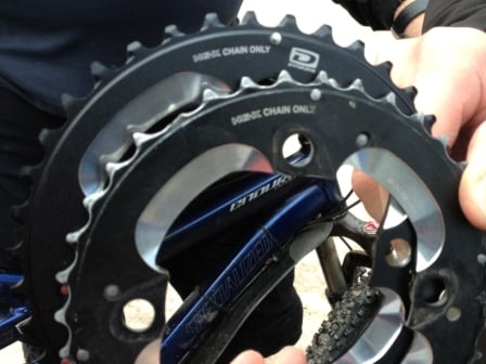

Sadly, I too have had similar happen to me. My excuse is that these events were many years ago!
The bolt securing the mech to the hanger was loose and I didn't even think that was a "thing", so whilst out riding, I kept trying to adjust the mech. You can imagine how that went! :(
My 8-year old grandson was on his first mtb skills course and I was just following along. My shifting started to be all over the place. As before I started to adjust my shifting. I'd fix it and then it would go off again. But the culprit was a loose clamp on the Shimano left side crank arm. The whole axle, ring, and drive side crank assembly was slowly moving outwards. Eventually, my problem-solving brain took precedence over my "need to keep up with grandson" brain and I fixed it quickly. God knows what the instructor thought I was up to!
On my first mtb, chainsuck suddenly became a problem. At the time, I didn't know it was called chainsuck, nor what was causing it! on my first trip into the Peak District (what passes for mountainous terrain in the UK), I would have bought magic beads from an oily salesman to have fixed it there and then! :eek: I don't think I slowed down my riding buddies, well not by much anyway. :giggle:
I had put a new chain on my bike, spun it round and cycled through the gears on the bike stand. Perfect, good to go! The next day, the chain was slipping all over the place with loud clunks. It was almost unrideable. Fortunately, one of my riding buddies diagnosed a new chain on old gears (yes, I know...) and there was a bike shop nearby! See the pic below for just how worn that ring was. For the avoidance of doubt, the new one is at the back! He had a workshop in the boot of his car (!) and we fixed it very quickly. I must have paid a 50% premium for that chainring, but they had one in stock and I was just too glad to care!
