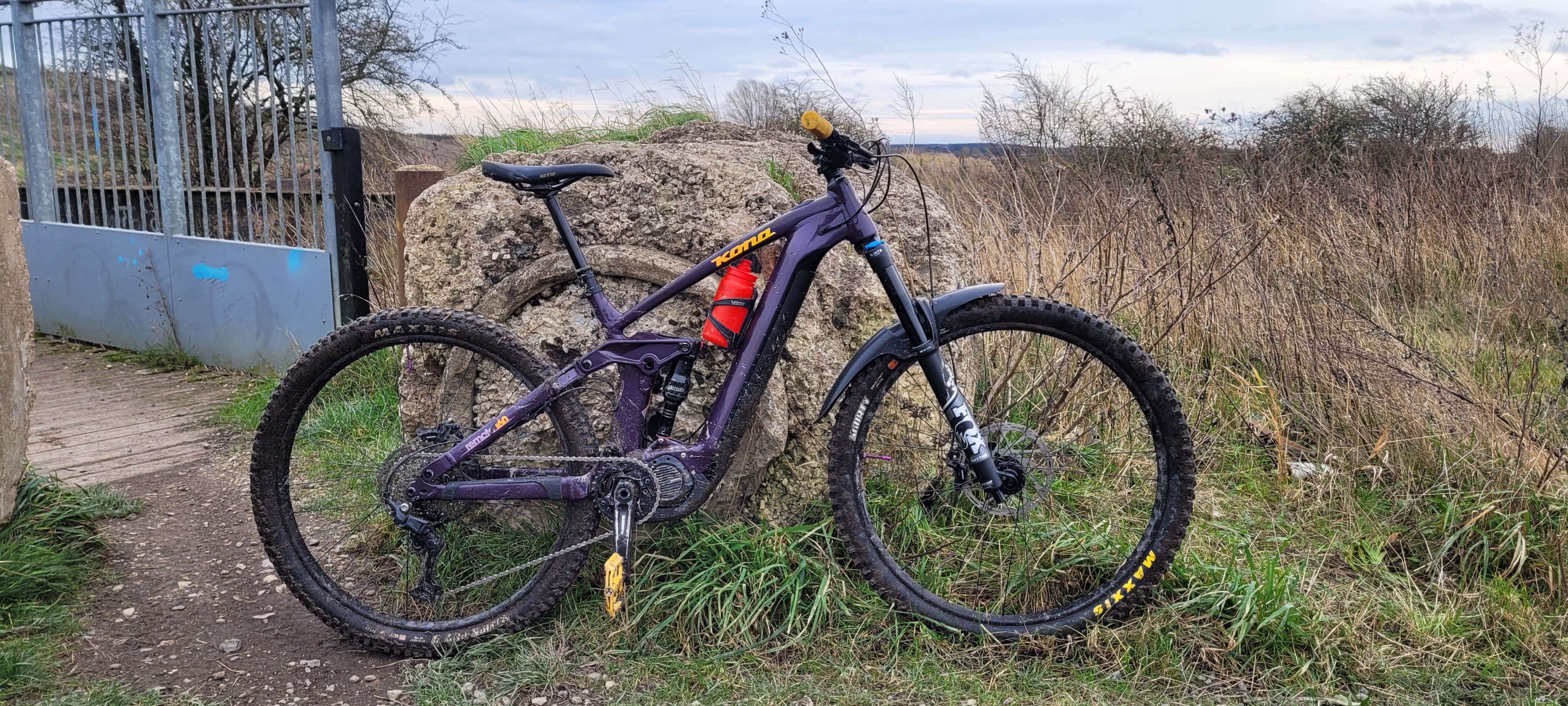

My CANYON Neuron ON 5 2019 cost new 2800€ I improved it with 38T chainring and 11-46 cassette, Yaris150mm 400€, DT SWISS H1900 wheels 400€, 203 discs and 4 Piston calipers 200€, BT-E8016 630 Wh 570€, two DU-E8000 one used 280€ and another new 600€. TOTAL 5250€. I've been here for 5 years and 44,000 km. Old curmudgeon at 63 years old I think I will keep it and maybe buy another broken down and cheap 2019 Neuron/Spectral ON for spare parts. It is a 22 kg ebike with great addictive potential😉💪
