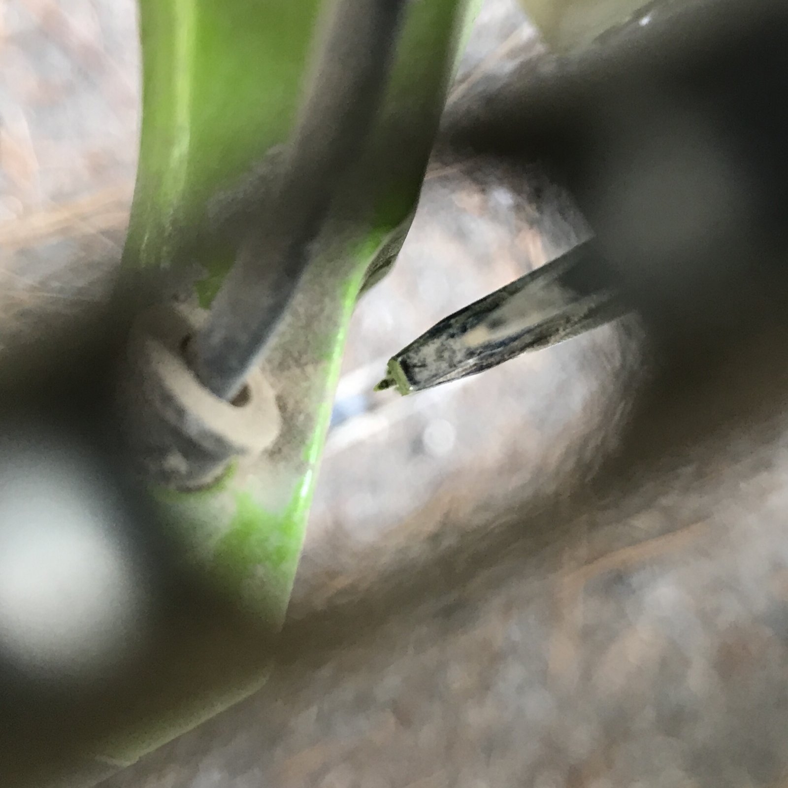

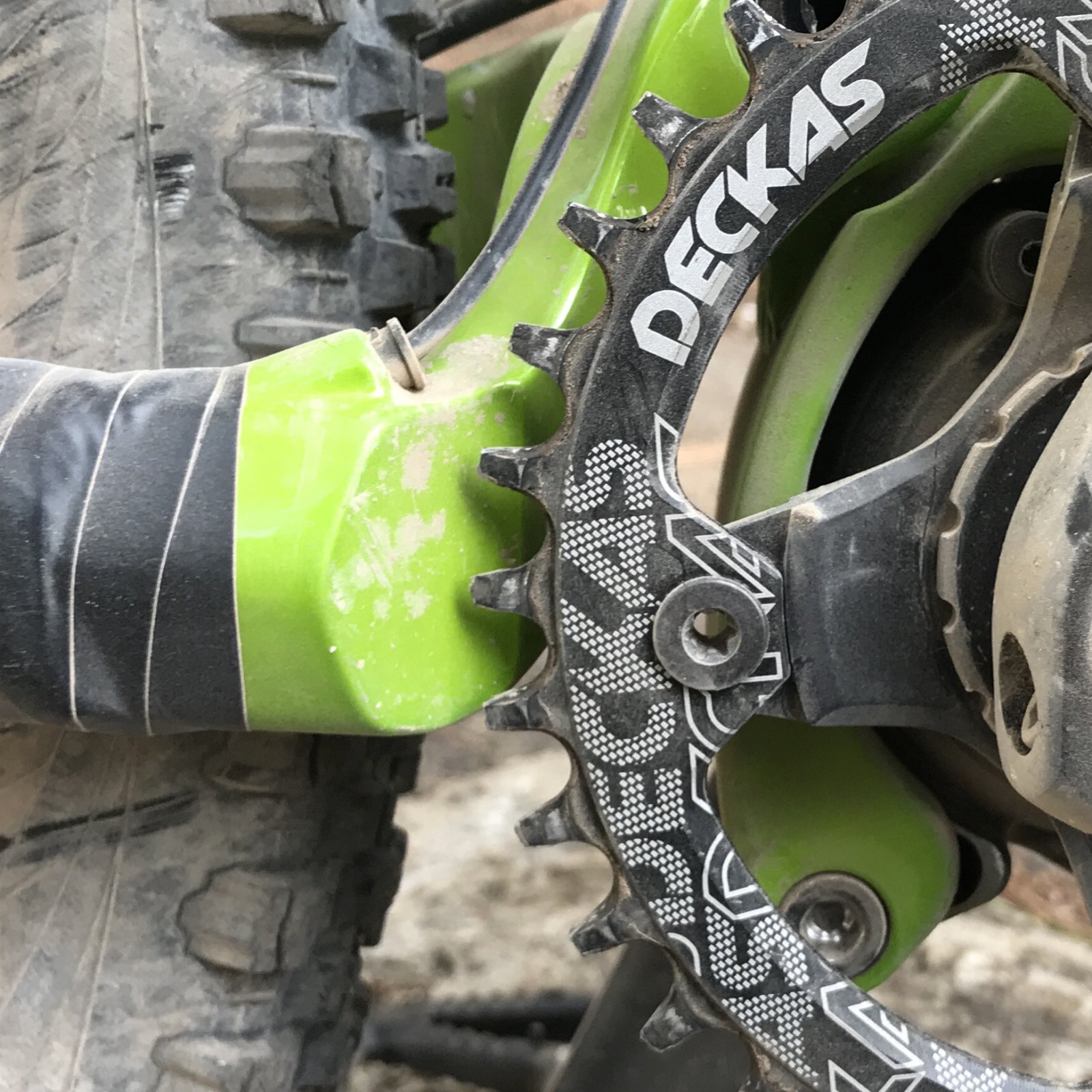

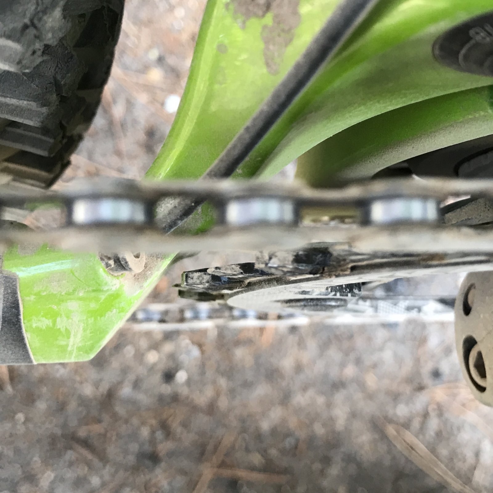

igoriokas
Jul 24, 2019
Pizdec00
The 36t chainring fits Merida e160 very well.
There is about 2mm of clearance.
I used Deckas 36t chainring from AliExpress.
It works very well as new, will see about the durability in the longterm.
