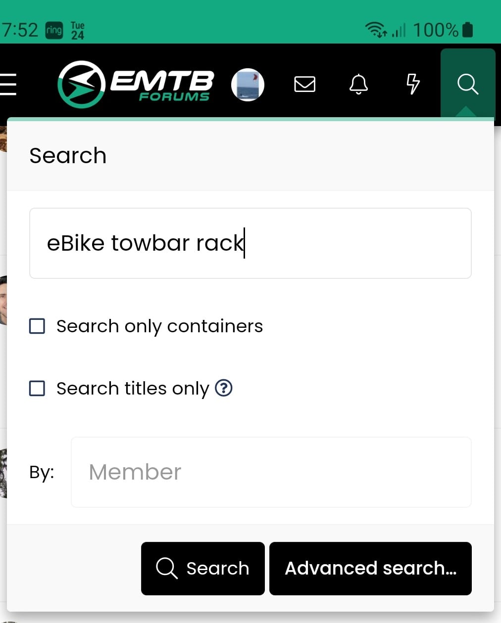

This.

Yeh I can search for bike racks, Have done that. my question was more to my issue that I don't have enough room between the 2 bikes and specifically if anyone is using a bike rack with 2 large E-Bikes and found a rack that has enough space.
Most of the racks I can find may say E-Bike but seems bike racks haven't caught up with E-Bikes getting larger, their all built for smaller E-Bikes
and I posted in the AU forum area as I need a rack available to buy in AU, not racks people are posting about that we can't get here.

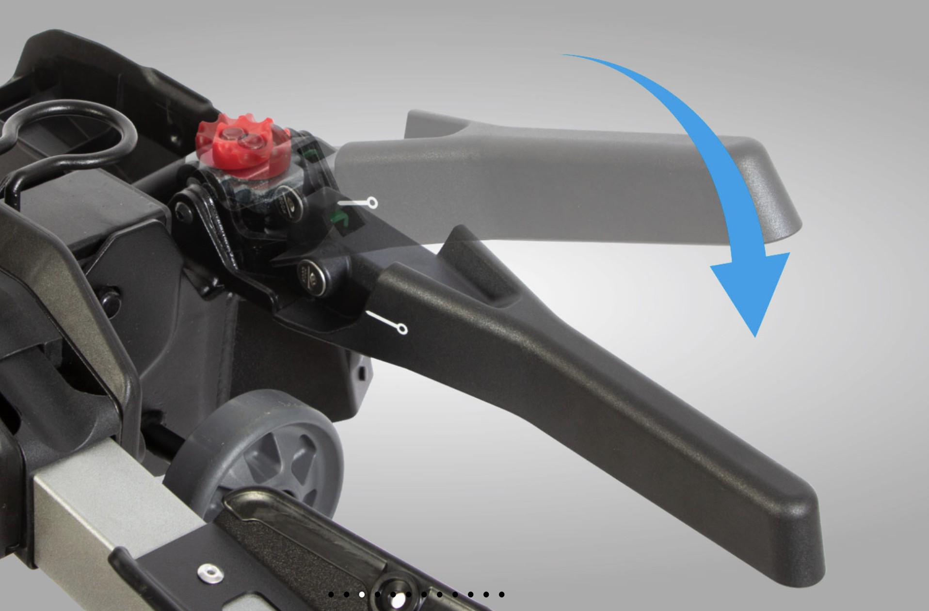

I looked at the GripSport looked like a good design. Ended up going for the Rack E-Scorpion 2 as that shows a 300mm space between each bikes wheel centres. I contacted Gripsport and they said their distance between bikes is 260mm
Currently the carrier we have is 119mm and not enough.
I opted for the E-Scorpion 2 as I've used their single bike carrier and like it. The only thing I don't like is their 2 part attachment method, screw the wheel and then turn the bolt handle a few times.
I see on a newer E-Scorpion 2XL uses a one action clamp handle more like the Thule carriers which I really prefer, a much nicer simpler attachment method.
E-Scorpion 2XL not available in AU
