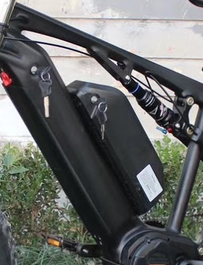

Got a photo of this setup? Keen to see how the spare batteries are connected to the bike while they are in your backpack.
Get one of these.
